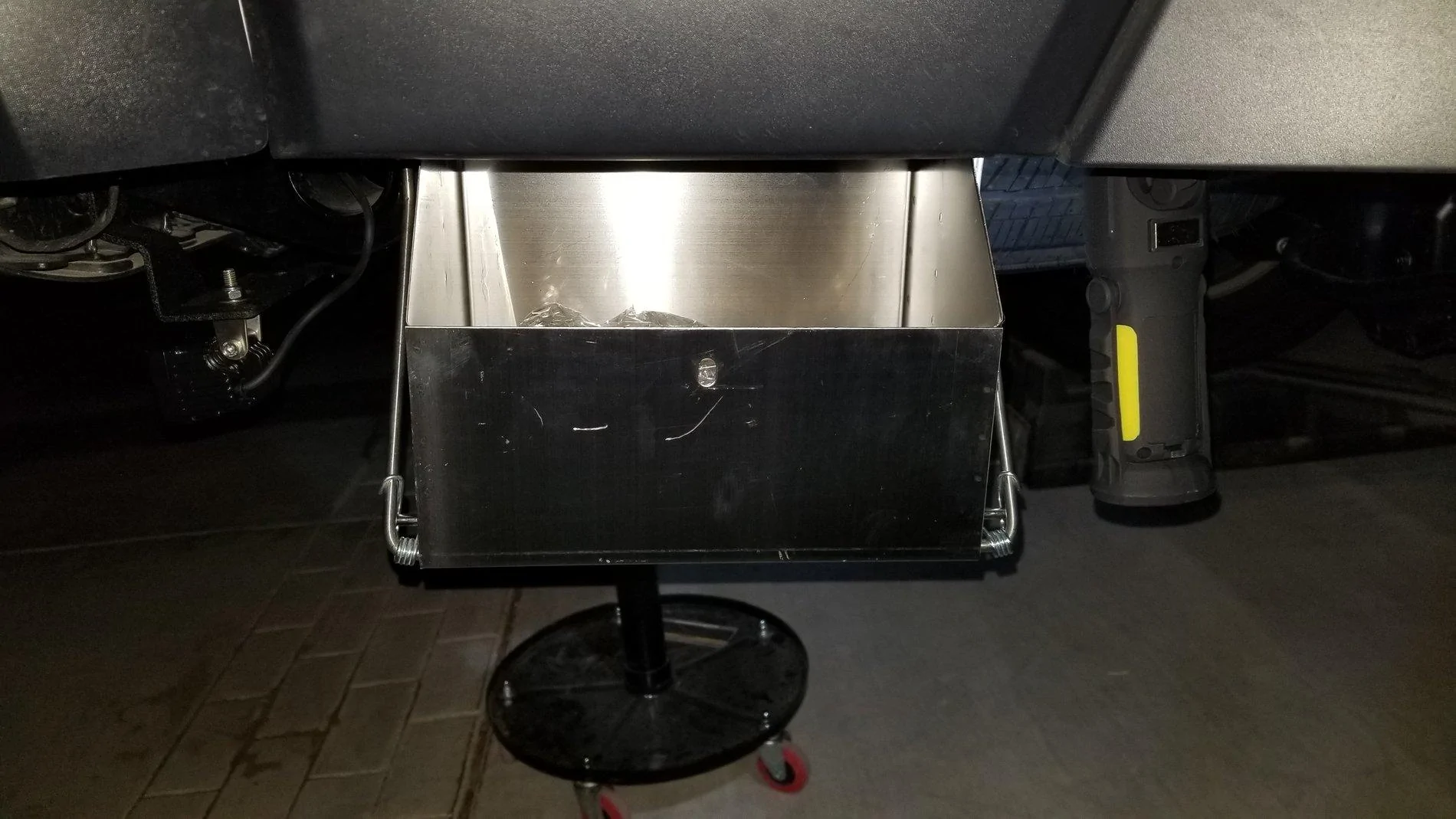

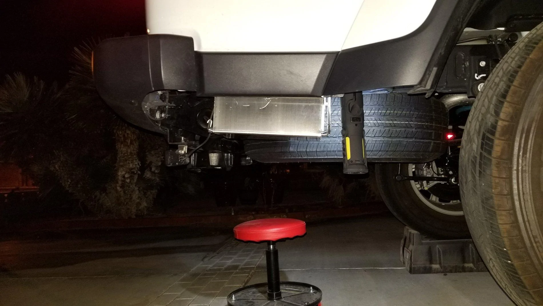

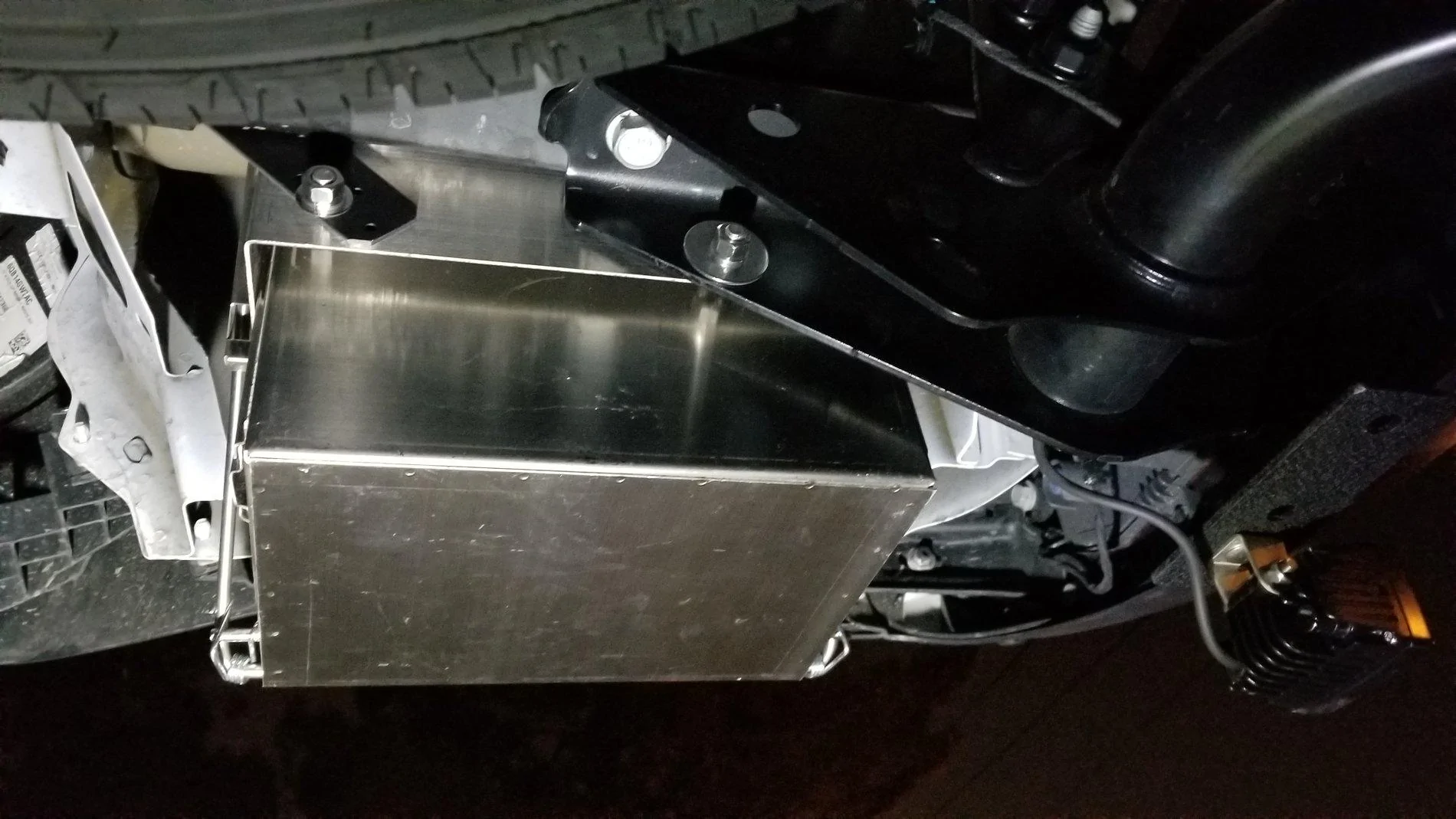

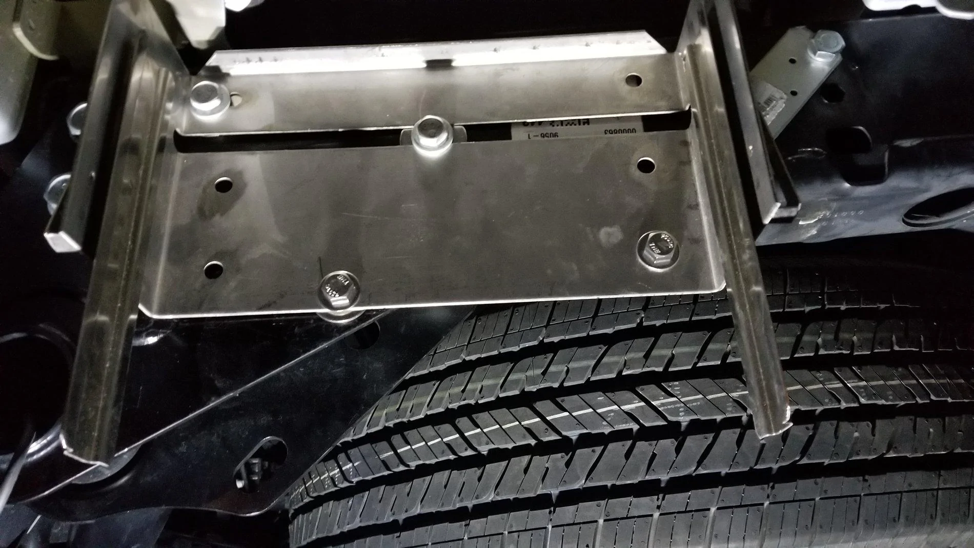

photo please, would like to see that set up
Here's a couple pictures from installing the battery box. I'm waiting for the warmer weather to come back so I can finish connecting all the wiring that's been run.
Stainless?
Are you at all concerned about the fumes generated by discharge and charge? Depending on the battery and battery technology, the amount of discharge, etc............ some steel things in my shop - Rusted in a year.
I built a test bench for testing alternators I restore for the hobby and it's something I have to keep up with - keeping the area where I have the battery clean otherwise things rust from the fumes generated.
damn @Mr._Bill you make some damn nice battery boxes!
EDIT: DAMN @Mr._Bill you PURCHASE some damn nice battery boxes. lol That thing does look sweet though!

Stainless?
It was the only box I could find that would fit in the space available. It has an open top, so I'm not too worried about fumes. This is the battery I put in it. https://www.samsclub.com/p/duracell...ize-sl34magm/prod3590225?xid=plp_product_1_18
Being an open top is why I asked about the fumes - they rust things - like frame and suspension...........
Charging and discharging a battery puts stuff in the air that will rust that area if not kept washed down or otherwise protected.
RV and boat batteries are typically in "plastic" cases, with covers.
I made my battery testing and charging rack out of wood with several coats of bar top poly to avoid the fumes from charging of batteries and the load testing them eating at metal stuff.
I guess my concern was with a battery back there generating the acid fumes getting to the frame and suspension parts eventually. Rust. Not explosion.
If I get a chance later I'll take some pics showing why I get concerned about such things.
Maybe it's a non-issue - could be in this case it's not a problem.
NICE battery box, by the way.
