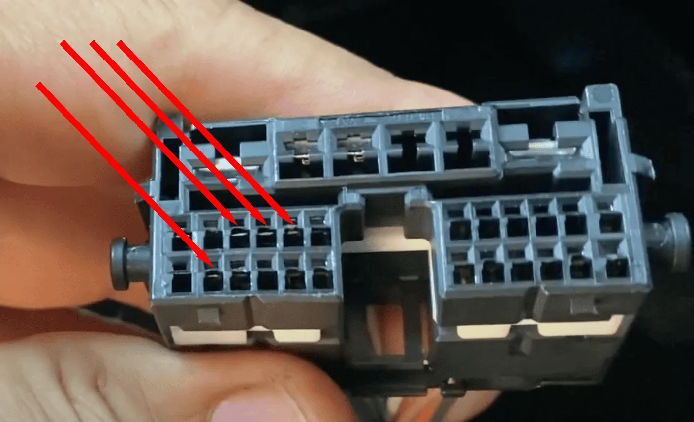

UPDATE: So the jeep dealer had my truck for 5 DAYS and they gave up on it. Dropped it off on a Monday, called me Wednesday saying they fixed it. I showed up and paid (not covered by warranty) but I wanted them to unplug and plug the connector in front of me a few times before me driving home. Sure enough they unplugged it once and it was broken again. I told them to keep the keys and do it right. So Friday rolls around and they just give up on it saying they will give me my money back, order a new set of pins and call me in 7-12 days to reschedule an appointment to see if that will fix the issue. I get home pissed and look at it myself. Its a little hard to see but there is a tiny tiny horizontal piece of plastic that divides the slots the pins go into exactly under the red arrow tip. So I took a needle and straitened them out and removed so burred plastic that was damaged by the pins pushing on that part (photo is the male plug coming off the passenger door on a 2020 Jeep JT) Then I took the smallest allen key I have and straightened the pins on the female side and it fixed the problem. I plugged and unplugged it 6 times to verify the fix and its all good. Im really sick of the experiences I've had with Jeep service. Shouldn't be like pulling teeth to get someone to take their time and care for something like it was theirs.
