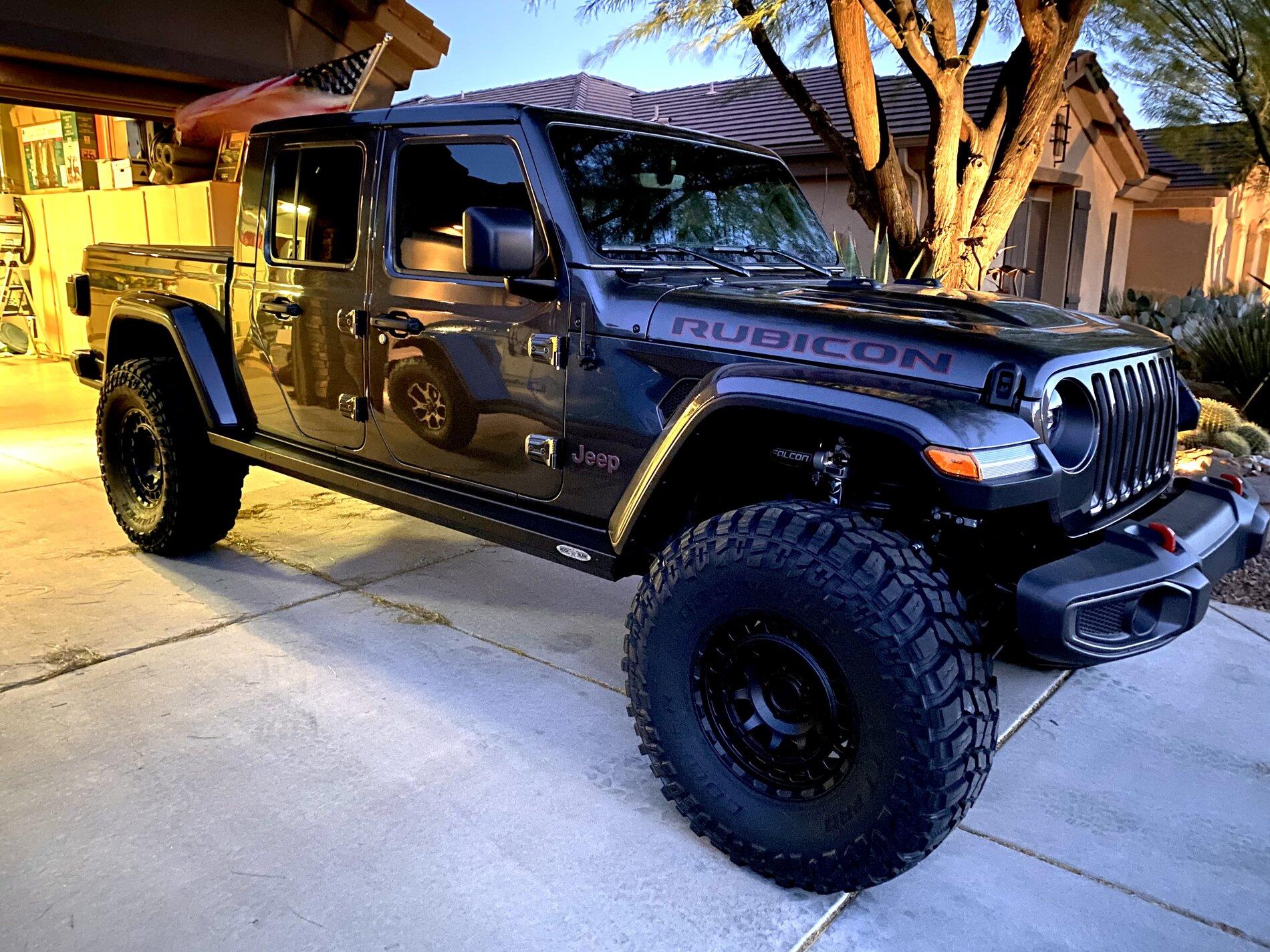

Thanks. Did you do the install or have them done? Just curious how complicated the wiring is and if it is clear where you tap in.
I did not on these. My understanding is that wiring isnā€™t overly complicated depending on your skill level. More effort on the actual rails as they require 2 peeps to install. They are built like a tank.
As said. I wanted both protection and folding step ability All in one. RSE seems to be the only option at this point that I am aware of.
Pic attached with them installed.

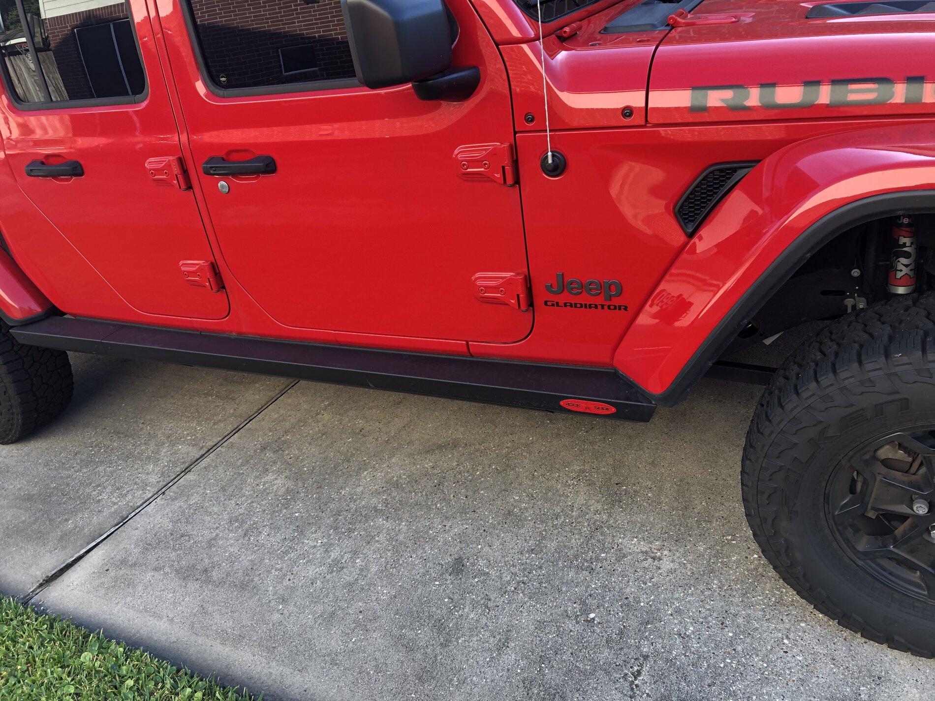

I have the RSE and did the install myself, well, with my brotherā€™s help. The extra pair of hands are very helpful with things that are a bit unwieldy. I have managed such things alone in the past but it took me a lot longer, ensuring I didnā€™t ding the truck or the new accessory. The extra hands were especially useful on mine as one of the Jeepā€™s pinch weld bolt holes needed drilling out. The layers of sheet metal were apparently predrilled then put together. One layer was misaligned enough that the bolt on the slider wouldnā€™t go in. Trying to find the misalignment would have been a real pain on my own.
I love mine. The step is narrow so if you are doing steps for someone more wobbly on their feet, AMP is the way to go giving better foot purchase. Iā€™m not the steadiest guy anymore but I have no issues stepping in hands-free ā€˜cuz I have a big drink in one hand and food in the other.
Both are good products so just go with which fills your need, wider/easier step or beefier protectio. Another benefit Iā€™m liking a lot is the extra paint protection. The sides of the jeep donā€™t catch near as much road debris, mud. And they serve as a great place to stand when washing the roof šŸ˜Ž
Jeep Gladiator Power Steps 83807ABE-B00D-4744-B071-FDD0A1C62295
