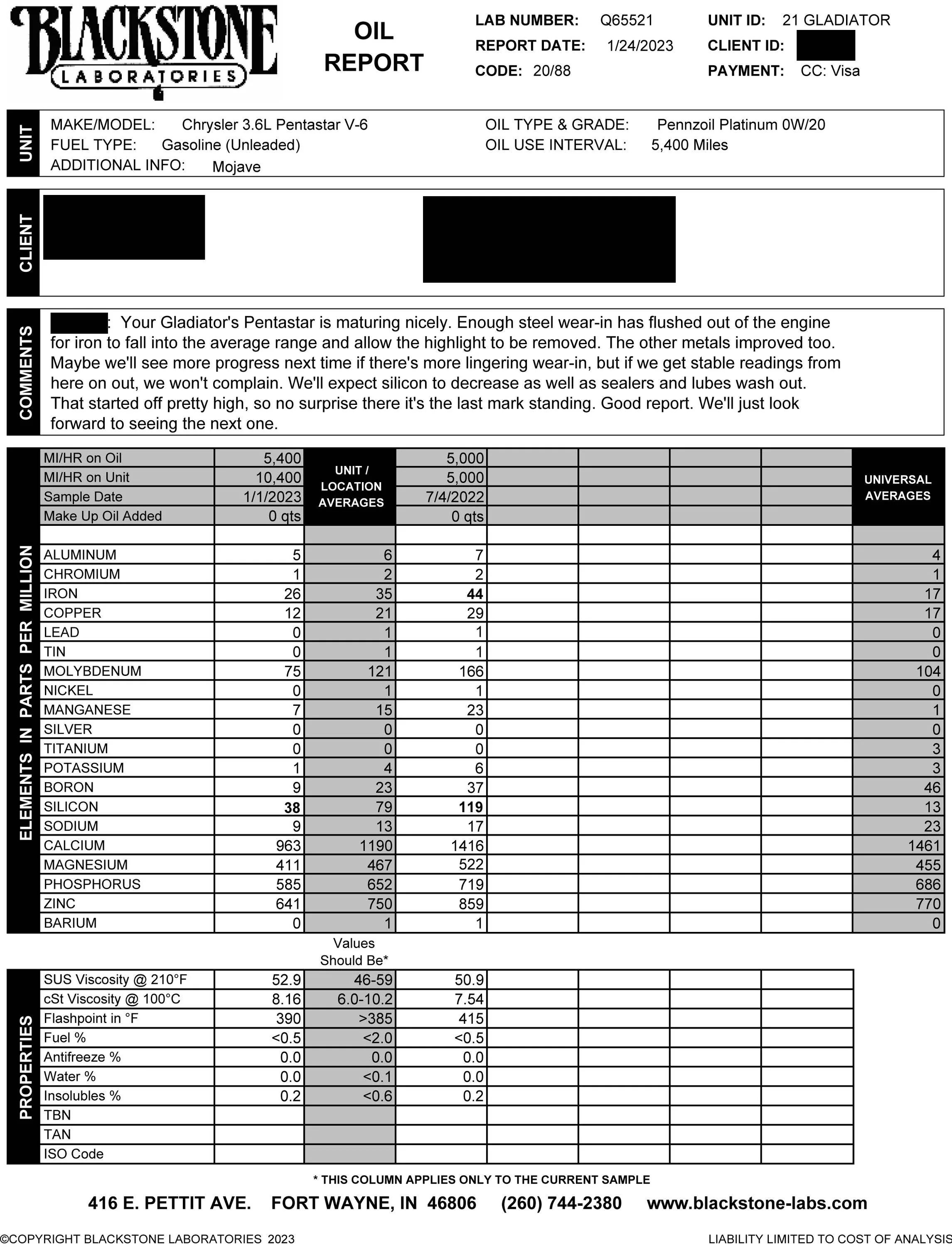

It's not infallible, and you can't take one to your service manager and demand something be done, but I track my engine's health by submitting oil samples for analysis every time I do an oil change (5000) miles.
If an adverse amount of certain metals begin to appear in the reports then I'll have some idea of where we're headed and can take steps then.
What steps? I don't know yet.
I don't know if I'd be inclined to repair the issues or to trade the vehicle off and let it possibly disappoint someone else. I don't know.
But for now, 2 oil changes in, the engine appears to be wearing normally with no indications of impending doom.

Jeep Gladiator Powertrain Limited Warranty Gas Engine – 5 years/60,000 miles 10000 Oil Report
One of the smarter posts on the topic.
