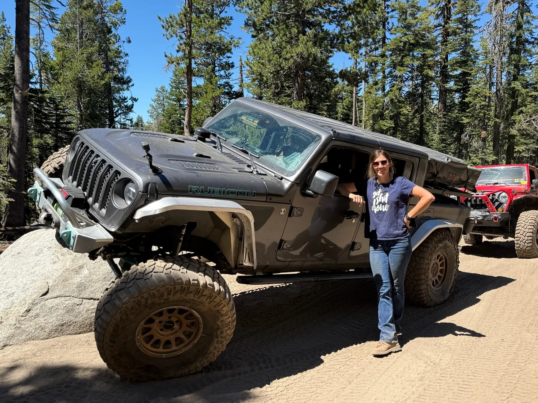

The first year of this build, was done out of my apartment. Fortunately, I now have a garage and things are much easier to work on. I'm looking forward to tackling more big projects! Hopefully some of the lessons learned will help others, this community has certainly been super helpful to me so far.
The truck as of today:
Jeep Gladiator Practical Truck for the Over Prepared Woman IMG_1606

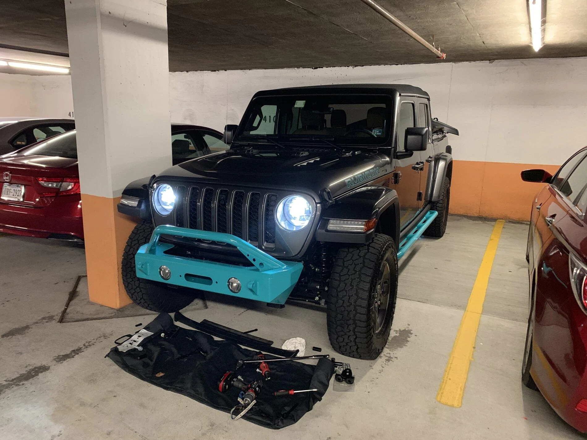

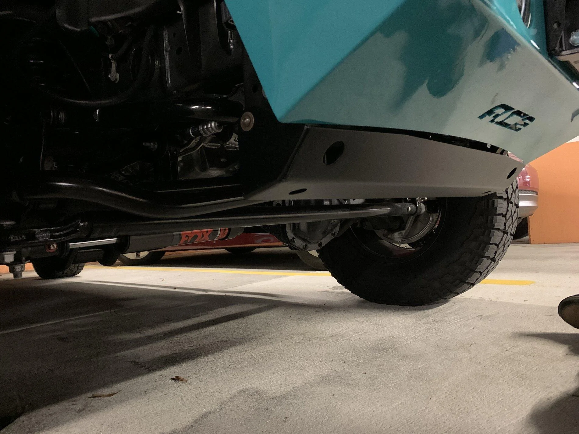

2: The Ace bumper doesn’t cover the sway bar disconnect.
I find that the rampage skid plate will work with the Ace bumper with only a little grinding.
Jeep Gladiator Practical Truck for the Over Prepared Woman C07E75E2-FBA1-45CE-A6FB-ED9F57F5895C
3: The Ace bumper didn’t have room for the factory LED fog lights and the Warn Xeon winch.
To fix this, I cut the plastic plug shaft off the LEDs and soldered the wiring harness to it. Then heat shrunk covered it, added dielectric grease and put wiring harness tape over it. This held well until I replaced it. Even survived some mud baths and rainstorms without shorting.

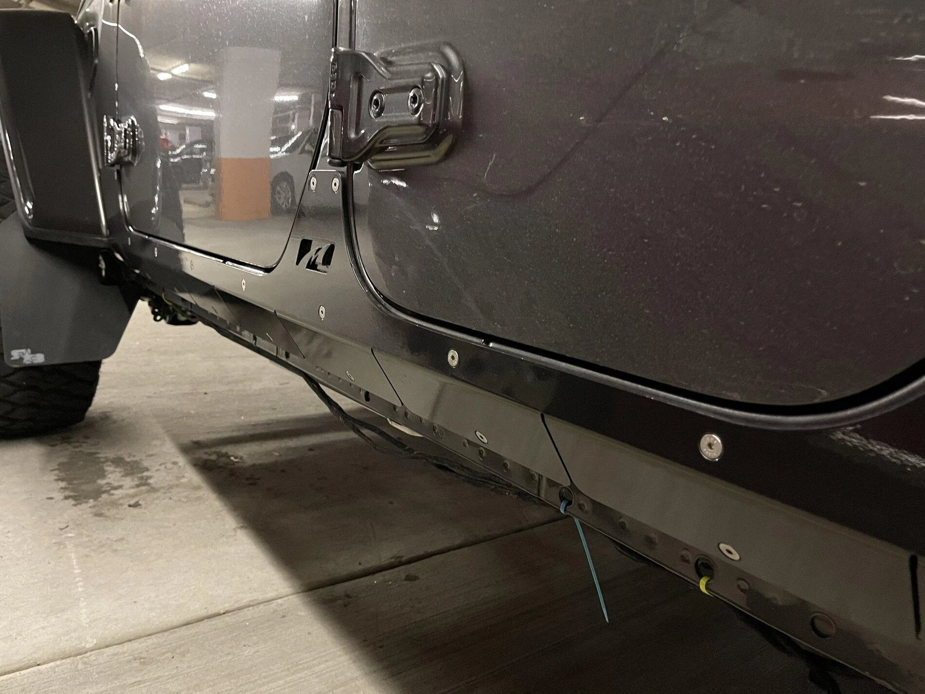

Nicely done Elise!
How about a side photo showing the Motobilt and Artec armor?
Kindafearless
Kindafearless
Elise
Aug 19, 2019
435
1,086
2020 Jeep Gladiator Rublicon
Enginerd

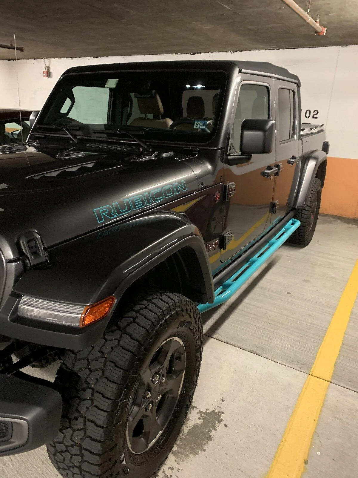

Here is a picture of the Motobilt rocker panels. They are painted the same color as the Jeep to blend in.
I’ll take a picture of the skid plates next time I roll under the truck.
