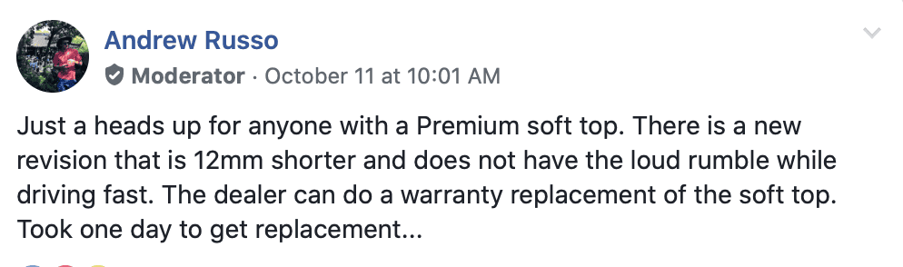

So, there is a post on another forum claiming that Jeep has fixed the Premium soft top from making a loud rumble in certain situation by making it 12 mm shorter. Has anyone else heard anything about this? It only happened to me once on a very windy day and only lasted a minute or two, but if I can get a new top and the issue never comes back that would be great. The OP claimed he received his new soft top within a day of ordering.

Here is the post.

Well, I guess no one else has heard of this. Very strange.

Iā€™ve got an appointment for service for Wednesday next week for this issue. I called jeep directly and opened the case for it. Iā€™ll let you know how it goes. Iā€™ve had that roaring noise issue around 10-12 times in the two and a half months Iā€™ve had the gladiator so I hope they can replace it without an issue

How did it go? My dealer refused to address without a service message form Jeep.

@JeepCares are you able to comment on this? I experience the loud rumbling associated with the early soft tops. Is there a fix for this? My dealer would not repair because there is no service order.

Hi Bryan,
There are no TSBs associated with this concern, but I can add this to your current case for your case manager to look into further.

They couldnā€™t replicate the problem. So They said thatā€™s thereā€™s nothing they can so and I Would have to wait til it happens again and make another appointment. It happened again this morning on my ride to work so i have to call and make another appointment. Itā€™s frustrating.

@JeepCares how many people need to complain about this before dealers start replacing them without multiple wasted trips to the dealer just for them to take the vehicle and say they drove it And cant find anything wrong due to them not being able to duplicate the issue.

I have this problem as well. Got the dreaded ā€œcanā€™t replicateā€ line from the dealer. Mine rumbles and vibrates so badly you canā€™t use the rear view mirror. I even provided a video to dealer and they so didnā€™t fix it. Frustrating.
