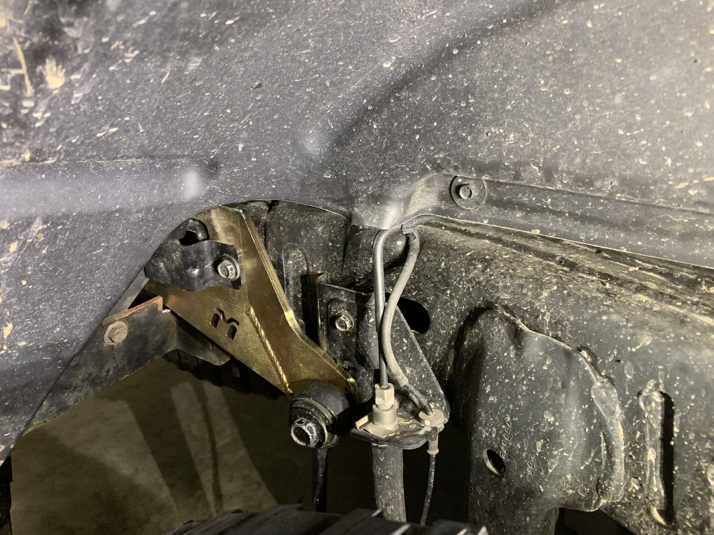

I think the suspension short bolt TSB he is referring to is the rear sway bar upper mount bolt. Do not know TSB, but thread about the reinforcing brace to prevent the bracket breaking references it and gives the part number for factory bolt, I ordered two for $7.00…..Jack
Jeep Gladiator Preventative work based on FCA Tech Service Bulletins (i.e. faulty electrical wire harnesses) 1A8943E6-6976-49E4-89D7-3F65299195E6
