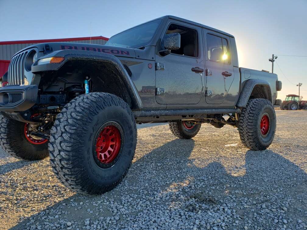

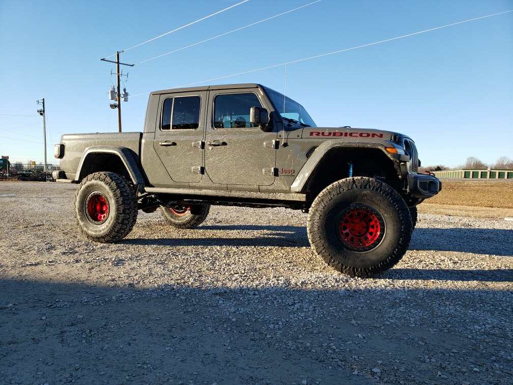

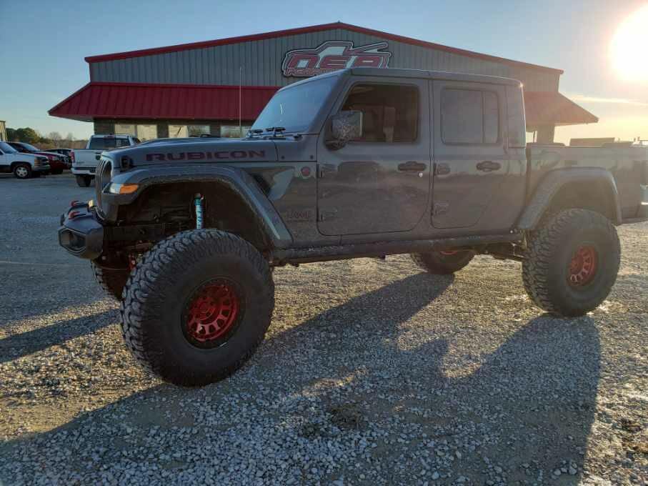

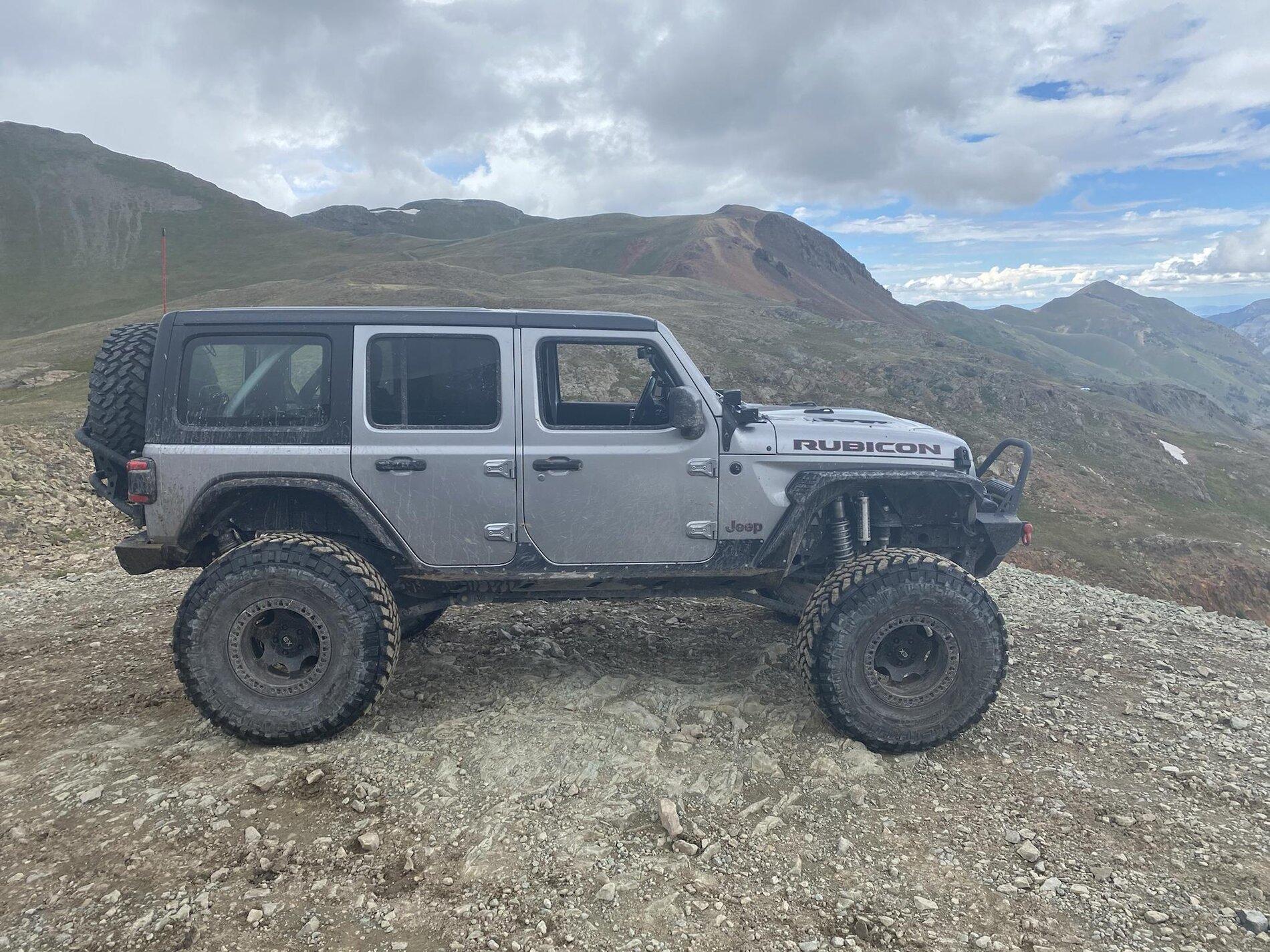

Just moved from my 2018 JLUR to a 2021 Jeep Gladiator, as you can see from the picture below the previous build was a pretty serious rock crawling rig. The aim for the Gladiator is to do something quite similar. This build is a work in progress but getting several big mods in phase 1 starting late next week.
Jeep Gladiator Project Riot 2.0 - EVO 6.5" lift on 40s Kp02tWv
Phase 1: Starting next week

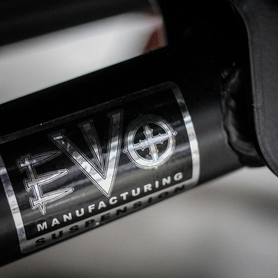

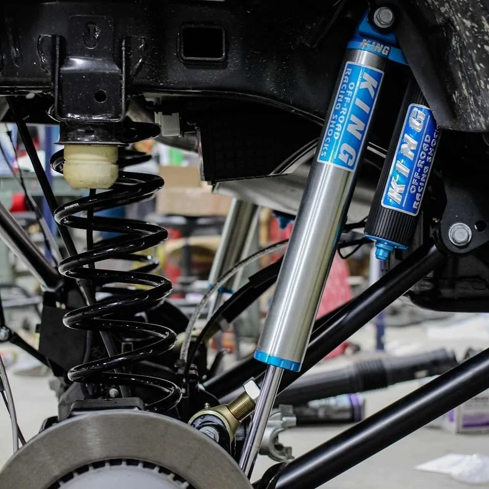

EVO Enforcer 6.5" Lift with King Shocks

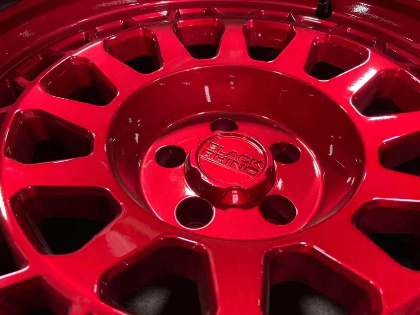

Candy Red with Black Ring Black Rhino Primm Beadlock 17x9 -38mm
40" Milestar Patagonia
5:13 Yukon Gears
Steersmarts Top Mount Drag Link
Motobilt Diff Covers
Quake LED Fender Chop Kit
American Adventure Labs front inner fenders
Tazer Mini and front mount camera
Custom made front and rear 1350 Driveshafts from a local shop
Phase 2: TBD
Beefing up the axles, one tons are not in the budget at this point, but I had good luck in my JLUR on 40's with reinforced axles.
Front Bumper: Leaning towards Artec Nighthawk bumper
Winch : Warn 10s
Rock Rails: either evo or motobilt
2018 JLUR:

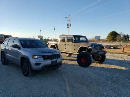

The sign in the background lol
Yeah I laugh every time I see it in town. Phase 1 is mostly complete but its been issue getting driveshafts delivered. Been stuck in shipping hell with the weather.
