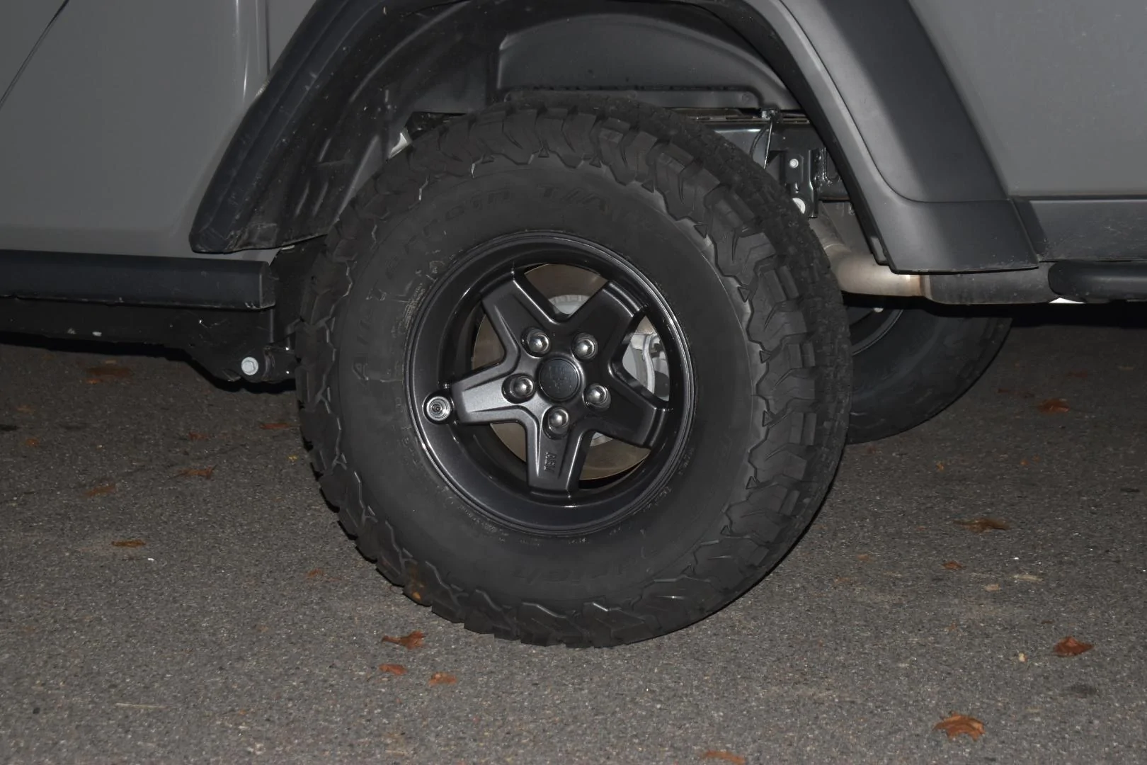

Add to that the benefit of better ride quality (in my case…at least). BFG A/T 315/70-17 (baby 35’s, lol) vs. Falken A/T 285/70-17…night and day difference. No more bone jarring bumps around town. Looks great, too.
Just looking forward to taking it off some sweet jumps.🤡 These really should have had an option for ~35’s as a factory option.
I went from the same Falkens to the same C rated K02s.
I ran my Falkens at a cold pressure of 34 psi and the Bridgestones at 32 psi. The ride is definitely better.
in my case, a gaser with 4.10s, the decrease in grunt off the line can definitely be felt.
All else being equal at a given RPM you will feel 6% less forward push for a given throttle setting.
Fuel economy seems to be largely unaffected. I'm sure that it has decreased. But the decrease is small enough that its lost in all the other variability around my fuel economy numbers for a given tank.
I drive easy and late have been getting 17.5 in a relatively urban environment.
On highway road trips I also get about 17.5
Once I am at my place in NH, where I'm driving state roads with almost no stopping and speeds of around 50 mph, I'm in the 19 mpg range.

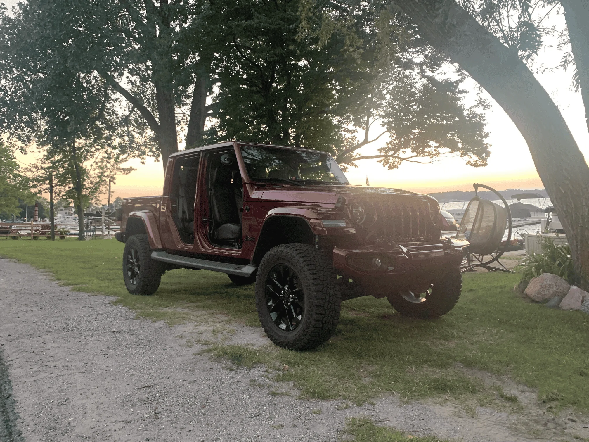

So, I recently got a High Altitude overland diesel. I like the wheels, want to run spacers to keep them. Getting a 3 inch lift. Everyone seems to suggest I should do 37's. Is that correct? I shouldn't have any issues right? The shop doing the lift says it shouldn't be a problem. Insurance company says its ok just need to let them know what modification I install. I was planning on 35s but now I'm thinking I should do 37s.
I have a Clayton 2.5" lift that gave more like 3-4" of lift. I'm running 35s on stock wheels with 1.5" wheel spacers. There is obviously plenty of room for 37s. I went with 35s to try to avoid a regear. Didn't work too well, it needs regeared. Mine is a 3.6L gasser. Will likely get 37s if I keep it for another set of tires.
Here is a pic:
Jeep Gladiator Pros and cons for 35s on JTRD Gladiator Doors Off Top O
