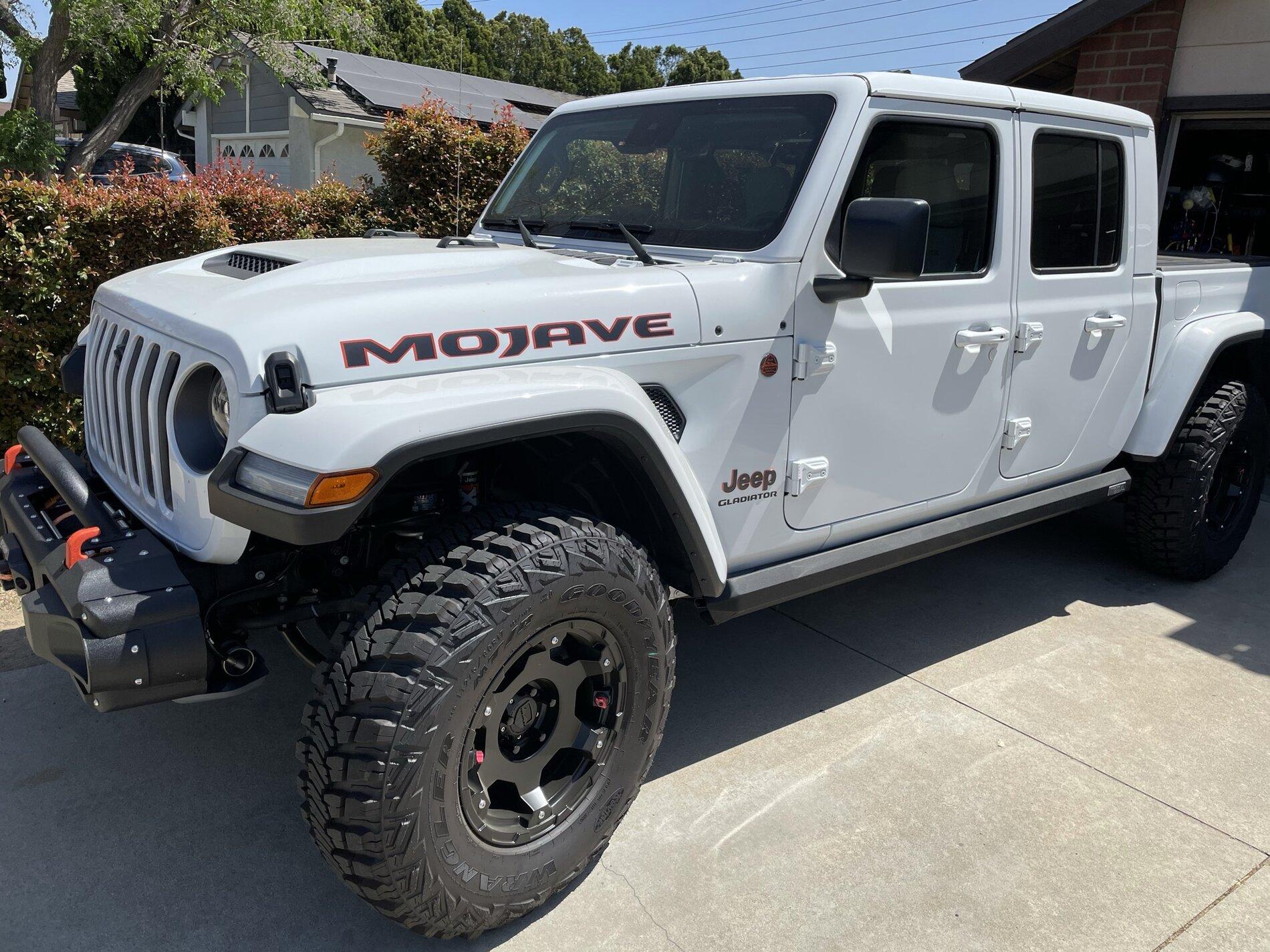

Finally got mine mounted, they make the setup look a lot better as I hate the cheap black plastic ones that were on before. Not to mention they wont stain from waxing either like the black ones did.

They look awesome!! And the prox keyless works, no issues?

yep they work flawlessly and were super simple to swap (probably the easiest mod to add thus far). Just make sure you have a longer T20 torq screwdriver. I wasnt sure I had one and bought one on amazon for 6 bucks (LINK HERE) However I really didnt need it since my harbor freight torx drivers would have worked, they just dont label them as t20 so I wasnt sure. Thanks again for that link!
