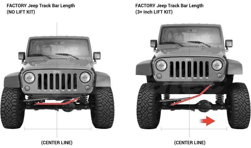

you may just need to adjust your drag link to bring the steering wheel back to center.
otherwise, your front end geometry may be out of whack and you need a new track bar that will allow you to re center your front axel after the lift.
Jeep Gladiator Pulling Right After Tire install c35b154262c6f4c7847d56730ec06aaa
This pic shows how lifting a jeep without adding an adjustable track bar moves the front axel towards the drivers side, which can lead to the wheels pulling until the front end geometry is fixed.
Jeep Gladiator Pulling Right After Tire install ThisJustHappened
I start with trying to center the wheel and go from there. Thanks for the awesome diagram!
