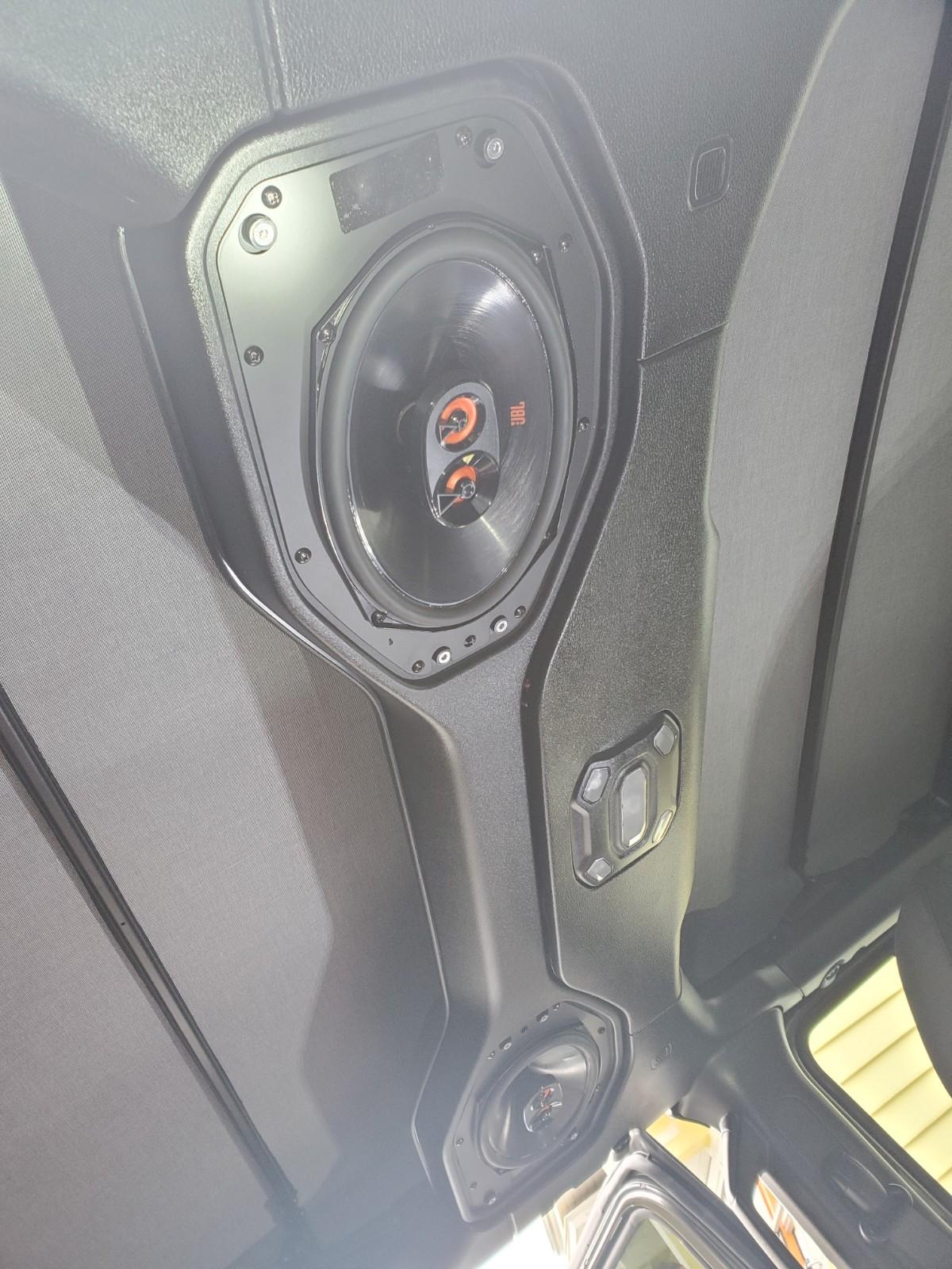

This seems pretty similar to the Select Instruments JL-JT Pods I installed. Looks like similar Kicker speakers too. I think I paid less than $250 for them and bought through Extreme Terrain. They made a significant difference over the stock speakers.

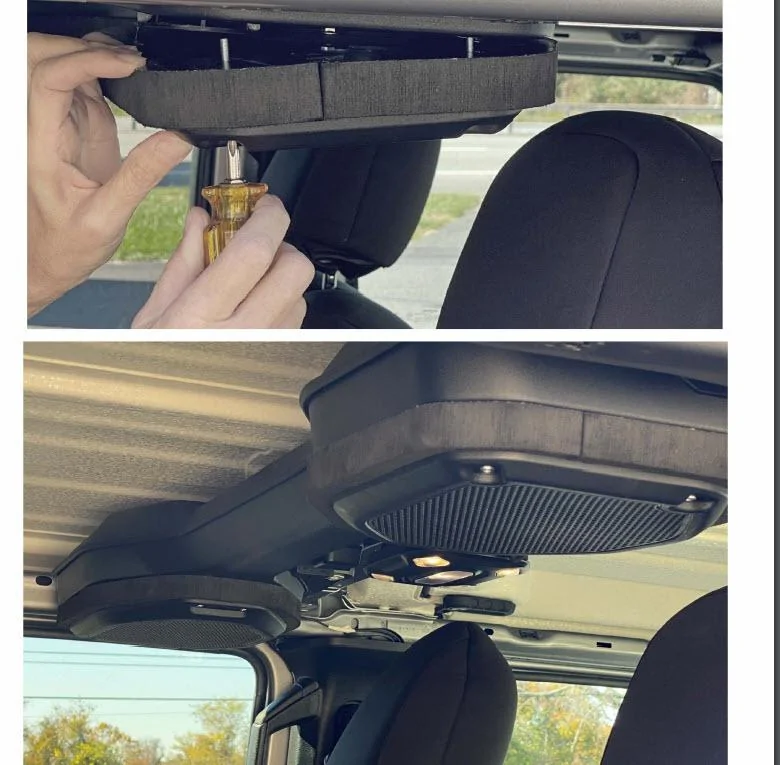

Those ones @The Bean posted look way nicer. The instructions from the Quad site have finished pictures, they look like shit to me.
Jeep Gladiator Quadratec Speaker upgrade shitty speakers

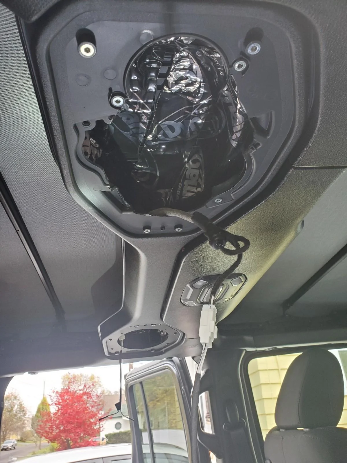

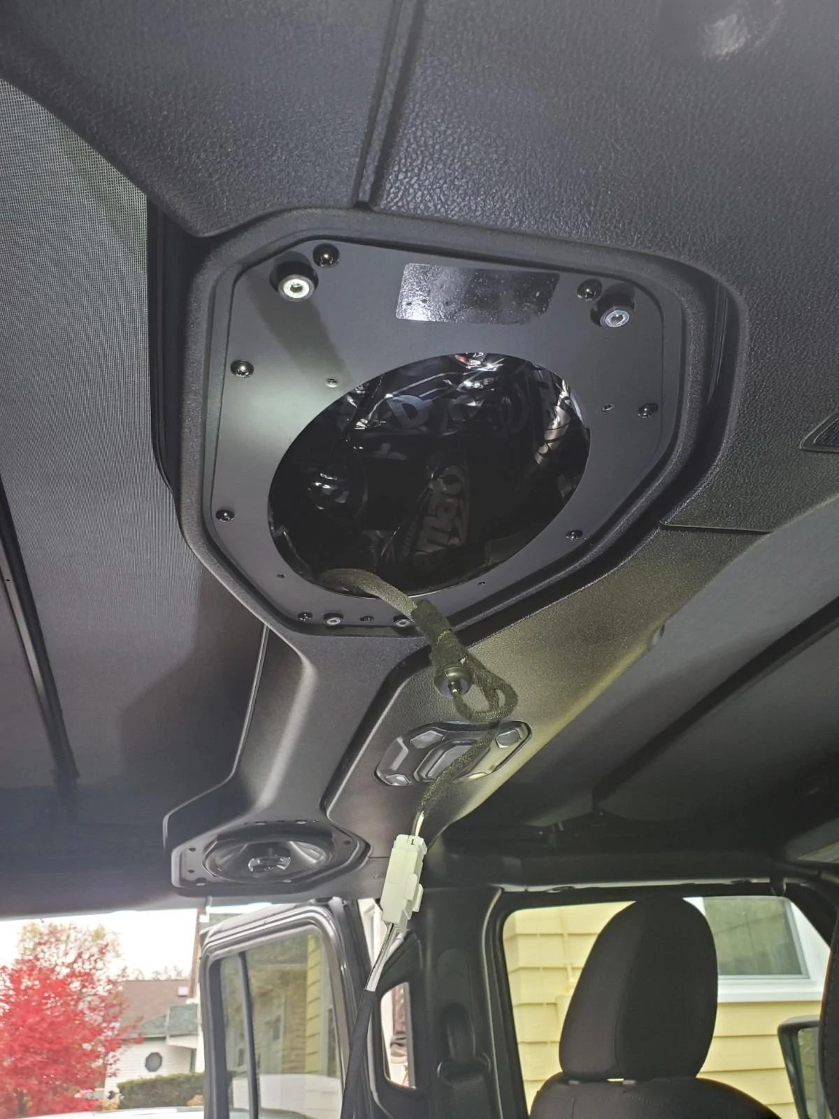

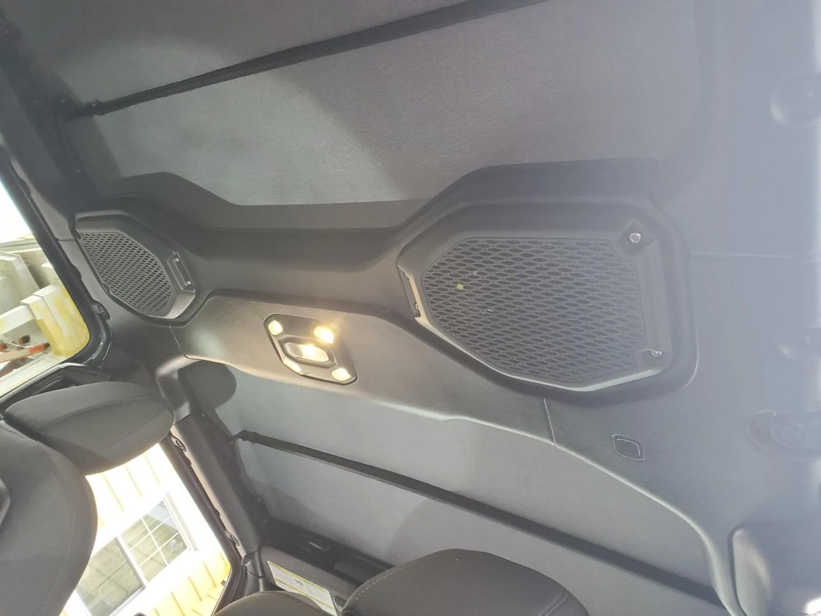

Another option you have that I went with are these 6x9 from JBL: https://www.amazon.com/gp/product/B085ZTR7G1/ref=ppx_yo_dt_b_search_asin_title?ie=UTF8&psc=1
And the MB Quart adapter kit:
https://www.crutchfield.com/S-VFqAyT1PcFA/p_049JE1169S/MB-Quart-JE1-169SB.html
You could also just get the MB Quart kit that includes speakers for about the same price as the Kicker.
Here is my install...
It sounds great, but no matter what option you go with I think a little extra bass is needed so I also am adding this powered sub:
https://www.amazon.com/gp/product/B0169YBEAU/ref=ppx_yo_dt_b_search_asin_title?ie=UTF8&psc=1
Jeep Gladiator Quadratec Speaker upgrade 20211114_132723
Jeep Gladiator Quadratec Speaker upgrade 20211114_135418
Jeep Gladiator Quadratec Speaker upgrade 20211114_135608
Jeep Gladiator Quadratec Speaker upgrade 20211114_140243
Jeep Gladiator Quadratec Speaker upgrade 20211114_141550
I went with what I did because I want to be able to return the vehicle back to stock as much as possible when I trade. Hacking up the inside of the sound bar just isn’t a feasible option.

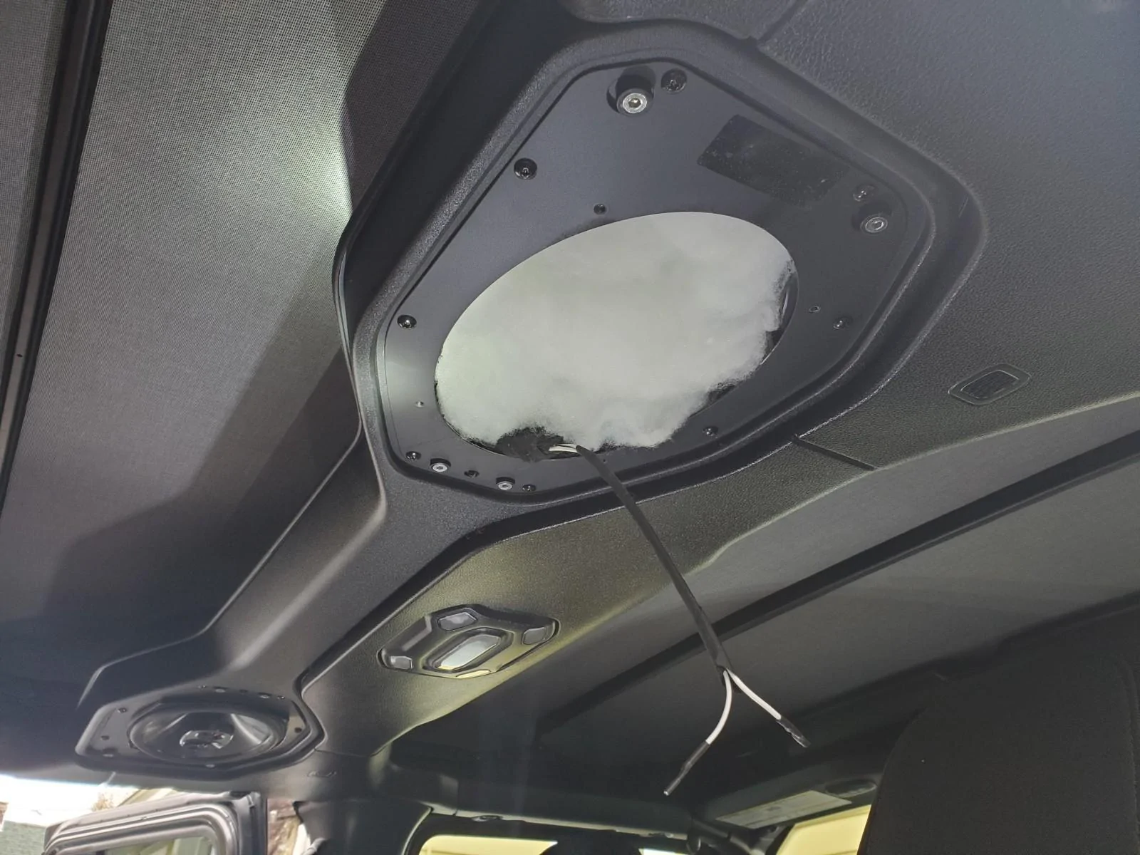

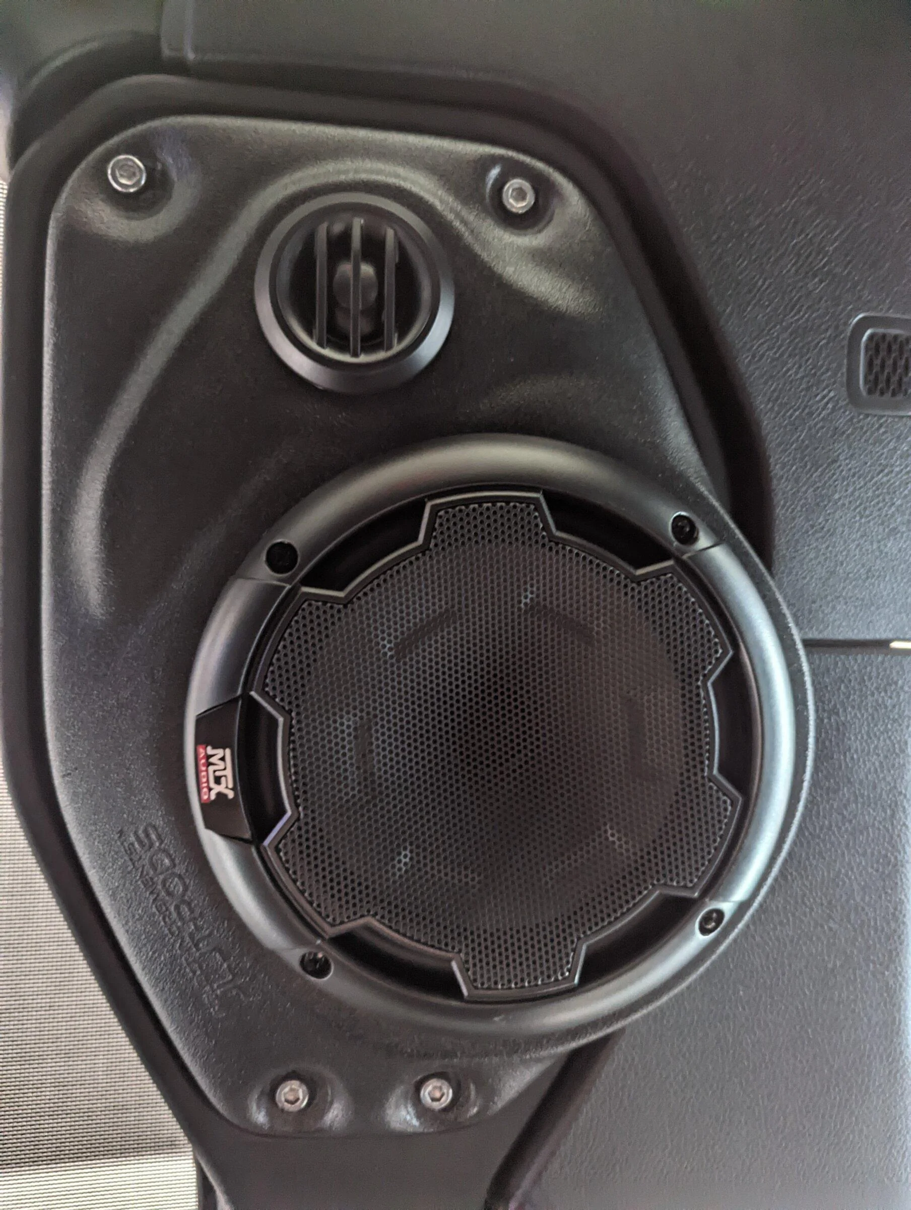

I agree that the final product looks terrible--those inserts don't match the grain of the factory plastic at all and don't even look to be well-finished. The rough edges and seams are ugly. I would go with the Select Instruments JL-JT Pods (which I have in my Jeep) and some better 6.5" two or three-way speakers than the Kickers. That would be the easy way to do this. For better sound but an admittedly more complex installation, you may be able to use component speakers (the ones with separate woofers and tweeters) as long as the external crossovers are able to fit in there somewhere. I have done the job and I think there's room for them. I say "I think" because I have the factory Alpine upgrade, which eliminates the need for an external crossover because the existing plug-ins already split the frequencies that go to the separate woofers and tweeters.
I used these in the JL-JT Pods: https://www.crutchfield.com/p_236THND61/MTX-Thunder61.html
I did not need to use the included crossovers for the reason I explained above. Because it sounds like you do not have the Alpine upgrade, you WOULD need to use that crossover. With other factors being equal, I picked these because the "gear" design of the speaker grill resembles the upgraded Jeep wheels on my Rubicon.
Jeep Gladiator Quadratec Speaker upgrade PXL_20220602_194741002

Interested int his- the mod doesn't look too bad. So basically the new speakers come with the round enclosure. Hold the enclosure up, trace the opening into the factory soundbar, cut away the factory soundbar areas, and then remount the new speakers?
Complete agree, installed them in my Glafiator and wife's Wrangler.
