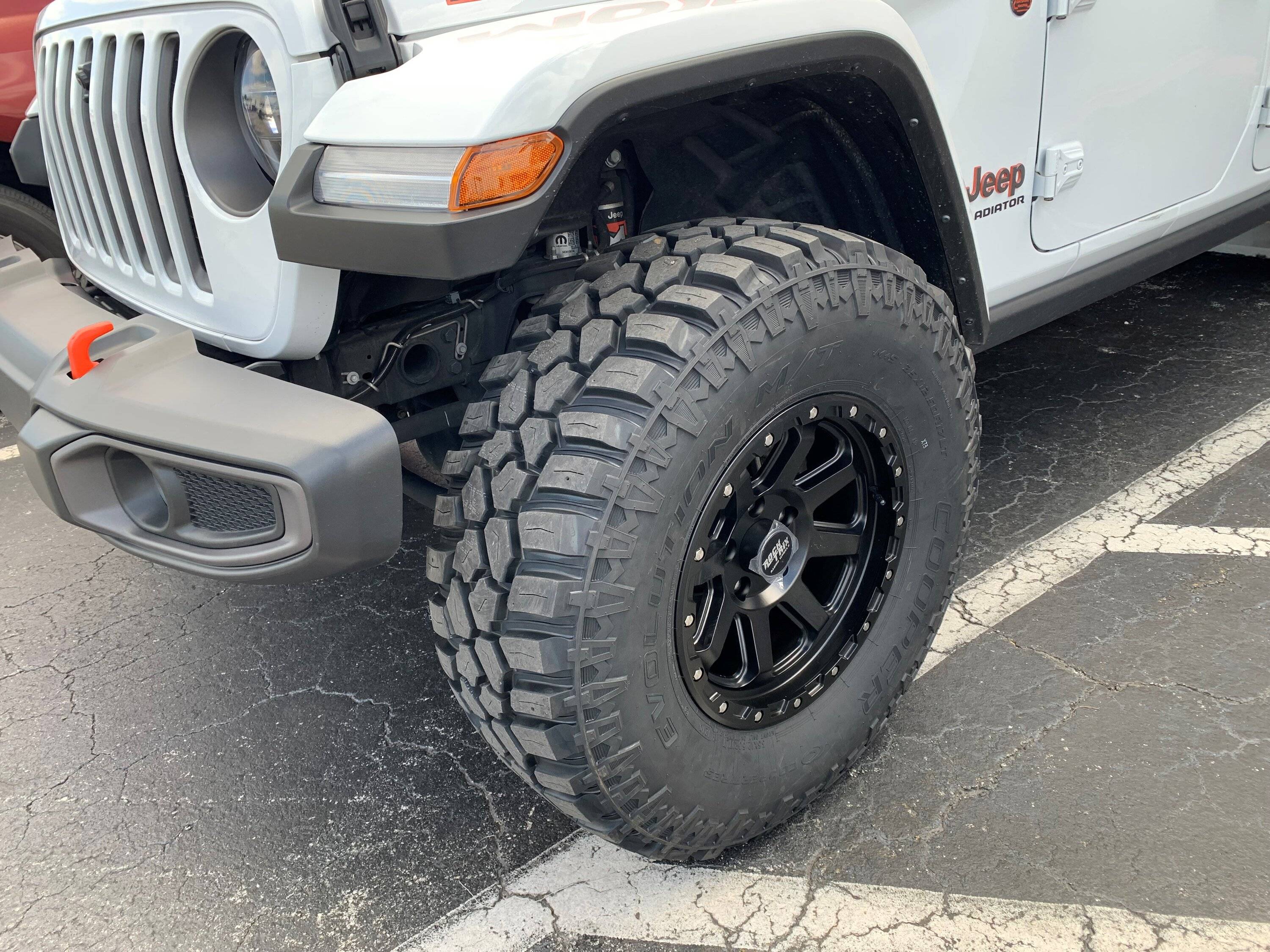

I just watched a video on Youtube and it says you gain about 3” more space from top of tire to underside of fender by removing the inner front Fender. I was planning on getting 35s and doing a 1.5” leveling kit, but now that I see this fender “chop” option, I’m wondering if that might be a little more useful for flex than the leveling kit.
Can anybody elaborate on whether I am on to something? I’m aware that with the chop you have to get new inner fender/engine bay liners,, turn signals, and brackets for the fenders which is overall significantly more expensive than a 1.5” leveling kit. But I feel that the 35s would look better overall with this rather than with the level kit.

I know you didn’t ask about 37’s but thought I’d add this just for reference.
Just picked up today. Lovin it. -37 Nitto ridge Grapplers. -Mopar 3 in. lift -Mopar SlickLock Wheel in 17x8 with 4.4in Backspace (- 3mm offset) and sway, track bar, and steering stabilizer replacements.

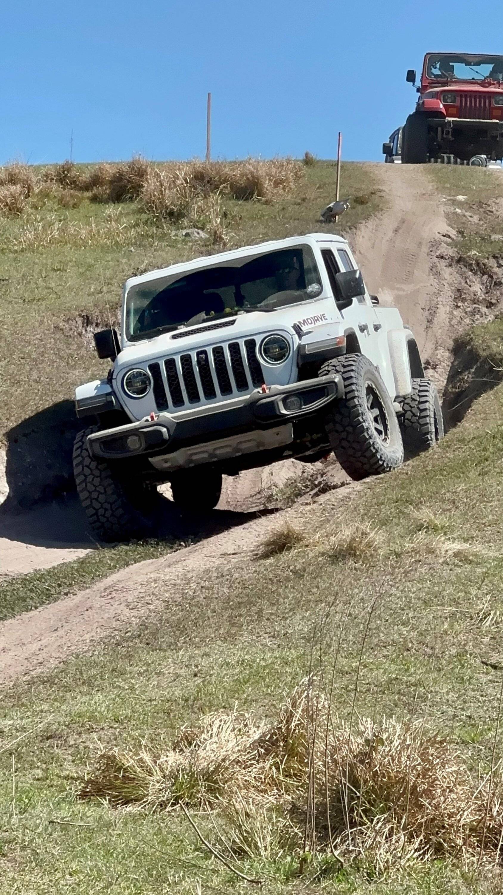

shows what I'm talking about. Obviously you have to line the fenders. But overall, this appears to me to be a situation where I can gain about 2.5" of flex without having to do a level kit or lift. If you look at most of the rigs that are serious about being on trails, 9/10 of them have either full fender removal, their fenders chopped, or no fenders at all.
