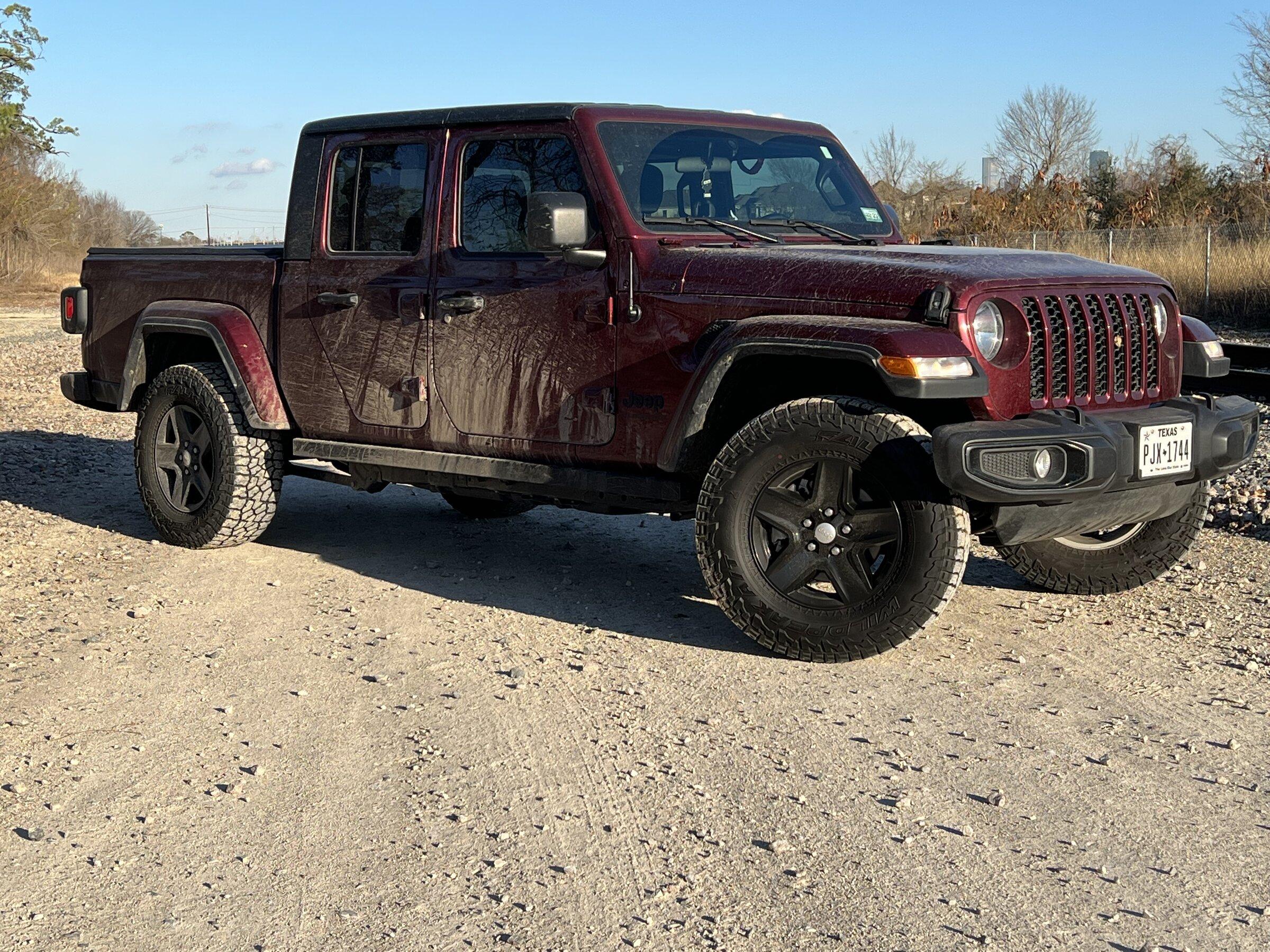

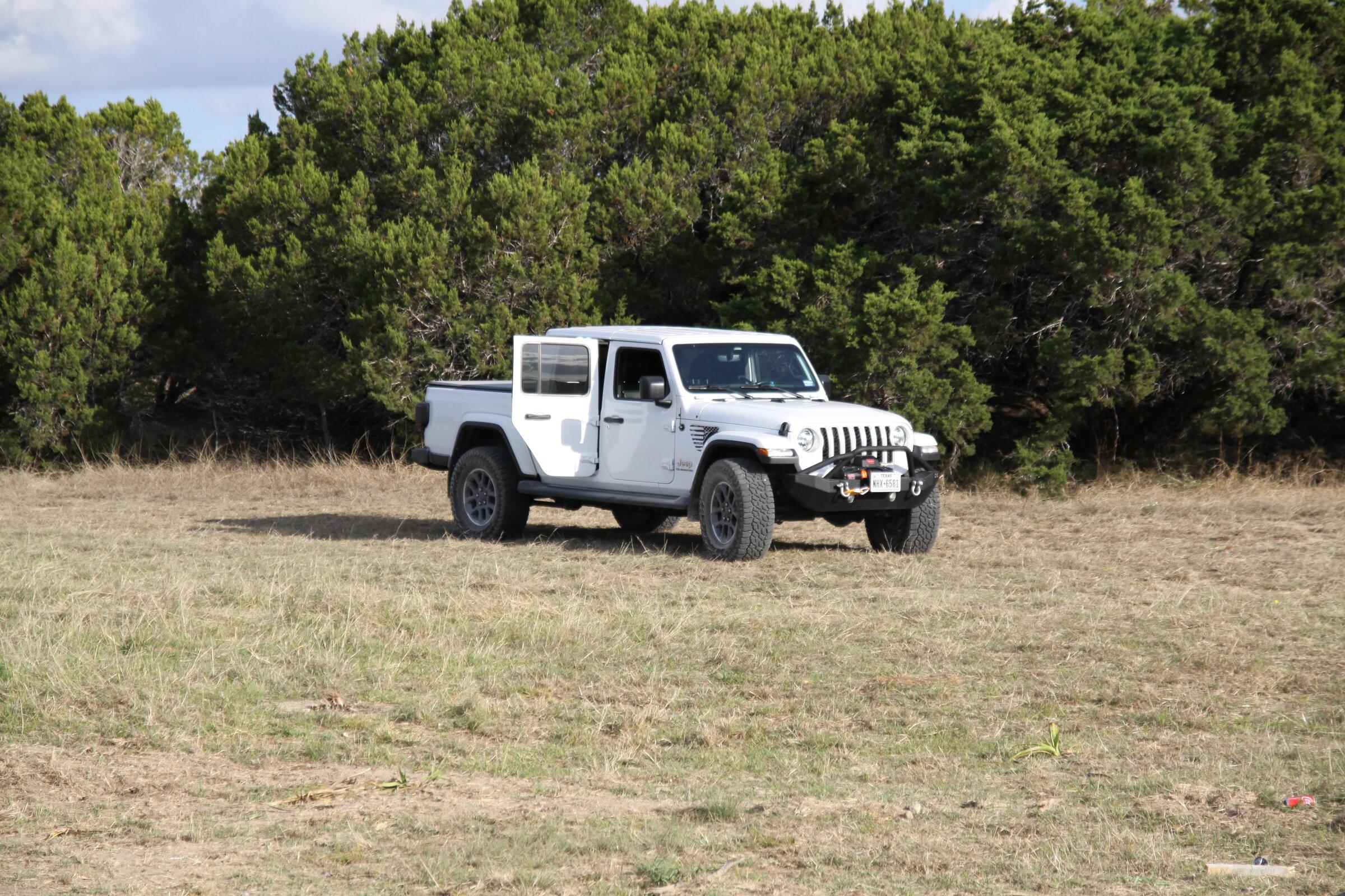

Here is my Overland on 1.5 Teraflex front and nothing on the back. Steel front bumper (mid width Fishbone) and Warn winch (so ~200 extra lb in the front) and 35 inch Wildpeaks. There is still a rake.

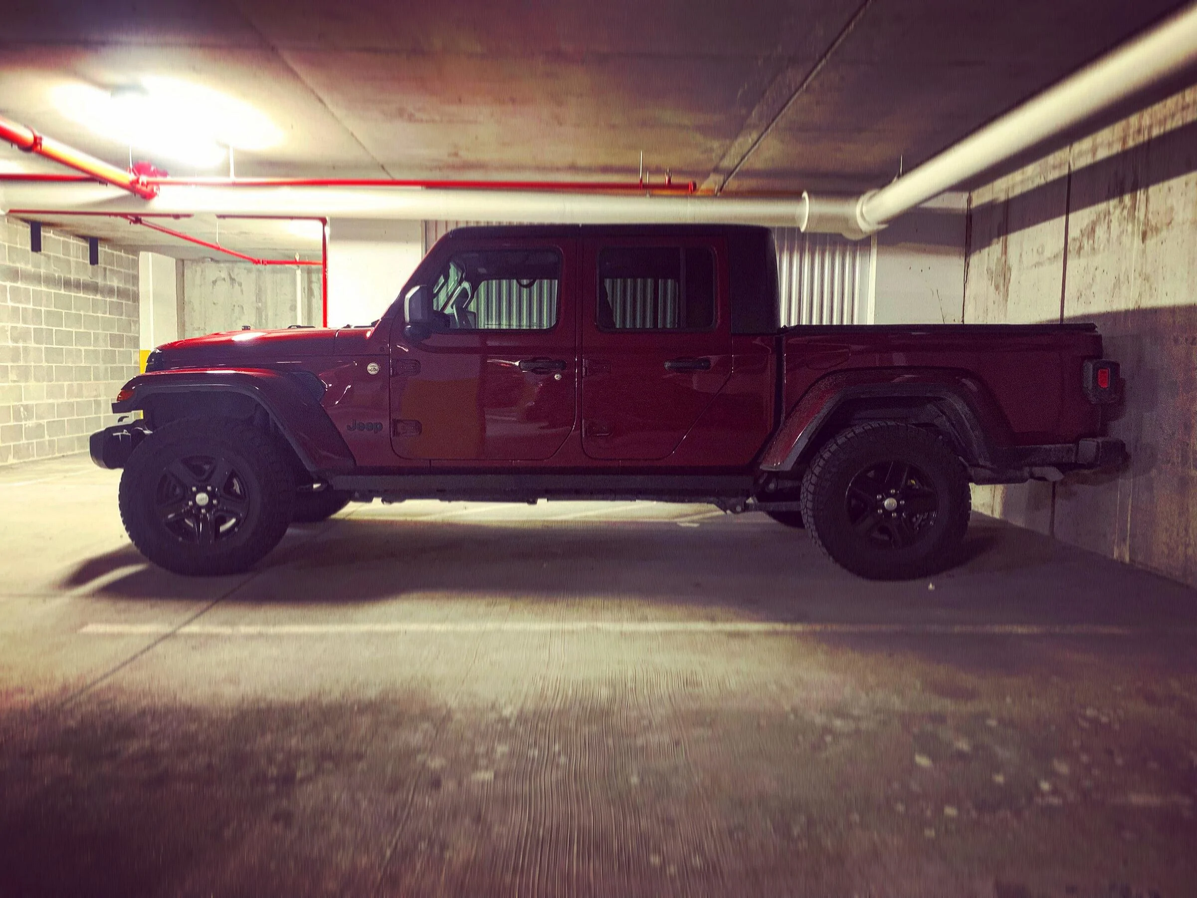

Here is my Max Tow when I had 33s and just the Teraflex 1.5” level kit. Like others mentioned, the front was still a bit lower than the rear.

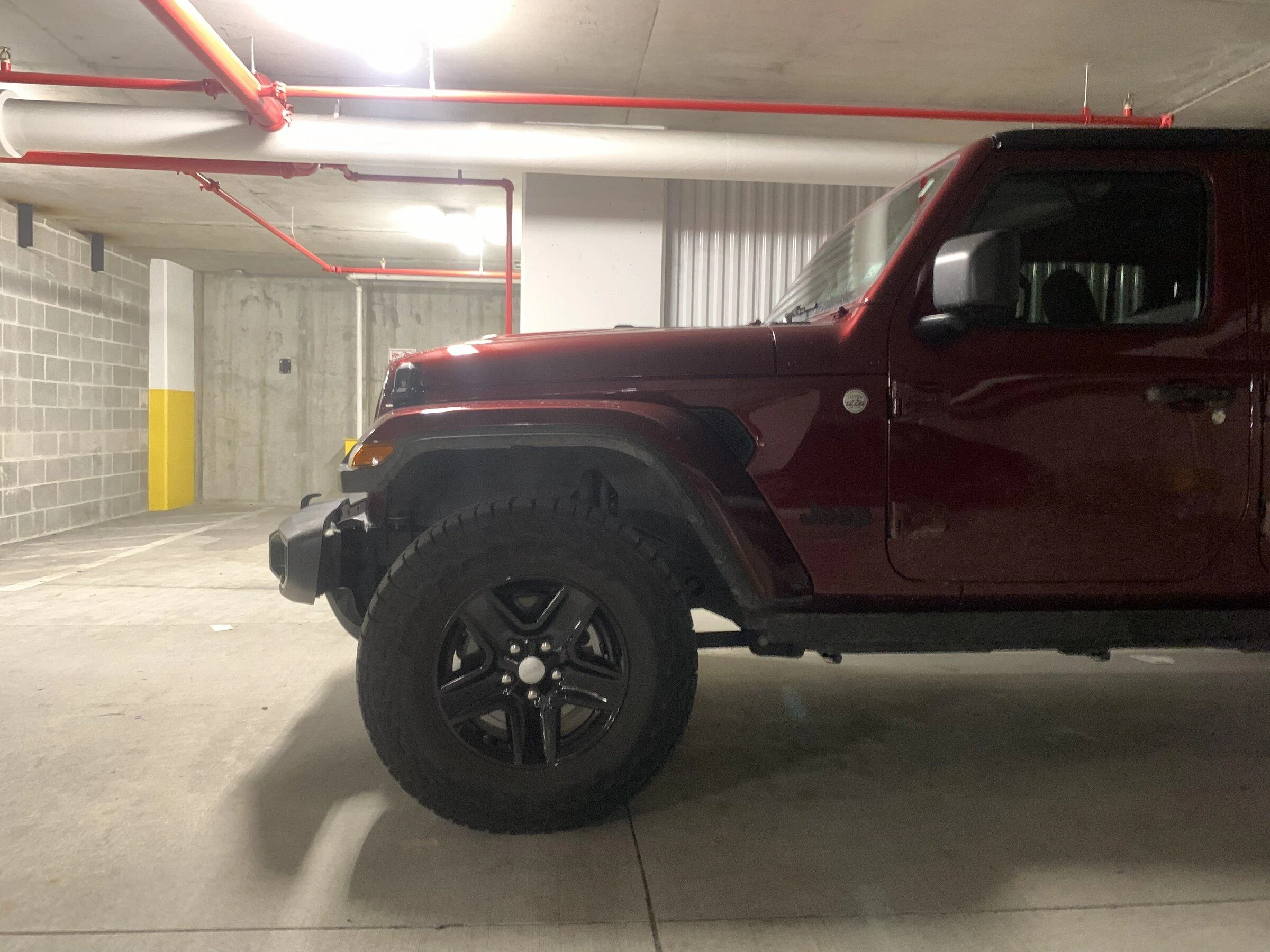

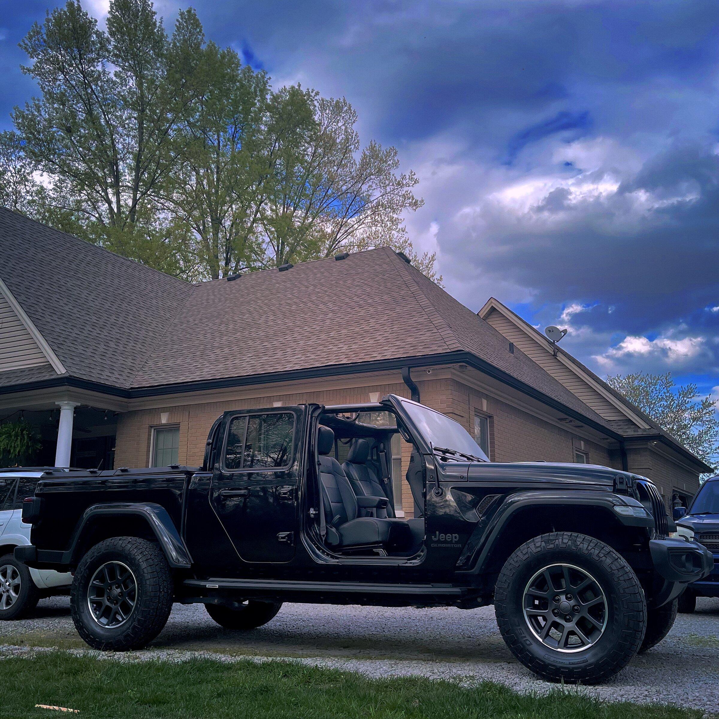

Most people add the rear to keep a slight bit of rake but still able to raise the front. I was initially gonna do the same. But after the teraflex leveling up front I liked the stance and didn’t feel the need to.
Not the best side shot but Here’s mine without the rear.

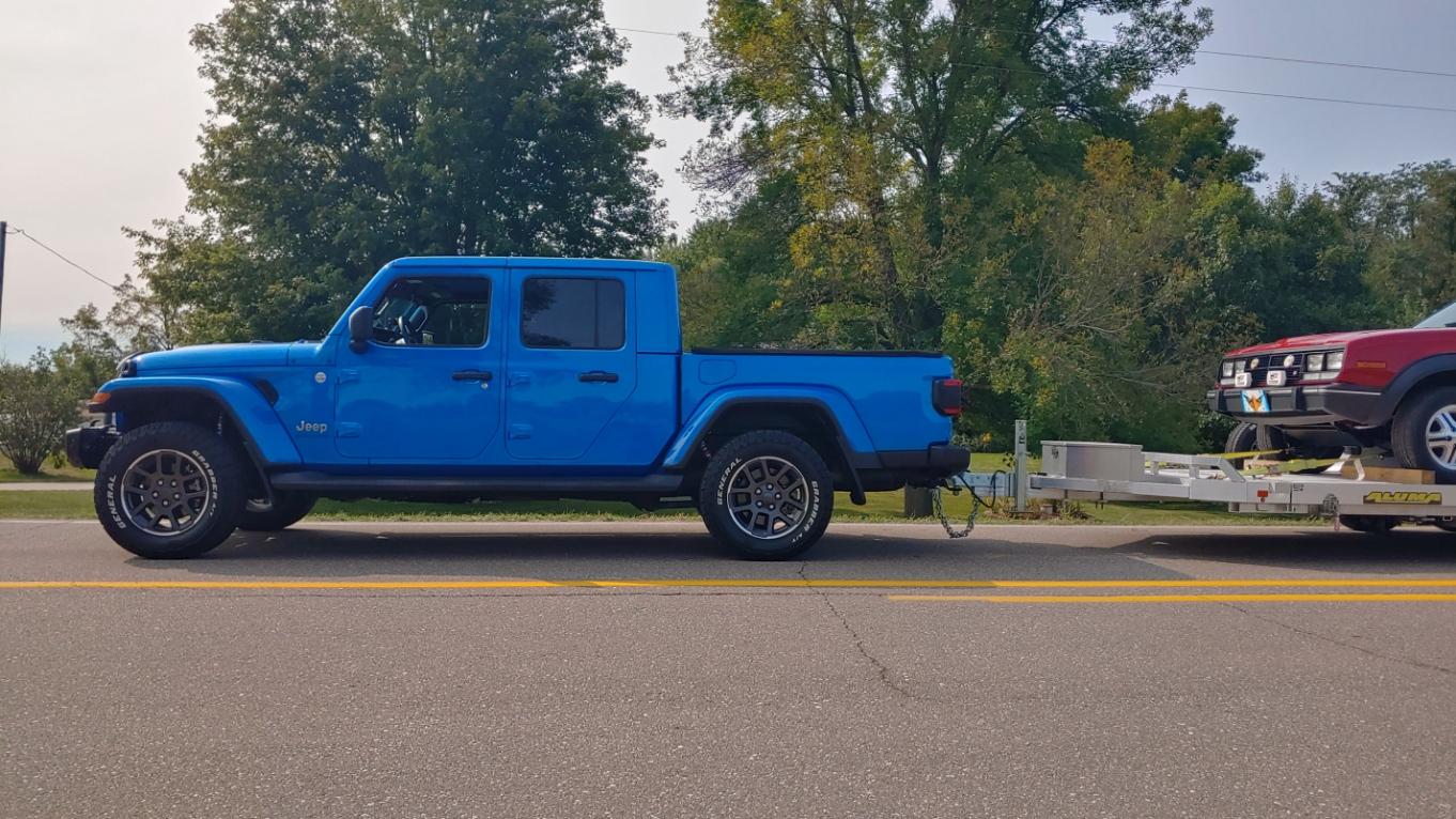

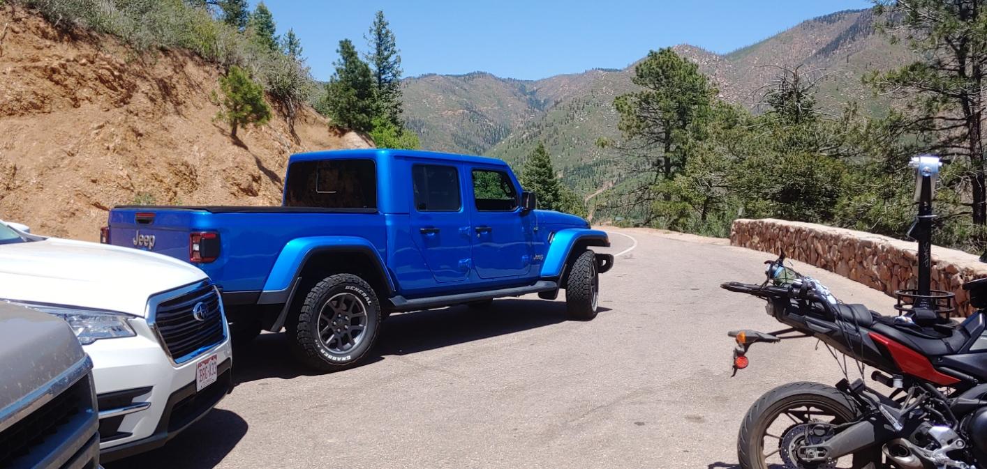

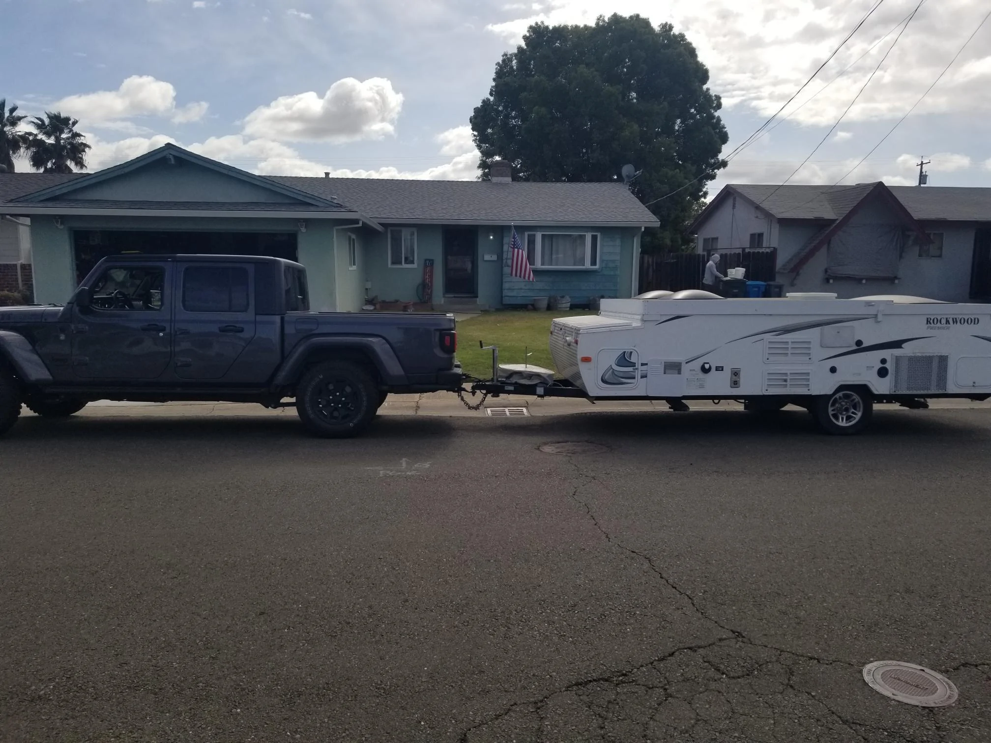

180
29,422
34,997
When I tow I have about 500 pounds tongue weight. That makes the truck sit level.
If I took the rake out, it would squat in the back - it would be lower back there.
And I have max tow springs under the rear of my JT.
Yeah, 500 pound tongue weight towing a 5,000 trailer is enough to take the rake out.
Not sure I'd personally want to take any rake out of my truck - if I did, it would be minimal because I had the squatting dog look when towing or hauling stuff.

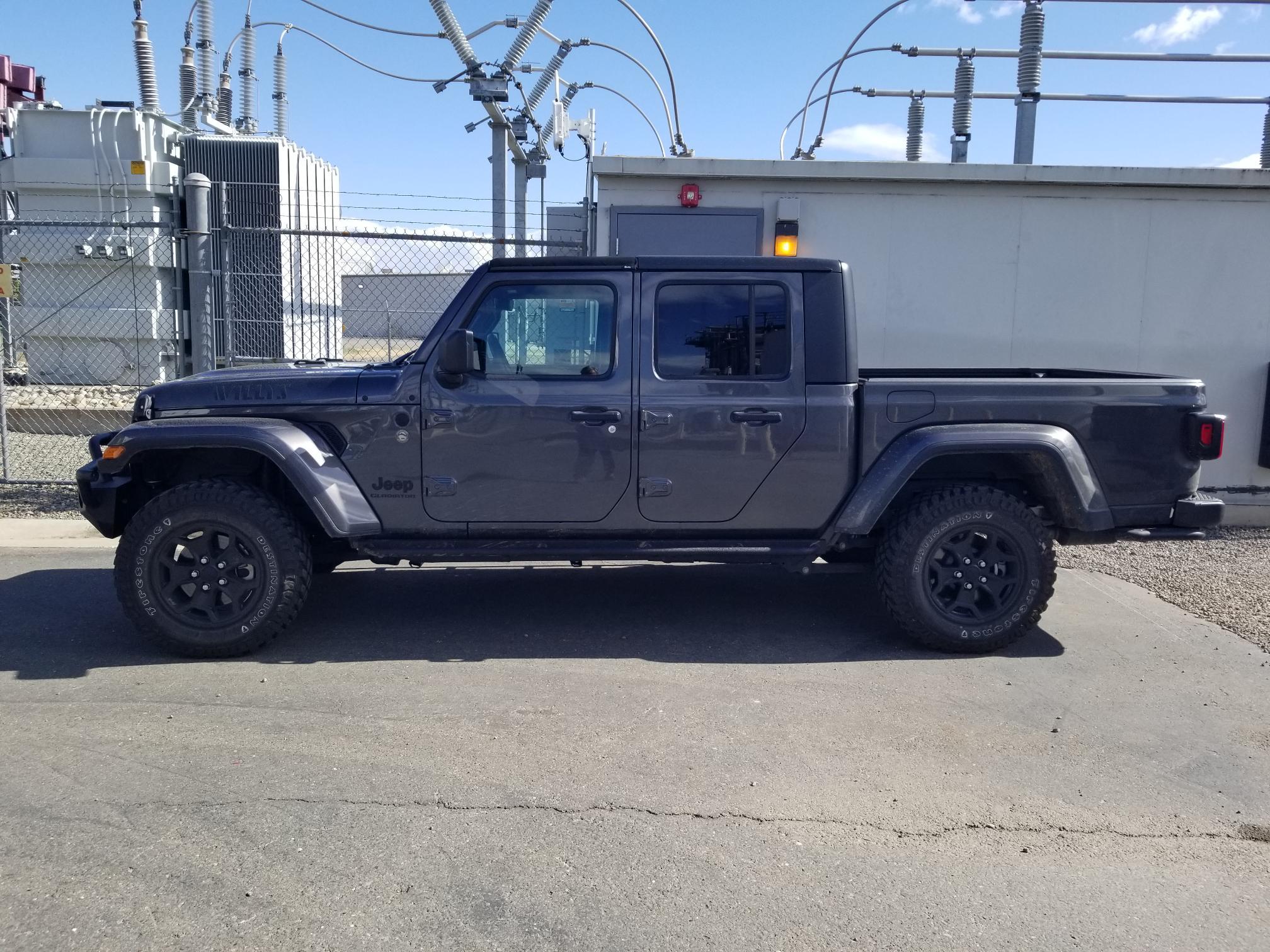

I have a 21 Willys.
2" springs up front. 1.5 inches for the rake and .5 inches for the weight of the steel bumper with 10k winch.
Will, sits almost perfectly level. I drive empty or with my kayak in the back all the time. A few times a year a haul a camp trailer. there is a half inch squat with that 3000 lb trailer.
