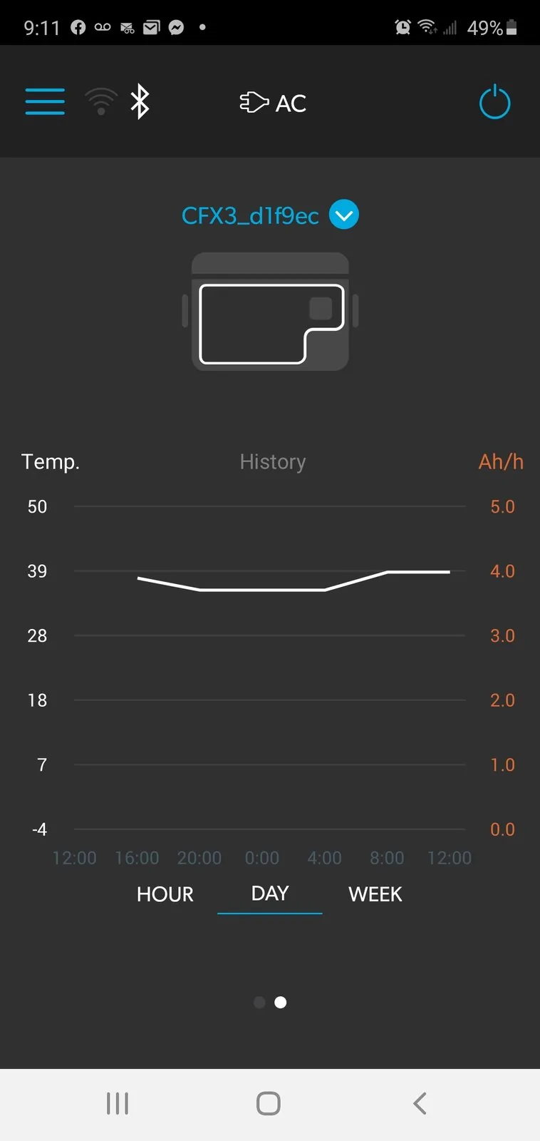

So i just picked up a new Dometic cfx3 55IM. The specs said this fridge uses 1.1 amp hour @90 degrees, but i have had the fridge plugged in AC power for a day now and it has stayed steady at 4.0 amp/hour.
My question.. is the app providing inaccurate and not reliable information or was i misled by the specs providec by dometic?
Will this fridge perform more efficient on DC power?
Am i missing somthing??
After doing much reading on this topic i was confident i could use this fridge with a 100ah solar generator set up for several days but if it runs at 4ah I'm barely going to get 1 day before my solar generator is dead.
Please help, please school me. I hope i did not spend 1K for something that will not work for multiple day camping/overlanding trips.

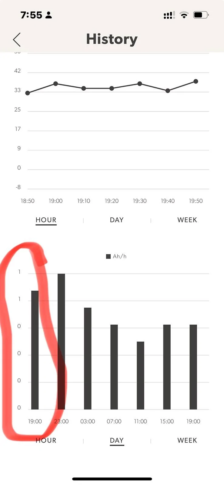

I may just be stupid and reading this app graph wrong. Is this graph in the app showing me the current temperature or the Amps per hour its using. Now im super confused. I'm usually smater than this lol.
Ok.. yeah I'm and idiot! It does not show amperage usage until it is working on DC power..duh! I should of known this.
Sorry for the stupid post

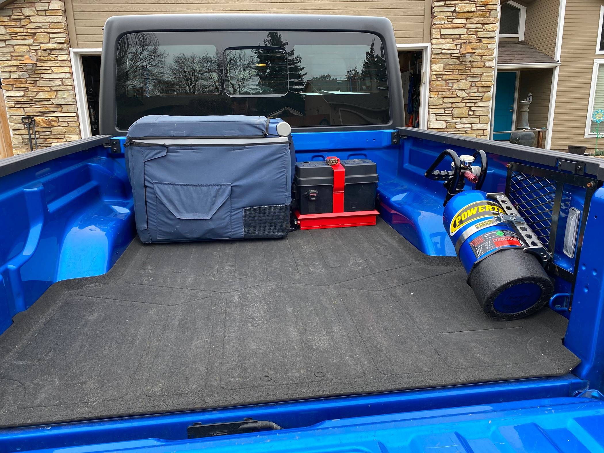

I used the slide system that Dometic makes for my particular cooler. I didn’t want to drill holes in my bed so I cut a 3/4 inch sheet of marine grade plywood to fit and mounted my slide to that. I also have a small chest type toolbox with my batteries, charger and inverter mounted inside. I have been in Destin Fl since Sunday and everything has worked perfectly except my Renogy battery monitor quit working before I left. I ordered a Victron that did not arrive in time for me to install it before the trip. The two batteries have powered both of my coolers all week with only running the truck <30 minutes per day. Thursday it sat in full sun all day while we were out fishing. And the temps inside were perfect.
