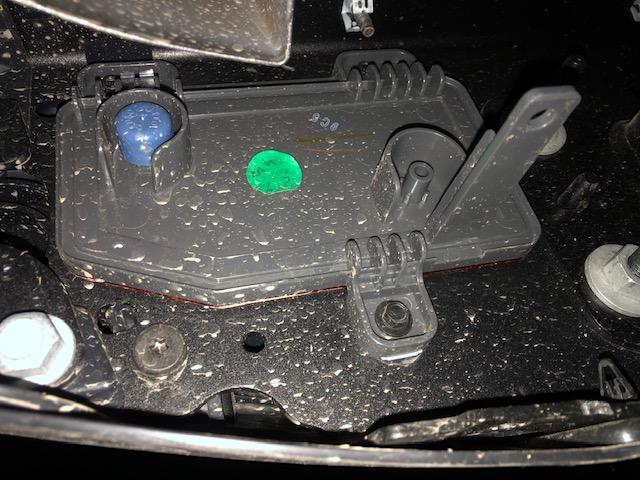

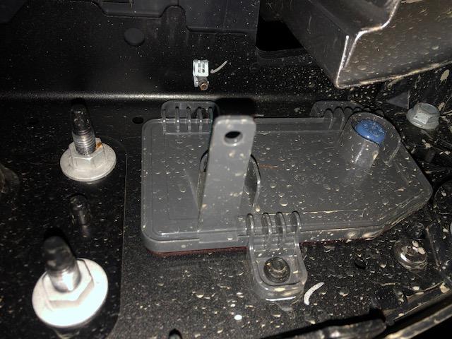

Looking at how these reflectors are built, view from the back side, it almost appears they can be set up with lights.
Questions for non-US owners, do these things light up as brake lights or for any other process? This bumper may be on here a while till I can find one I like, can afford or is light enough (Aluminum?) for my weight demands.
As much as I have fun wiring a 72 CJ 5 and doing backup and deer lights on this JT, I am darn tempted to turn these into brake lights, just for fun ( and I-95 morning drive buttheads ).
That blue cap in PIC pulls off and you can see through to Red reflector. That PIC with bright reds is just from the camea flash but makes you think about how nice of an addition these could be as brake lights.
Have you pulled the blue cap - whats under it? Seems a well placed single Led bulb wired into the license plate light would make it a running light. Tap into brake light to add more? Having driven I 95 for years - not sure any of it matters ;-) but it seems you could modify pretty easily. I can't find the thread but one of the members hear buried some led backup lights in the reflectors - he might have a bit of insight into the make up of reflector as he took it apart / modified it

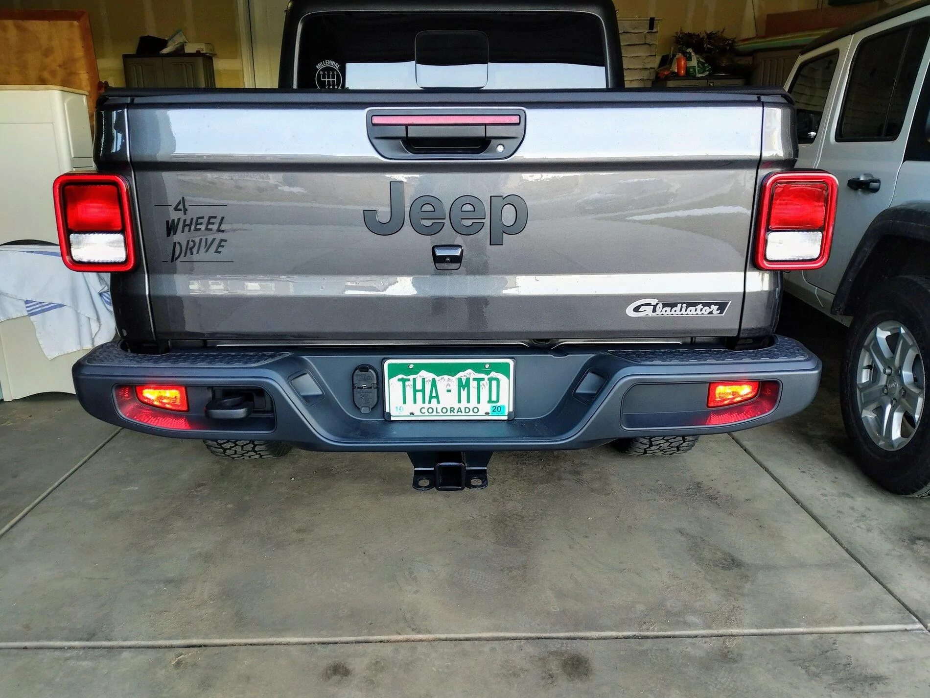

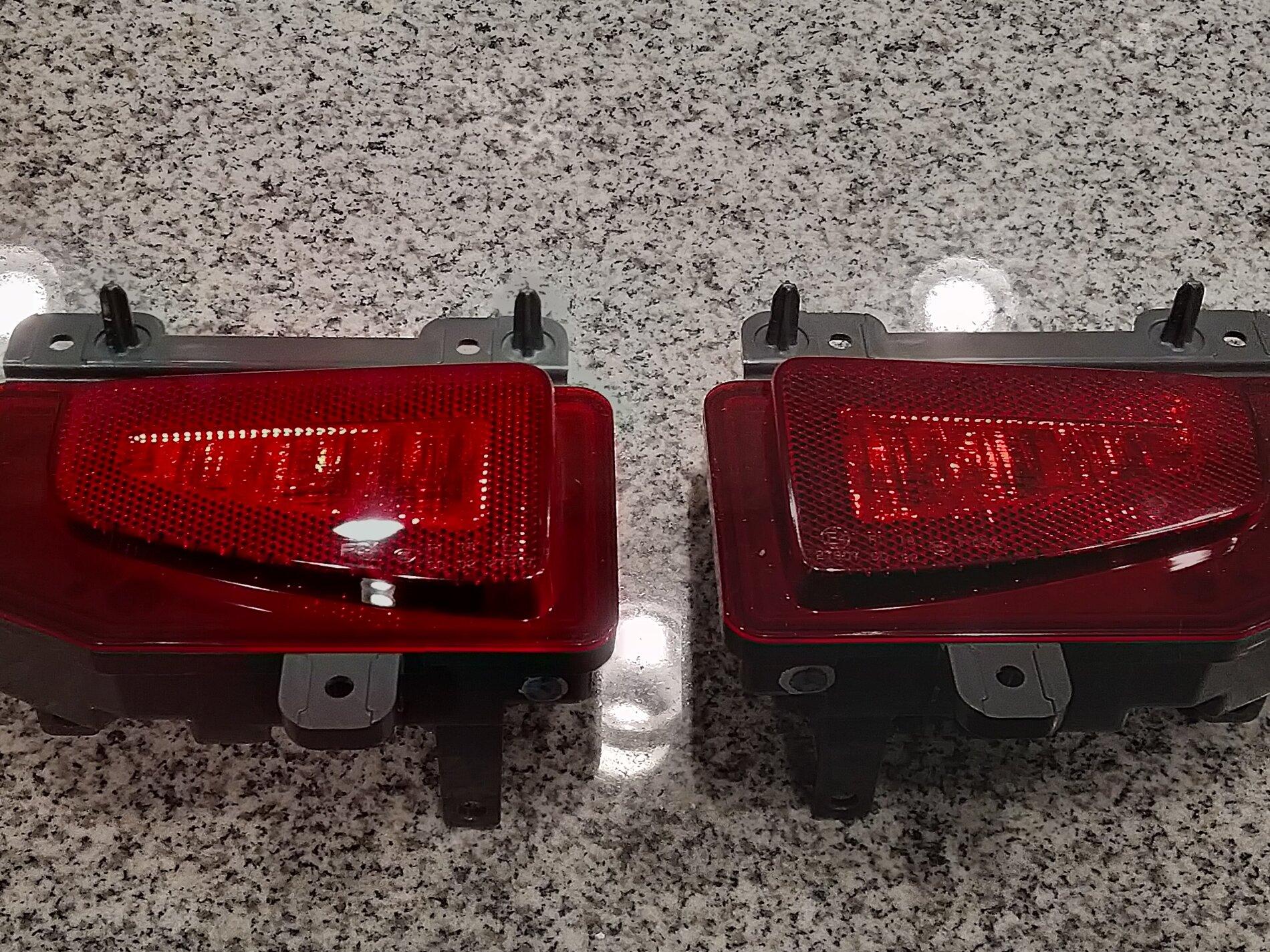

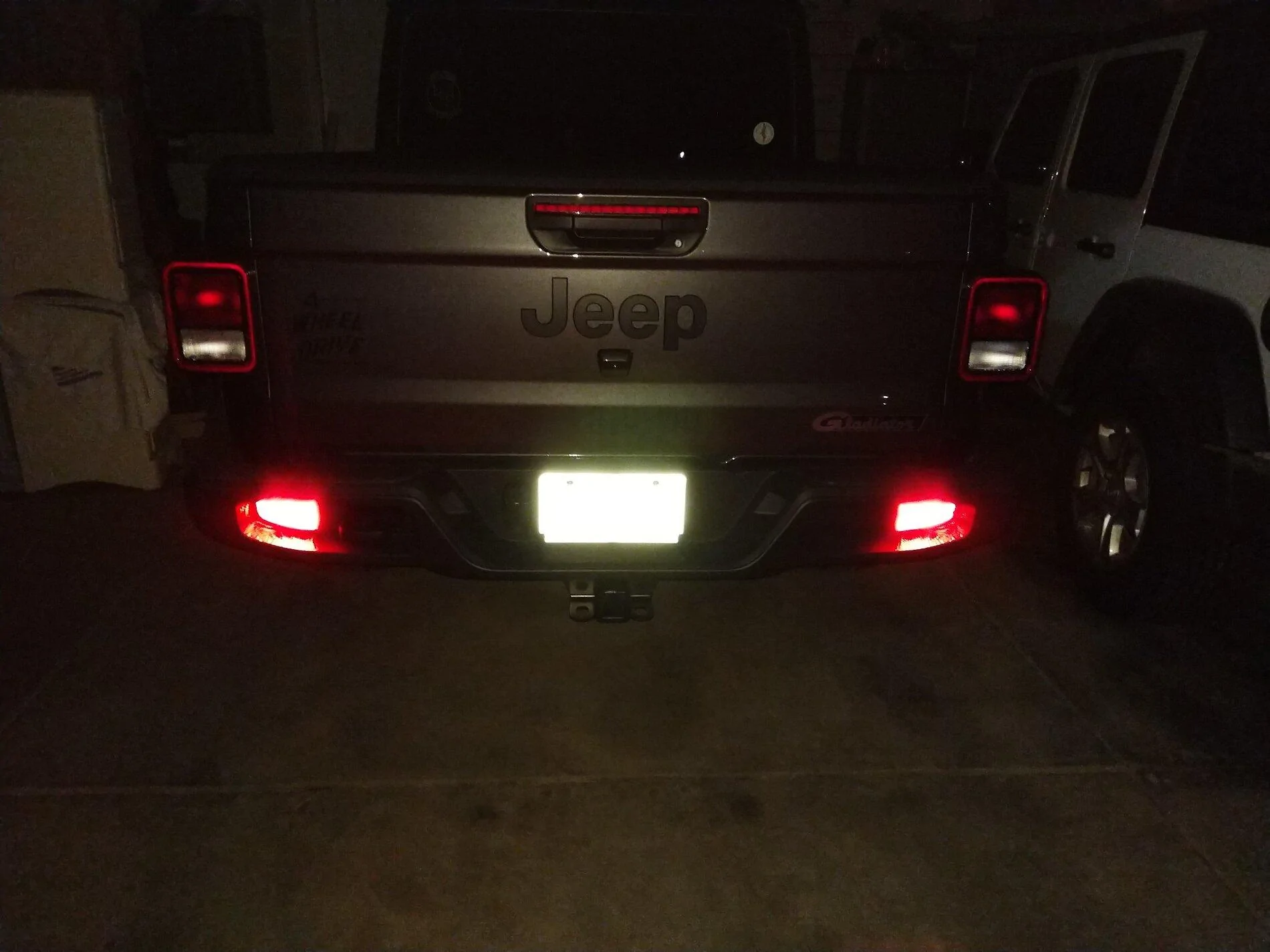

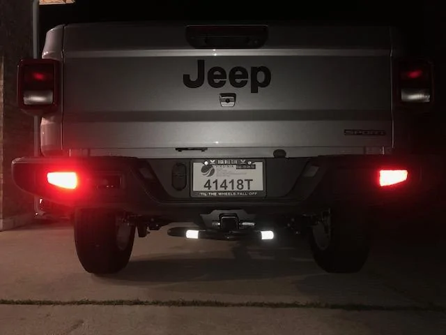

I installed the Euro spec rear fog lights back in March, did a brief write up on another post. The plugs are expensive if you order them individually, or just order a standard license plate wiring harness and lengthen where needed. They are hooked up to my Aux 3 switch with about 25 feet of wire wrapped in friction tape to match the factory wiring. The wires are not in the US spec wiring harness to tap into, already exhausted that research.

Thanks for sharing, nice product and option. Roughly how much did the pair cost? I will do a search now.

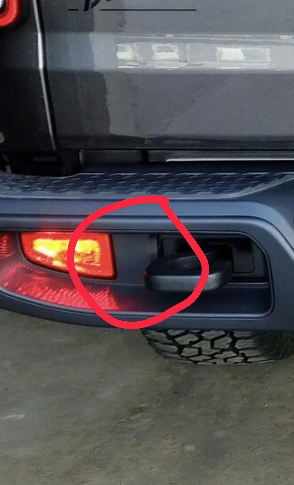

Very cool. Some people also put lights here next to the deflectors. If you have the tow package could you tap into the trailer harness and wire your additional brake lights as a pretend trailer?
They're wired as fogs only, but yes, you could wire them that way, super easy.

Curt sells a T harness that plugs in to the back of the trailer plug. It makes tapping in to the lights real easy. I did that when I added a set of KC Reverse Lights .

Could you link the part you bought for this? It sounds like an easy way to add rear lights. Thanks.

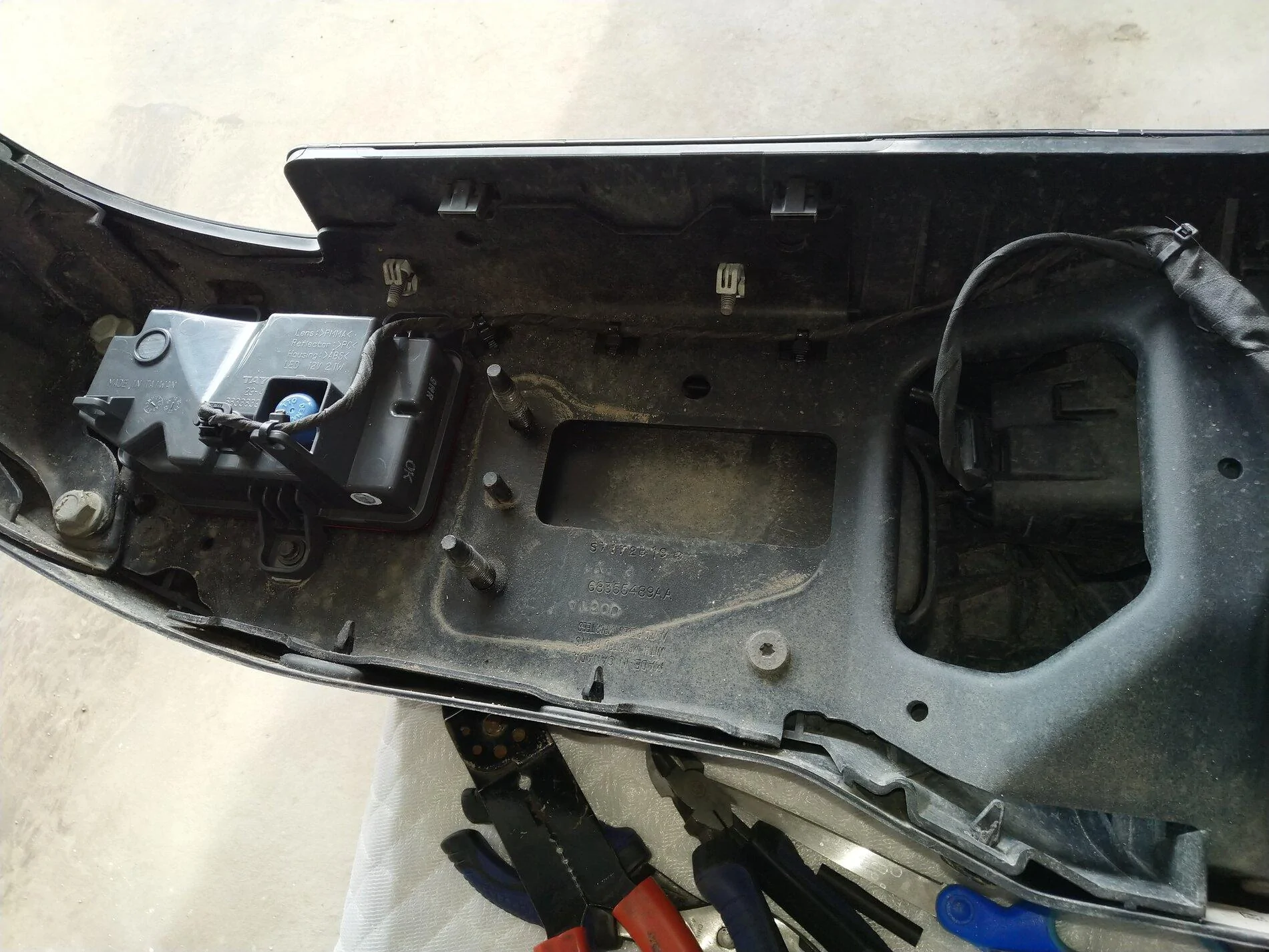

Curt Harness
https://smile.amazon.com/dp/B007EA6WQU/ref=cm_sw_r_cp_apa_fabc_eSV0FbQ0D441A?_encoding=UTF8&psc=1
I used this to wire from
https://smile.amazon.com/dp/B079R168SF/ref=cm_sw_r_cp_apa_fabc_tXV0FbE1BFJCG?_encoding=UTF8&psc=1
And this to mount it underneath
https://smile.amazon.com/dp/B00537FDCA/ref=cm_sw_r_cp_apa_fabc_i3V0FbCXAN6RH?_encoding=UTF8&psc=1
The Curt harness goes between the factory connector and the back of the 7 pin plug. I used the plates to mount the other end behind the bumper. I plugged in the trailer harness and wired the lights to it.
