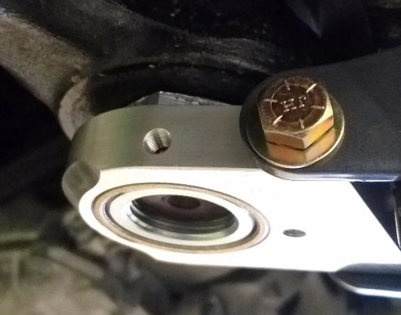

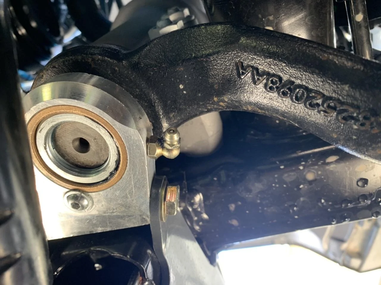

I didn’t have a torque wrench but thought I tightened the nut on the pitman arm pretty good. Can someone whose installed the bracket tell me if I’ve got too many threads showing?? Thanks!

Impossible to say. At the required torque (184lb-ft), 50lb-ft is less than 1/4 turn. To achieve the required torque, a three foot piece of pipe slipped over a 1/2” ratchet will require significant force. Any picture is not going to really help. That said, yours looks very close!
