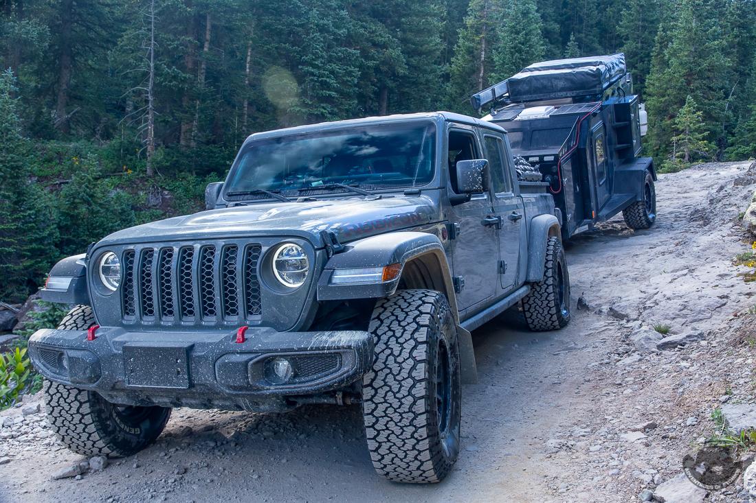

I can't answer your diesel questions, but pulling our off grid trailer (1.500lbs empty and 3500lbs max) I typically get about 10mpg. Heading west you normally have a head wind and I'm now in the 7-8mpg range cursing at 65mph. I've got stock gearing and suspension but am on 35s.
The JT and my trailer are both bricks, so I don't really expect great gas mileage. It does suck only being able to go about 150 miles before needing gas though :(

I was expecting a drop in mileage but 6-7 is really bad with a relatively light trailer. I can relate to filling up often, on our trip out west we were filling up every 2 to 2-1/2 hours. 34 fill-ups in 2 weeks.
The head wind was the killer, since it is the lack of aerodynamics that hurt my setup and not the weight of things.

Did you tow your trailer with your truck before putting on the 35s? Tire size makes a big difference.
Yes, tire sizes does effect mpgs quite a bit. I did not pull it on any trips with the stock tire size. Before the 35s going on the JT (and the trailer) I was pulling it with my JKUR on 37s.
Without the trailer I typically average about 17mpg in the JT.
