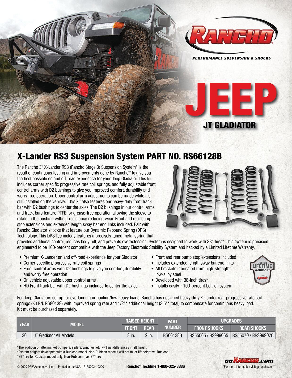

The Rancho 3” X-Lander RS3 (Rancho Stage 3) Suspension System* is the result of continuous testing and improvements done by Rancho® to give you the best possible on and off-road experience for your Jeep Gladiator. This kit includes corner specific progressive rate coil springs, and fully adjustable front control arms with D2 bushings to give you improved comfort, durability and worry free operation. Upper control arm adjustments can be made while it’s still installed on the vehicle.
This kit also features our heavy-duty front track bar with D2 bushings to center the axles. The D2 bushings in our control arms and track bars feature PTFE for grease-free operation allowing the sleeve to rotate in the bushing without resistance reducing wear. Front and rear bump stop extensions and extended length sway bar end links included. Pair with Rancho Gladiator shocks that feature our Dynamic Rebound Spring (DRS) Technology. This DRS Technology features a precisely tuned metal spring that provides additional control, reduces body roll, and prevents overextension. System is designed to work with 38” tires*. This system is precision engineered to be 100-percent compatible with the Jeep Factory Electronic Stability System and backed by a Limited Lifetime Warranty.
