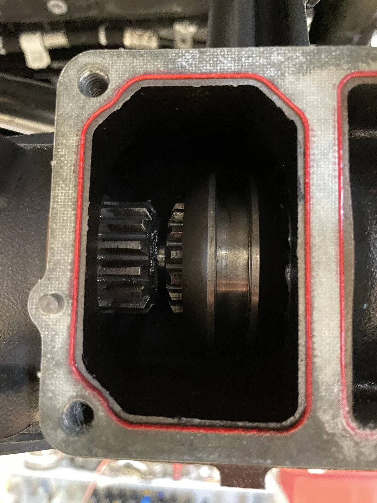

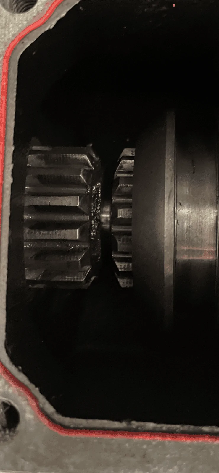

So I myself have a front end noise. It started occurring with only 2500 miles as a squeaking or creaking noise from what sounded like the front right side. It almost sounded like a caliper sticking. After taking it to the dealership and having both calipers and brakes replaced. As soon as I drove off the lot, the same problem existed. I continued driving it to see if the problem would progressively get worse. Eventually it turned to a “tire rub” or “ABS” noise at higher speeds. Long story, I took my jeep back to the dealer this week (6500 miles) and what they found was that the plastic bushing in the electronic 4WD is improperly wearing. There are dozens of STAR cases that jeep knows about, however it doesn’t come up as a TSB when searched for.
