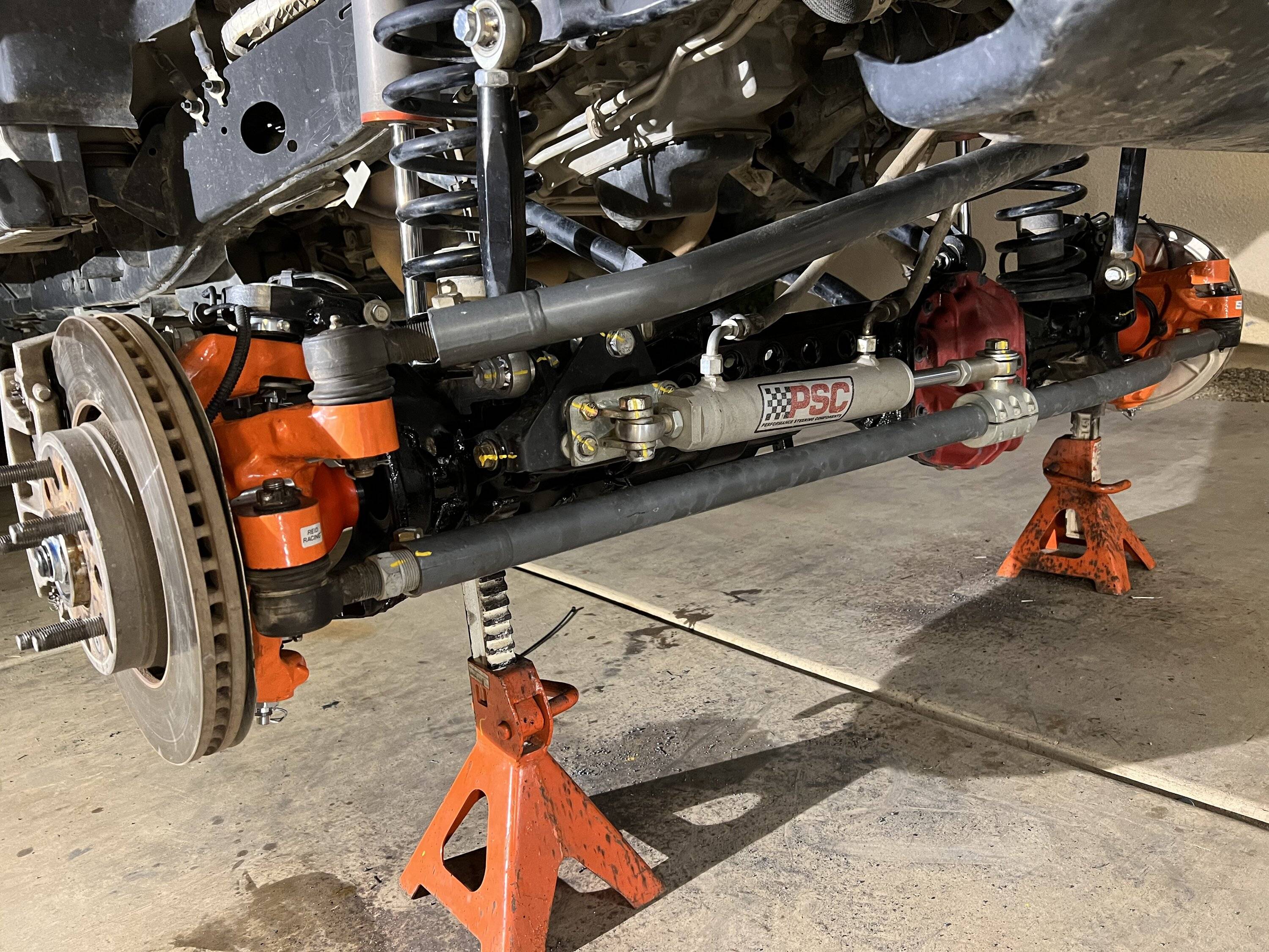

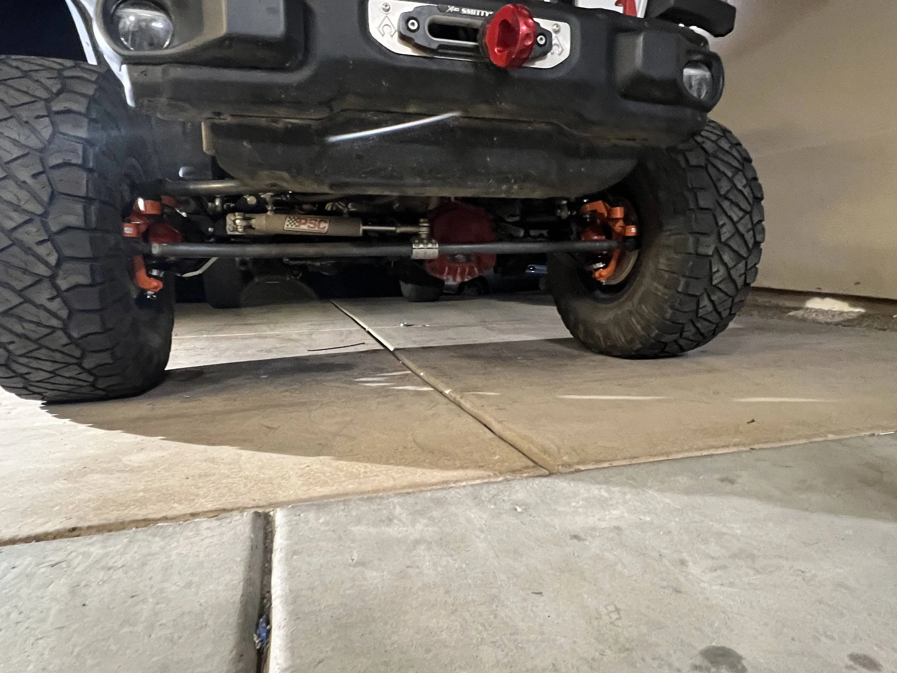

Hello everyone,
I just put RCV axles in my gladiator Rubicon. At the same time I replaced the knuckles with reid knuckles, the ball joints with Danatrac rebuildable ball joints, and Artech industries truss. I went with the one piece axle shaft to eliminate the fad.
After doing these upgrades, when I drive down the freeway at about 60 to 80 miles an hour I get a cavitation sound from the front end. Any ideas?

Fluid level correct in the diff?
The only other thing that I can think of is the FAD delete. You bolted the FAD back in place. Without the sleeve of course. Just have the fork on the FAD sticking into the axle housing. Or you completely eliminated everything?
I completely deleted everything and put a blank plate over the hole for the fad.
That's why you hear it. With out the fad the front drive shaft spins, you will have to remove caster to adjust for that, somewhere in the 4* will probably get rid of the drive line vibrations. Removing the fad is really for more trailer queens as these usually need more caster than is comfortable for highway speeds.
Easy way to check is find a really straight road, toss it in 4h if it sounds the same it's your drive shaft humming away, mine does above 45.

Yes, it has the proper fluid in the deaf as well.
thanks for the heads up. I was hoping it was just something like that instead of a bearing or some other catastrophic issue.
I mean it could be, but it's more likely you are hearing the drive shaft and getting drive line vibrations, especially since it's at higher speeds.
