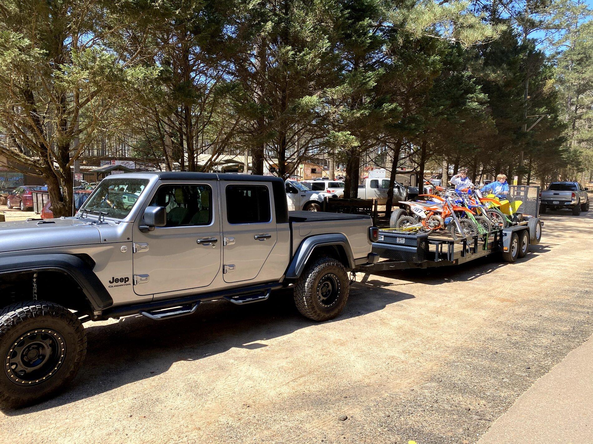

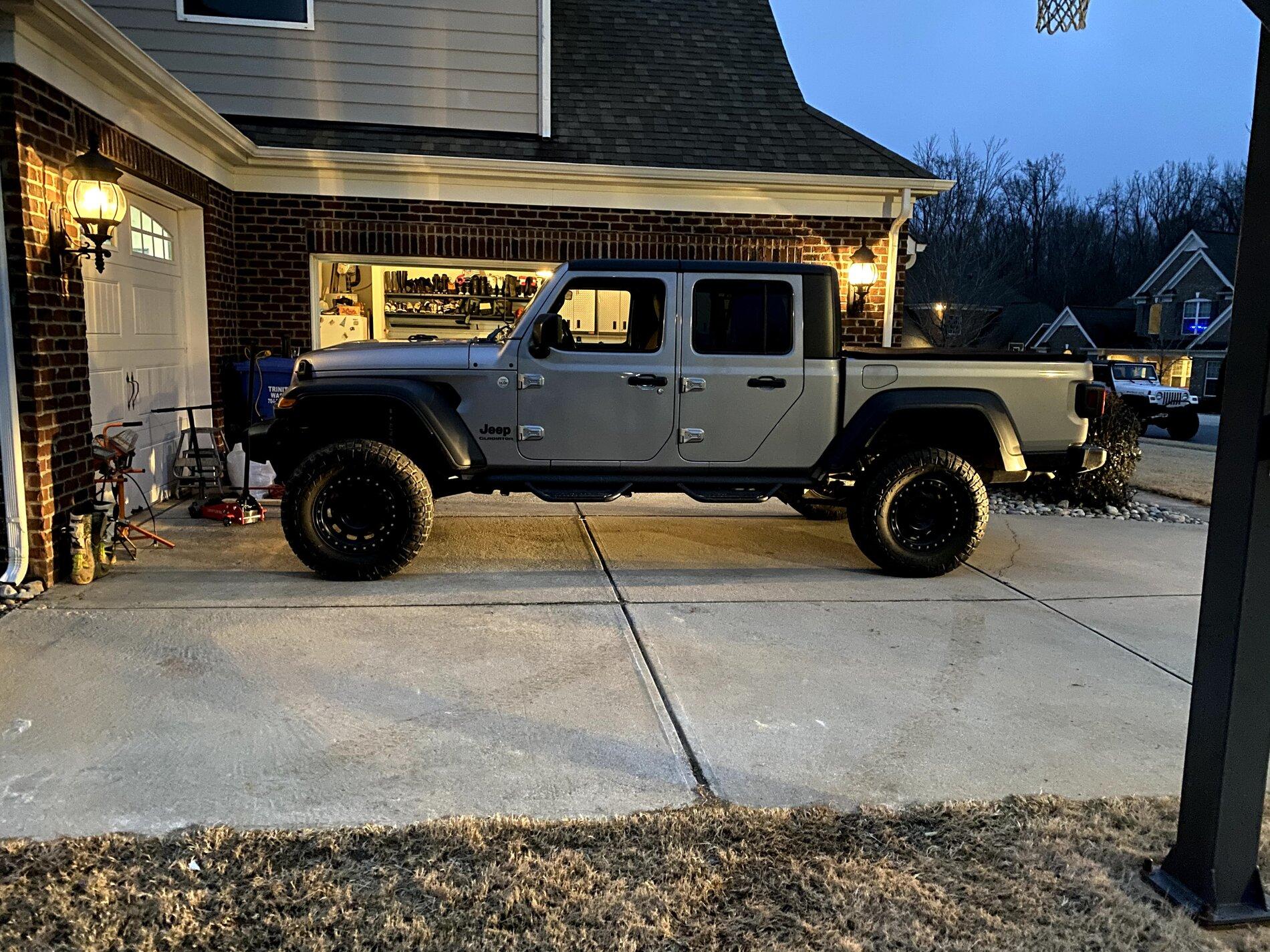

I am pretty much a novice where lifts are concerned but I went with the ReadyLift Terrain Flex 4 Arm kit because it included shocks and lower arms, plus it retained the factory rear springs which was important to me for towing. I was not able to get a good feel for how the rear springs in other kits stacked up for towing applications.
I installed the RL Terrain Flex kit myself and have been pretty satisfied overall. The Falcon shocks definitely stiffened up the ride a bit, but it still drives and rides reasonably on the roads. I also hauled about 4500 lbs of trailer (mind you this isn't the ideal trailer but it was available) and machines 450 mile round trip with no problems at 70+ mph.
As for quality, it seems like the Springs, Arms and Trackbar are all mfg by Terraflex, along with the Falcon Shocks. Of course, only time will tell about durability for the bushings.
