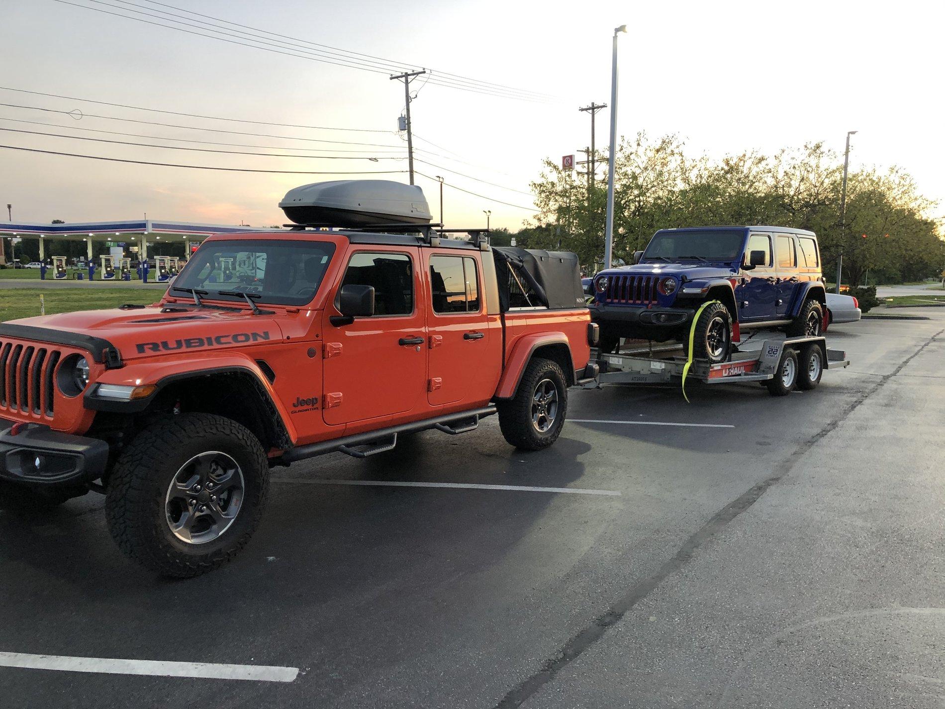

I think you’re going to be fine with the gasser. I towed my wifes JLUR on a dolly cross country and it was fine. You can absolutely tell there’s a heavy load back there but I was able to cruise around 65-70 most of the way. There are a few 6% grade’s where I had to slow down to 55-60. But over all the gladiator pulled way better than I expected. I was right at 7000 lbs in total trailer weight.
