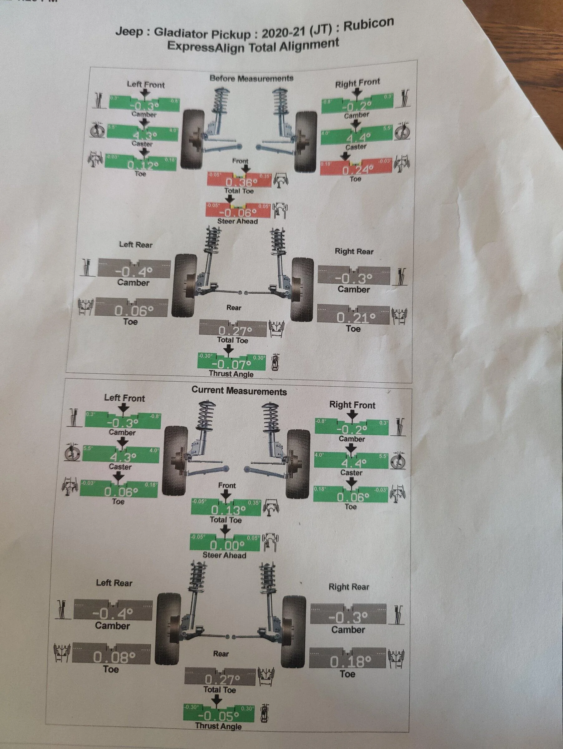

I just got an alignment done after installing a 1.5" front + 0.75" rear spacer lift on my jt. Alignment was free, since I have a year long alignment from when I got my tires.
The front wasn't far off, and it looks good after alignment. But I'm not so positive about the rear. What should toe be?

Here are the alignment results. It drives fine. It drove fine before. Just wondering about the rear toe, and if I should do anything to correct.
It's at .08 on the left and .18 on the right

I think I've answered my own question after a few searches. Rear toe isn't adjustable.
6,308
14,387
There is no adjustments on the rear for camber and toe.
If you have installed adjustable control arms in the rear. You can tweak the thrust angle and the pinion angle.
