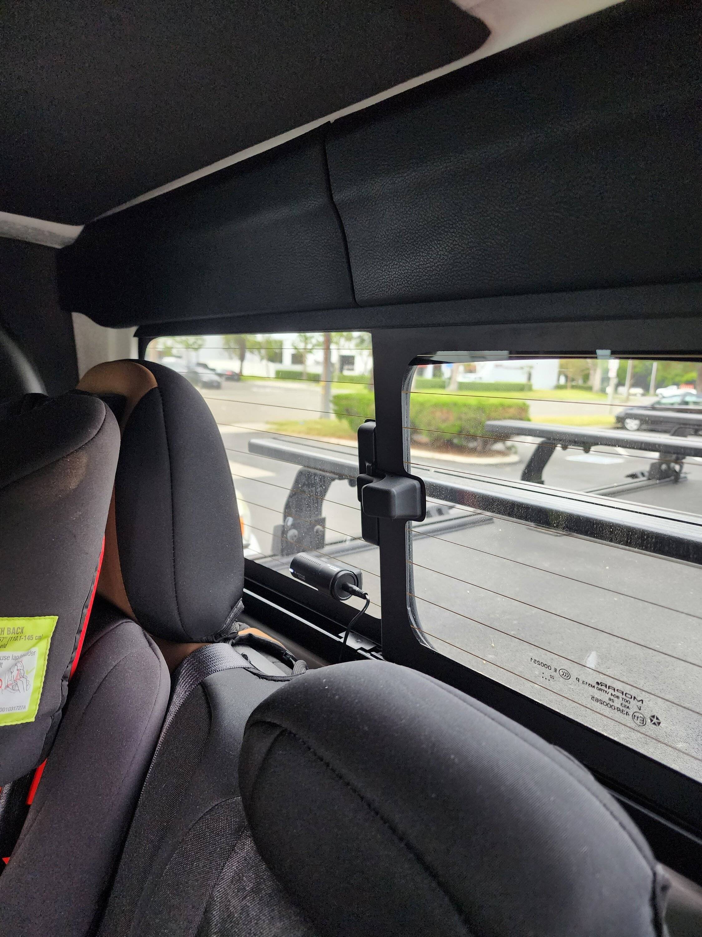

I mounted mine at the rear window. Low enough to see out the back when the tent is mounted on the rails. Easy to just unplug it if I need to.
Like this idea! If the weekend is kind to me, I'll give this a go and post some install pics. Thanks!

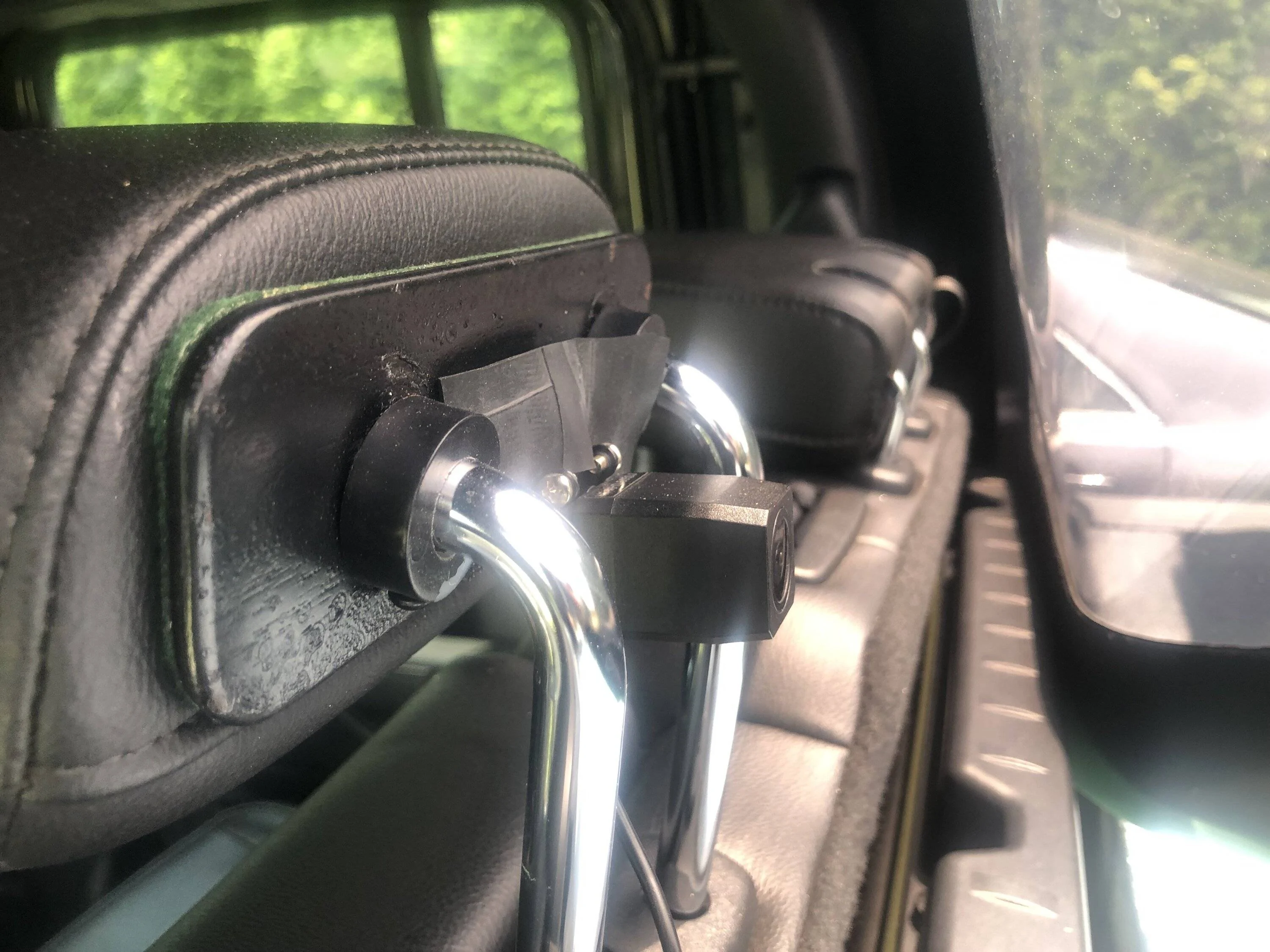

I ended up with two rear-facing cameras and ran the plugs to my dashcam. I can easily unplug one and switch over to the other as needed.
For the first camera, I drilled two holes in a piece of wood and installed the bracket behind the center seat headrest. This allows me to switch between hard and soft tops without concern for the camera. This also allows me to see any cargo in the truck bed, as well as record what's happening on the road behind me:

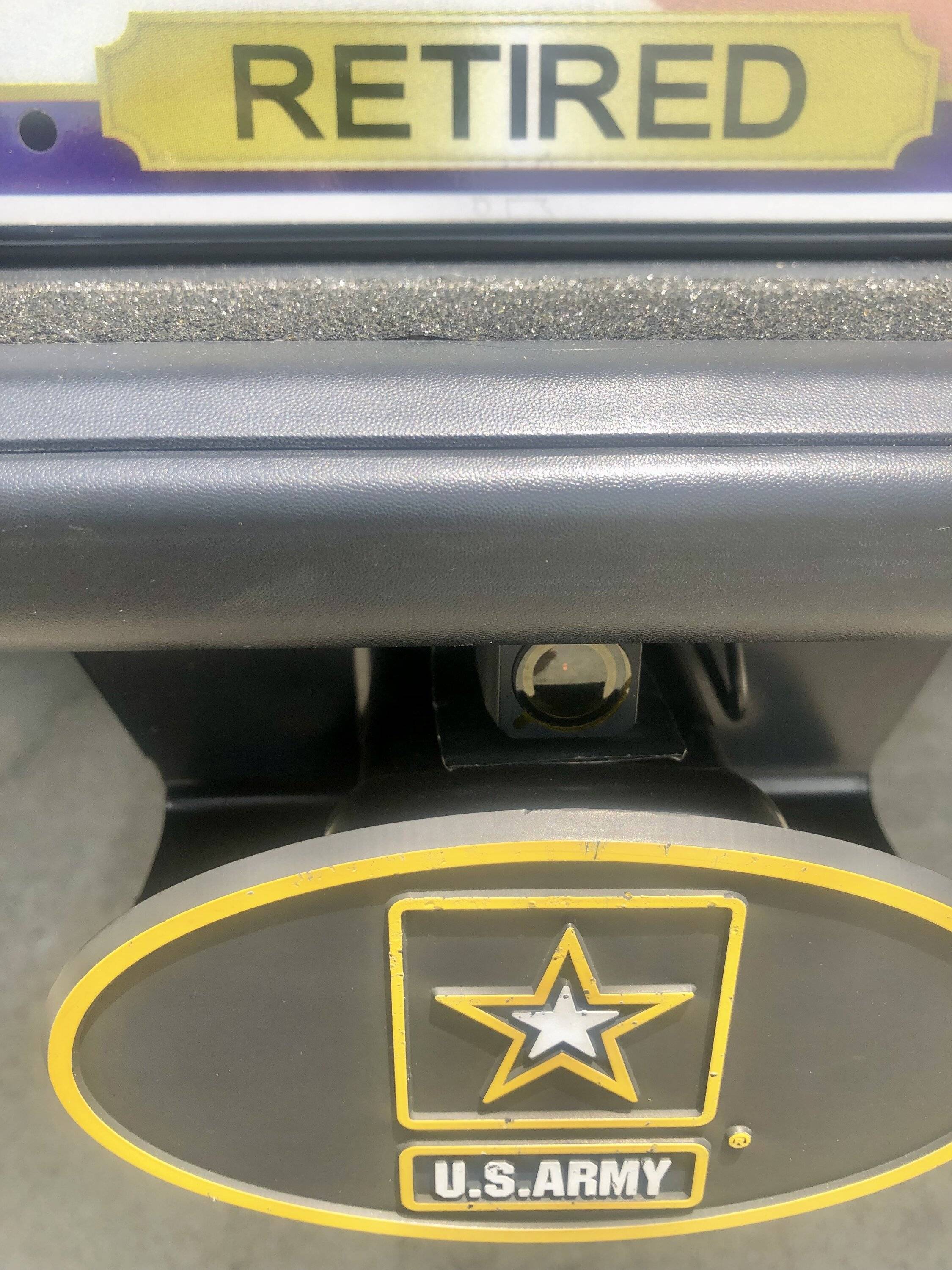

For the second one, which I use most often, I added some magnets to the camera bracket and placed it on top of the hitch receiver.
Jeep Gladiator Rear Dash Cam Mounting Options tempImageioZhqq
