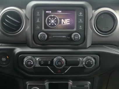

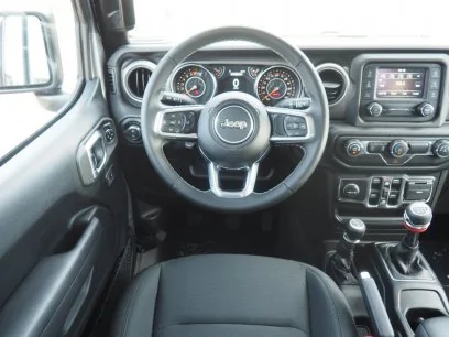

Yeah the base Sport without the heated mirrors, makes me think it would take some extra parts to make this work. Reason I’m entertaining it is that it seems like there are more soft top models out there with larger discounts, however to be honest I haven’t found one just the way I’m looking for either.
Full hard top is about $2k new, which is a less than the difference I’m finding hard top models for, and then you would effectively have dual tops also. Also, no dual top option on the base sport.
base sport soft top
sport s hard top

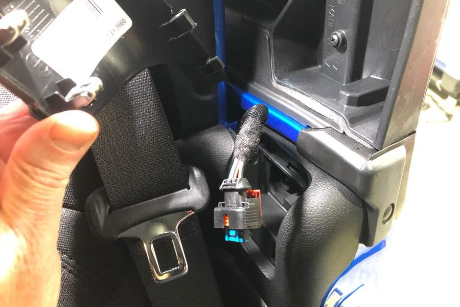

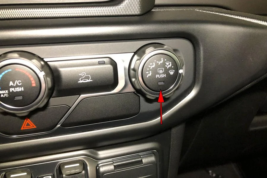

We're installing an OE Hardtop on the Northridge4x4 Giveaway Gladiator (originally a soft top) and this stripped down Sport model has the harness and switch already in.
Rear Defroster Plug is behind little panel on drivers side rear door:
Rear Defroster Switch is in the heater controls:
