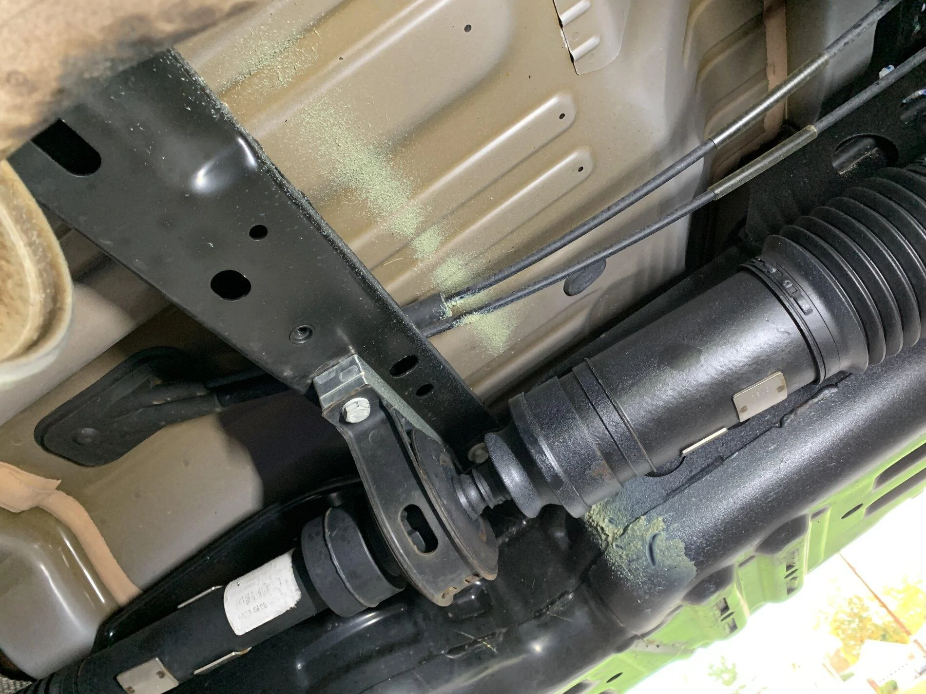

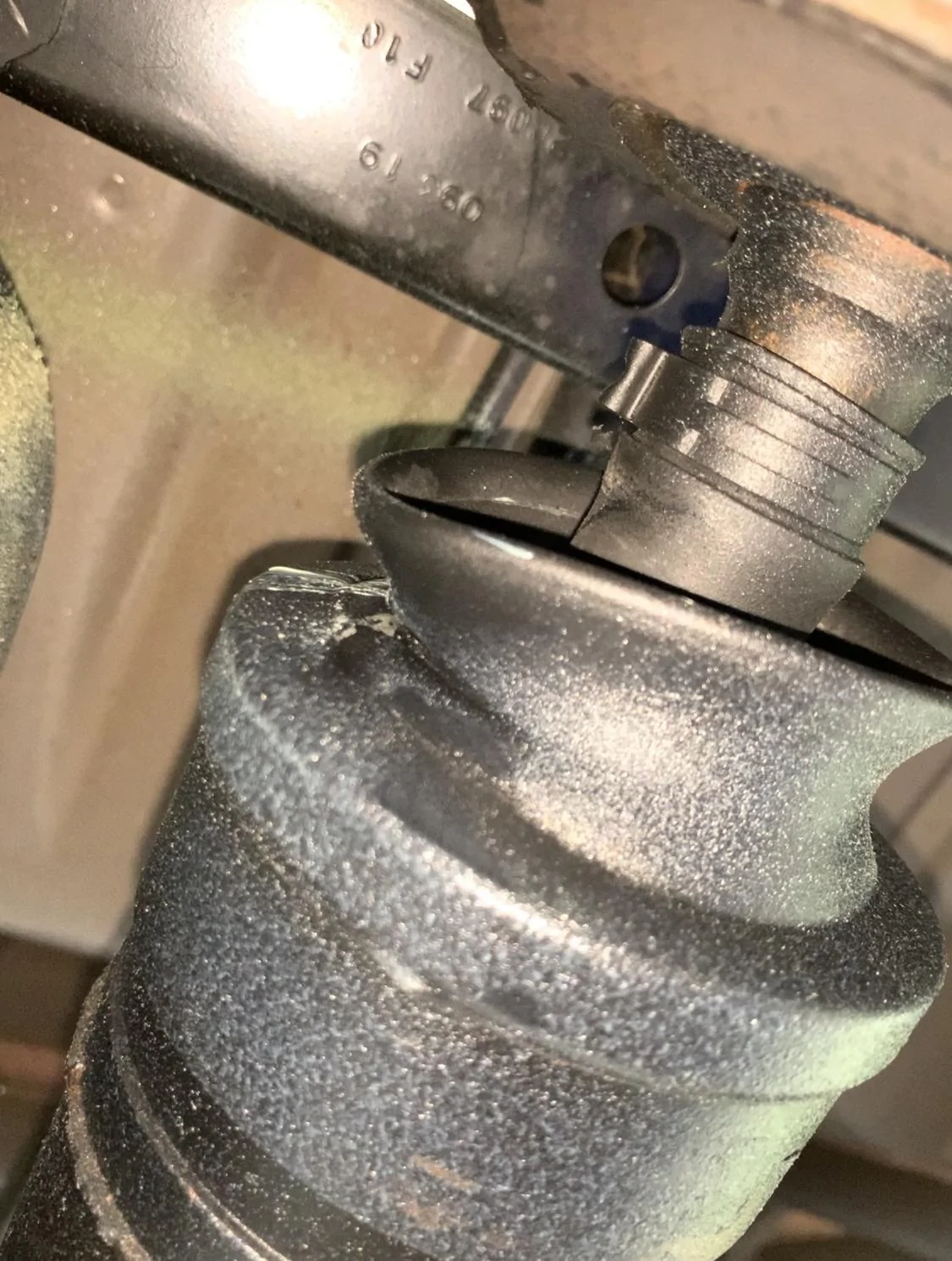

So I’ve noticed some vibration in the last week or so. I know it’s not the tires as they are new in the last 3,000 miles and were road force balanced. I crawled under to check the driveshaft and noticed grease sprayed under the truck in a line. even with the carrier between the 2 sections of the rear drive shaft. It also looks like a part on the end is bent. I am assuming this is no good and the driveshaft needs to be replaced. You can see where grease has sprayed out of the end of the shaft.

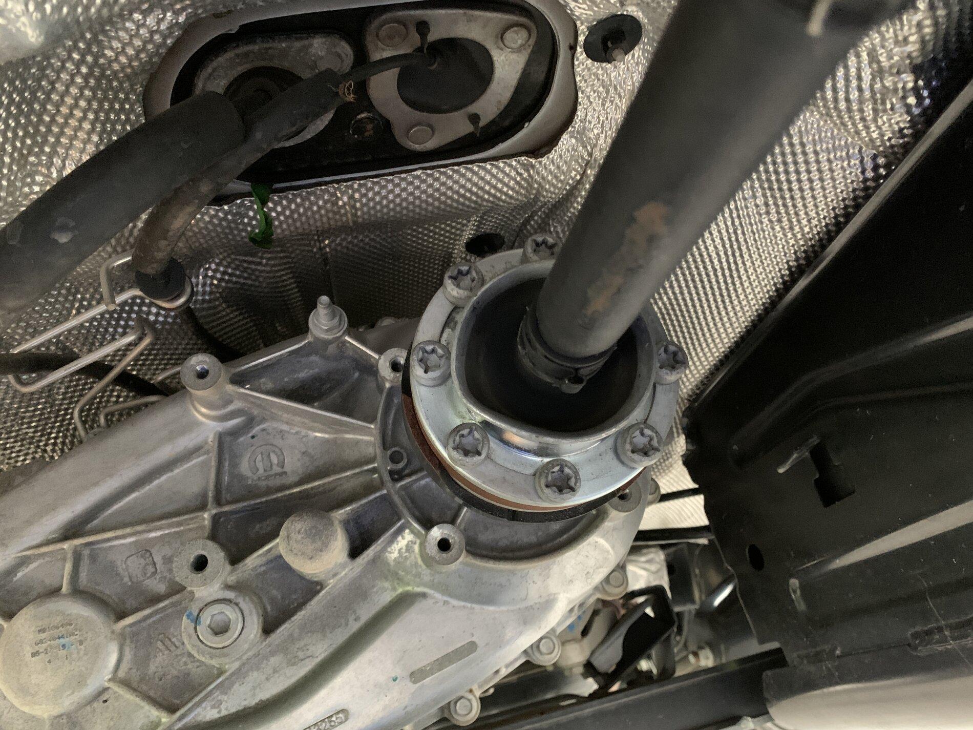

The transfer case end is also bent even though it’s a different section of the shaft than the one where grease is spraying out.

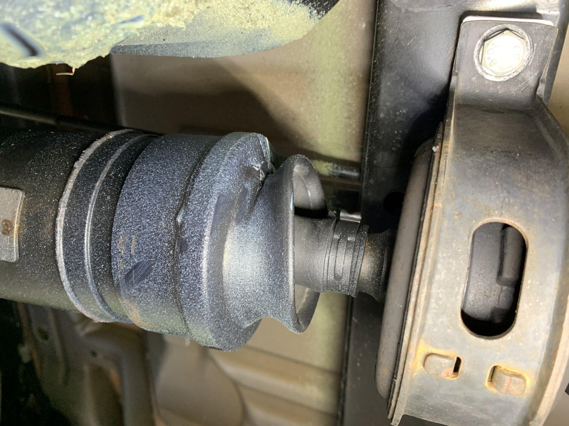

I installed an AEV lift prior to the new tires, hence the spacers under the carriers. There was no grease spraying out then and I definitely did not cause the kink in the flange. I was super careful when I installed the spacers.
I did not do any wheeling recently.

First of all, there’s no way those CV dust seals got bent that way unless each section of the driveshaft was dropped beyond its usual parameters. Has anyone but you worked on the driveline?

Who did the lift, if you did you would know if something happened, like the differential falling off a support and perhaps bending the driveshaft flange at the end of the drop. Might be considered powertrain, would not hurt to ask. I really don't like the design of the driveshaft and someday might get a Adams driveshaft for rear or both....It looks like the shaft hit the collar somehow, but tough to figure it out. If you are out of warranty and have to replace perhaps an aftermarket straight shaft should be considered.

In the last picture it almost looks like the driveshaft sustained a hit, looks like the flange is bent a little and the driveshaft looks scraped in the same spot.

The only other work that’s been done to the truck was a fuel pump replacement by a dealer. The fuel tank gets dropped for that so there’s a chance they had to drop/remove the shaft as well?

I did the lift. I was very carefull with the carrier. I am almost positive I didn’t let it droop far enough to kink the flanges. There is always a chance I damaged it despite being careull but I am fairly certain I didn’t. I went under the truck a few days after doing the lift to check the torque on the carrier bolts and didn’t notice anything out of the ordinary and there was no vibration at that time.
This is possible but I haven’t been wheeling since July and that was just beach driving. I can’t recall hitting anything at all recently. I guess there’s a chance some road debris got kicked up but I would think I would’ve noticed.
In any case it certainly didn’t get bent and start leaking grease all on it’s own. I already have a drive shaft on order. In the mean time should I be worried about catastrophic failure with this? The Gladiator is my DD.

This is most certainly the cause. I was looking at the pictures again and the dust seal on the t-case end is bent exactly the opposite of the rear section of the shaft. The only way that could happen is if the carrier was drooped too far.
So there are 3 possibilities:
1. Dealer that sold me the truck did a shitty job with the driveshaft recall was completed prior to me purchasing the truck.
2. The dealer that replaced the fuel pump damaged the driveshaft during that repair.
3. I damaged the driveshaft installing spacers under the carrier.
