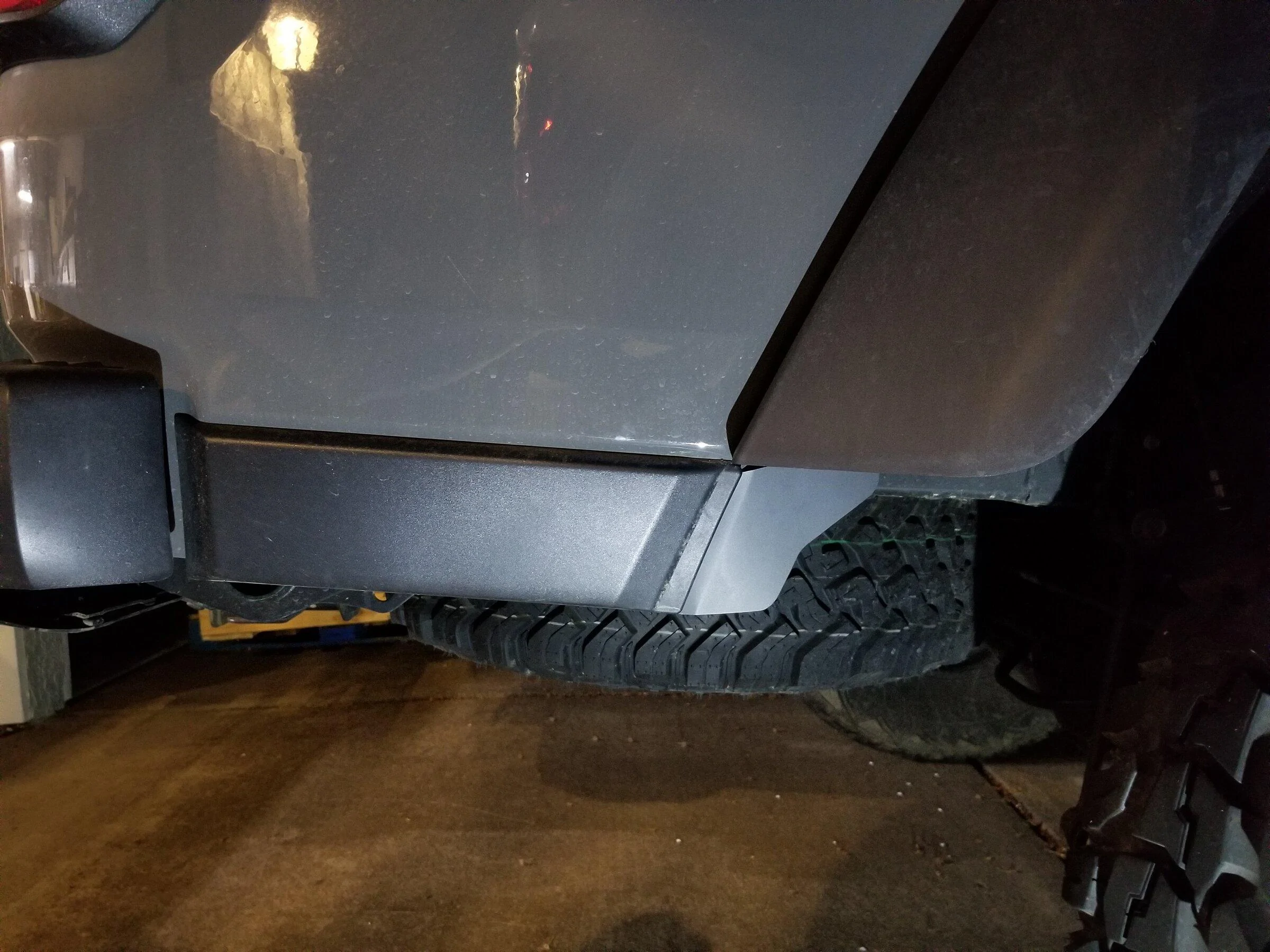

Here's my attempt to making a panel. But the bend towards the underside of plastic trim is what's getting in the way of making this a simple patch. Had to bend it a bit buy now i see i'll have to stack some two sided tape to make sure it's secured.

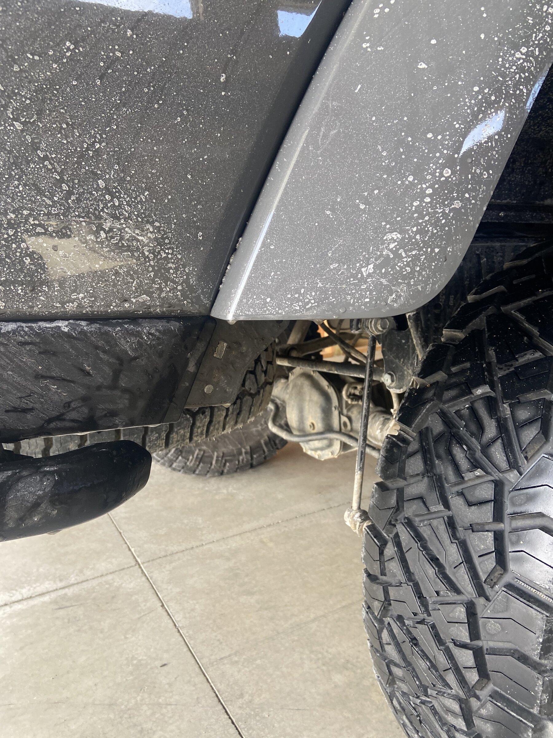

Anyone ever cut that piece of metal off?
I saw a video from [Banned Site] showing his cut back from that point straight across and while it wasn't a "how to video" the outcome was pretty clean looking. I am tempted to just cut this portion off since I am still running the stock rear bumper but was wondering if anyone else has already done this?

This is the video I was referring to. Didn't realize it was a "Banned Site" (he has great content). It only shows the results and I was wondering if anyone here has done either that or just cut the portion that is exposed in the thread above off which is what I was contemplating.

Use the body line as your guide, use good, heavy bodied painters tape to protect the paint, take your time, follow the line. Probably need a file to clean up the edges and then some paint to cover the bare metal.
