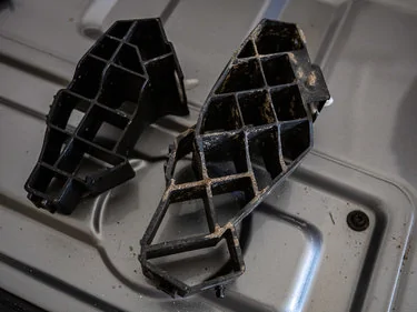

Step Three: Remove the Braces
You'll notice there are two braces still attached to the fender. You'll have to remove both in order to separate the two parts of the fender. Simply repeat the same process used for the other retaining clips with push-button centers.

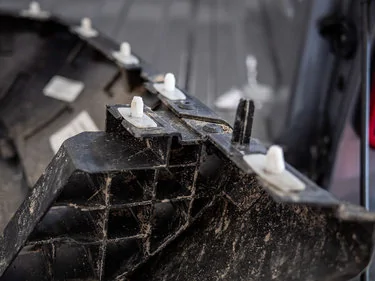

Jeep Gladiator Rear Fender "Chop" {filename}

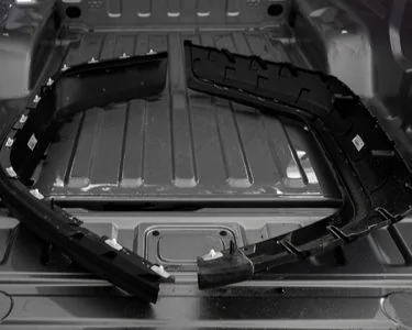

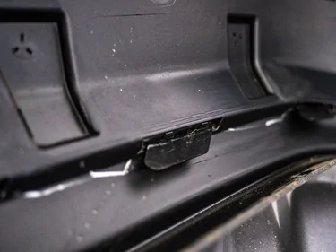

Step Four: Separate the Fender Pieces
Now comes the fun and slightly terrifying part -- separating the two fender pieces. The pieces are held together by plastic welds and secured by little tabs.
Unfortunately, there's no way around this but to forcefully rip the two pieces apart. Try not to flex the outer piece too much, especially if you have painted fenders. If the tabs begin to tear -- and chances are they will -- just make sure the tears do not affect the fender itself. The end result will look like this:

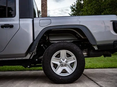

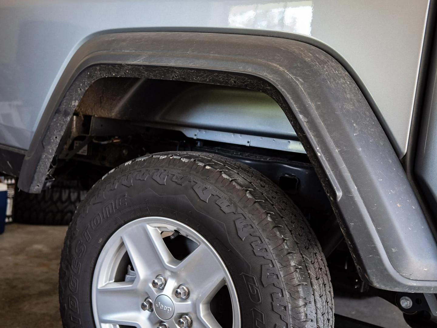

Here are the final results:

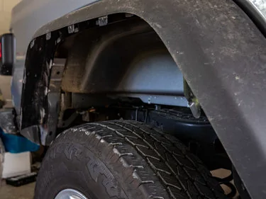

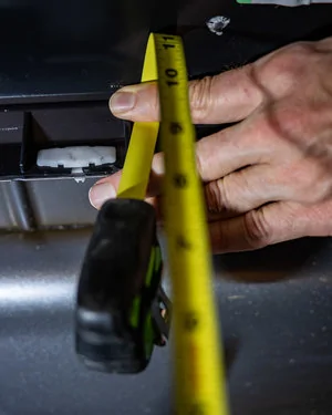

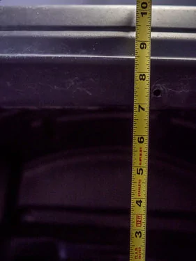

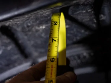

And here are the approximate before and after measurements from the top of the tire:
Inner fender before and after
Exterior before and after
As you can see, separating the fenders on a Sport S w/ Max Tow package nets you approximately 2.5" of additional clearance in the wheel well and raises the fender about 2.75" on the exterior.

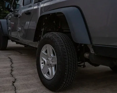

I’m really digging this- do you happen to
Have a before and after look other than the measurements?
I'm glad!
It looks like some of the images I uploaded are missing. You can see all of them here: https://smoverland.com/blog/rearfenderchop.
The best "before" picture I can find right now is the one attached! Just imagine the inner fender is hiding the silver in the wheel well.

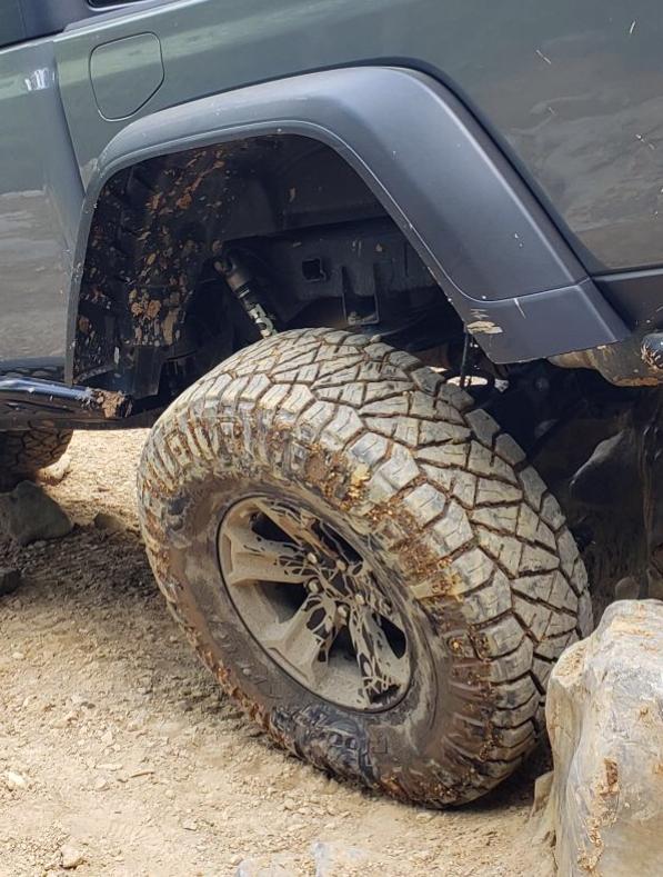

Since this thread has been brought back up, here is a picture of my rear fender “chop.” I trimmed the fender liner, and used a heat gun to reshape it, bending it behind the Inner fender flare. I then used a jigsaw to trim the lower flare. This allows me to run 37s with no additional bump stop spacers, and no rubbing.
