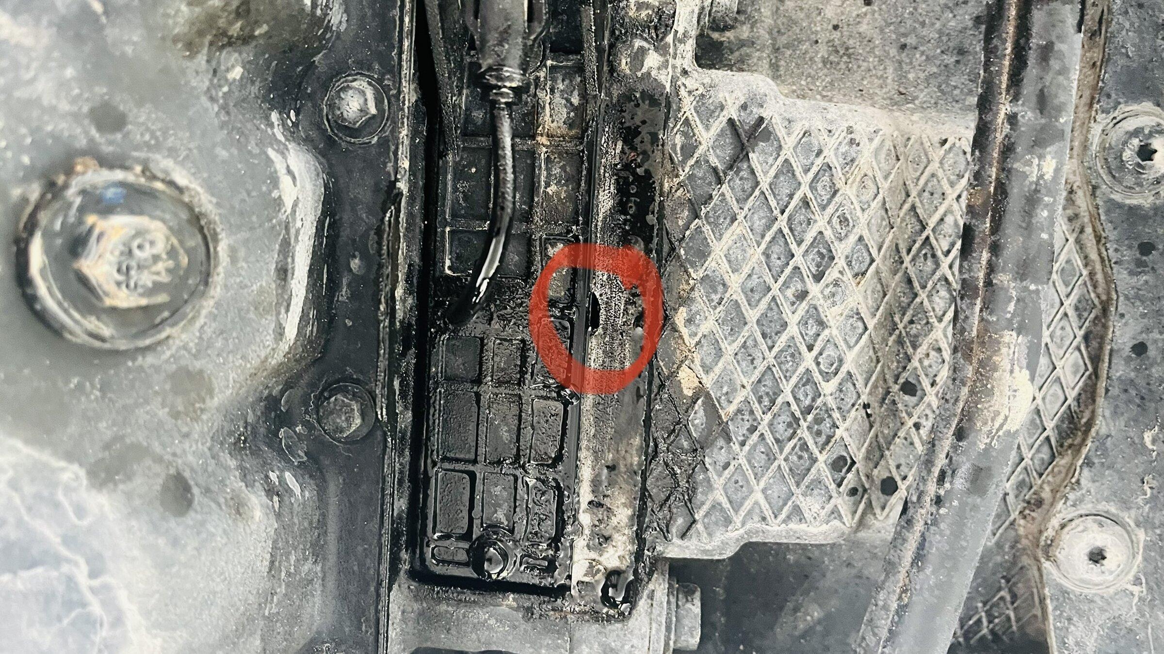

Well sitting in the dealer and was just told the leak I found yesterday is the rear main seal. First time I've heard of a EcoDiesel having this. Of course this dealer doesn't participate in JeepWave so I'm gonna be fucked on a rental and this is my only vehicle. Glad I put trust in Jeep, should have known better.
so has anyone else had to replace their rear main? Here's a pic of where I found the leak. Ignore the circle, where I originally that they problem was.

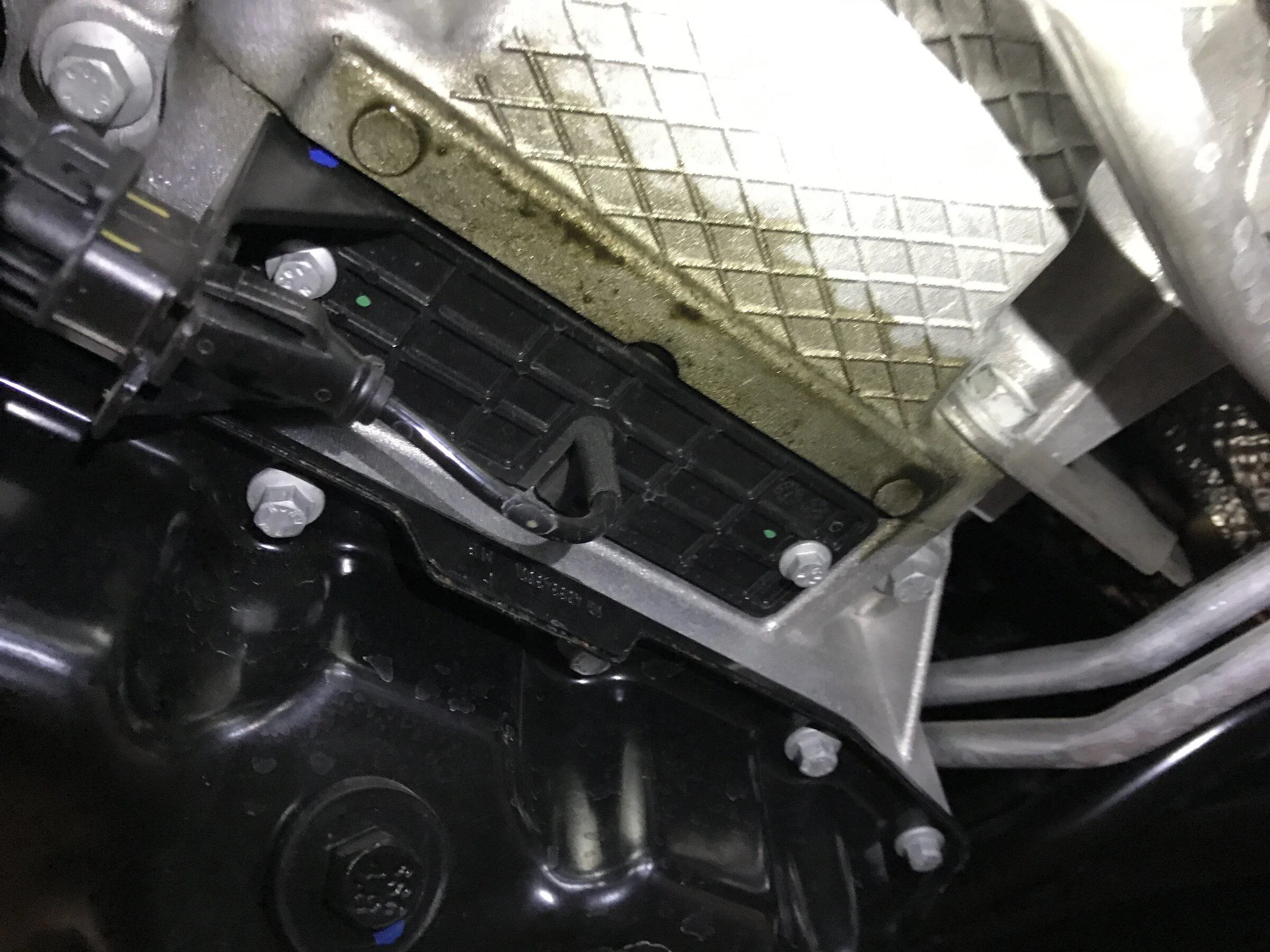

I crawled under the Jeep this morning and found this. The “oil“ is less like oils but feels more like a heavy grease. I wiped it down and going to monitor it. Hoping it’s just assembling grease that’s dripping off
Jeep Gladiator Rear main seal leak? 50A5BA57-7DBE-4A08-93E5-7C270F85588D
under heat?

OP, how is this going for you?
Mine was a pretty obvious drip all of a sudden. Still in the shop, supposedly started the work last Thursday. On Monday I'm going to call in and get an update.

I checked last night and the leak is slowly coming back. Like I said, it’s not oily. Thick, almost like grease .

Got mine back and have had no leaks since(knock on wood). Tech told me it was because something was shoved up against it. The week previously I did have to get pulled out after being pretty badly high centered so that would kinda check out. Makes me want to put skid plates as my next modification.

The rear main seal is on the crank and that black thing is only a cover and only keep dust out. I dont thing you getting high centered had anything to do with it.

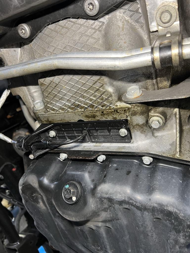

Doing a routine inspection today, found that I too may be leaking from the rear main seal.
