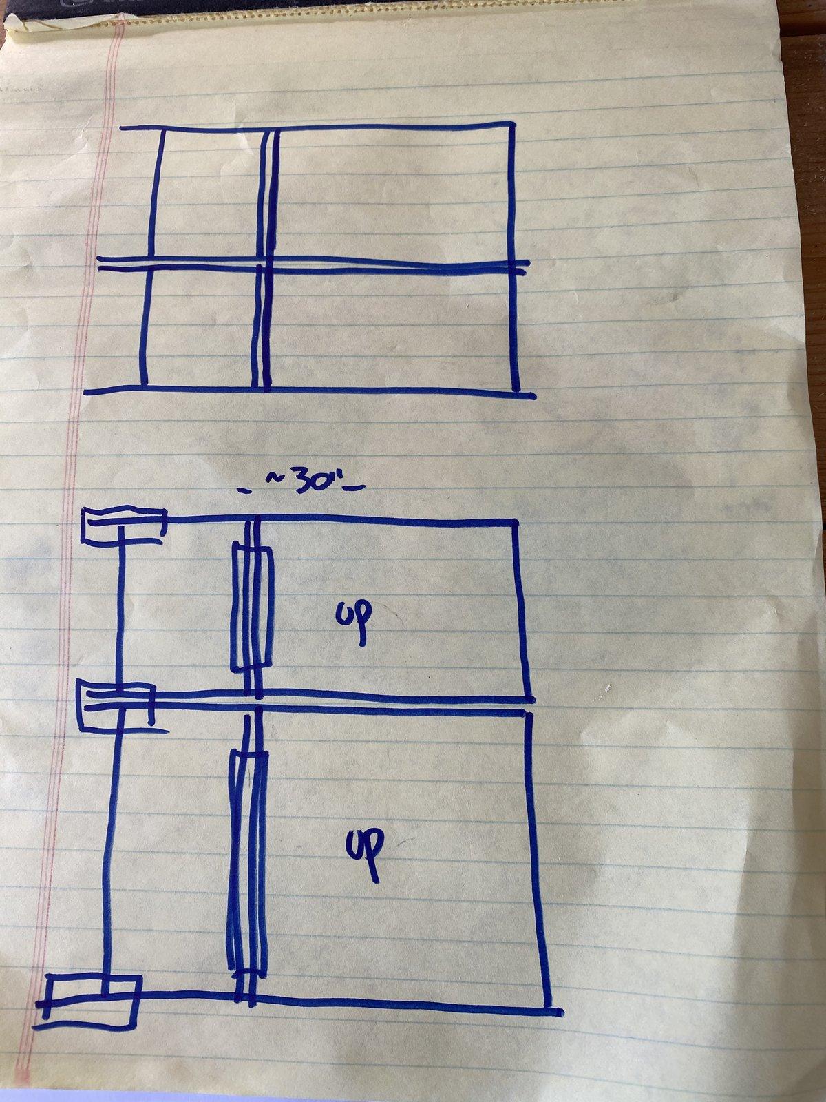

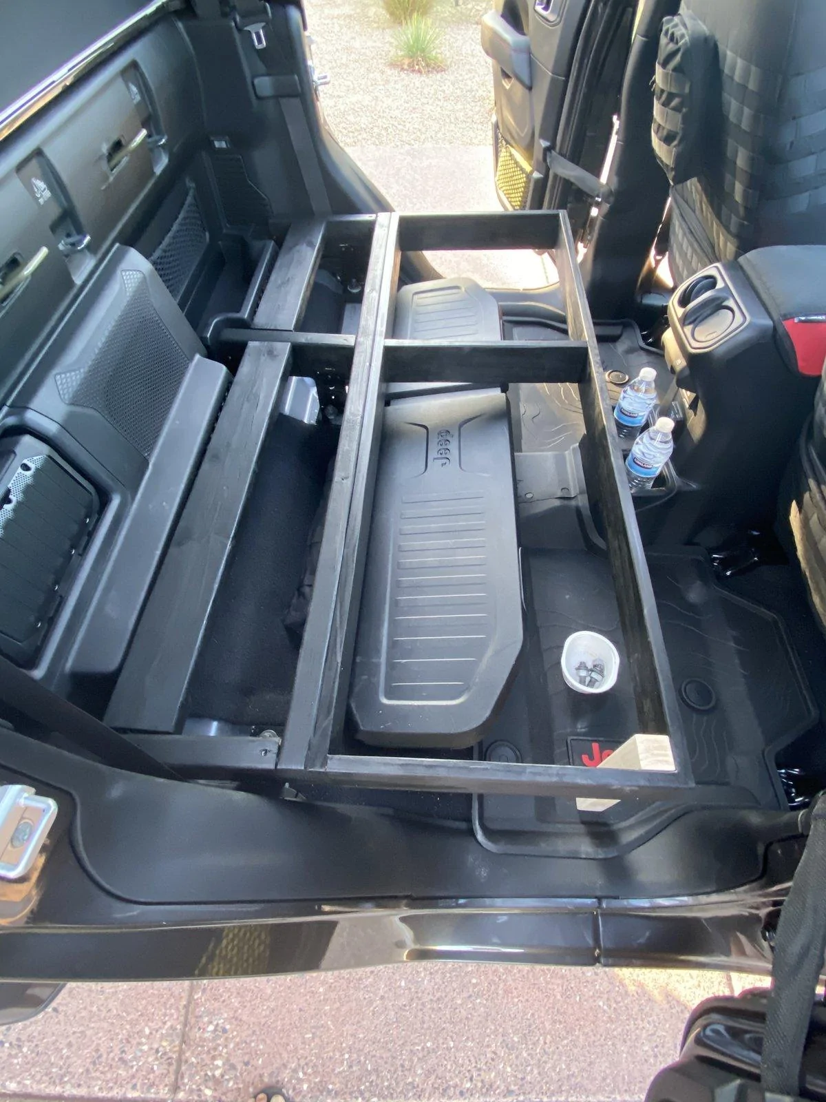

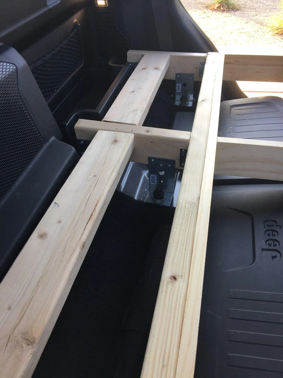

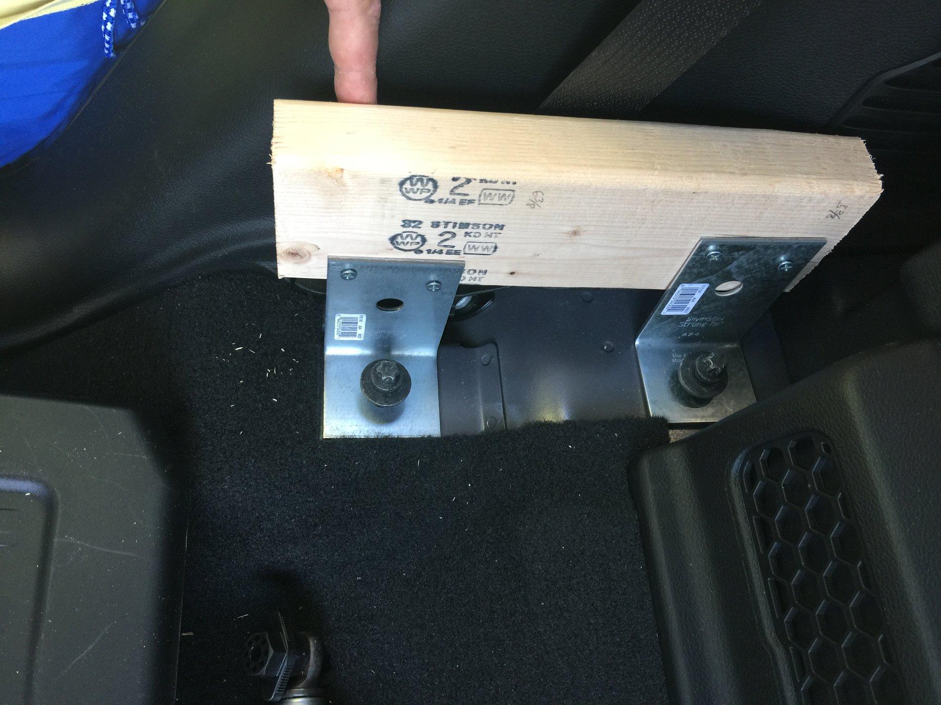

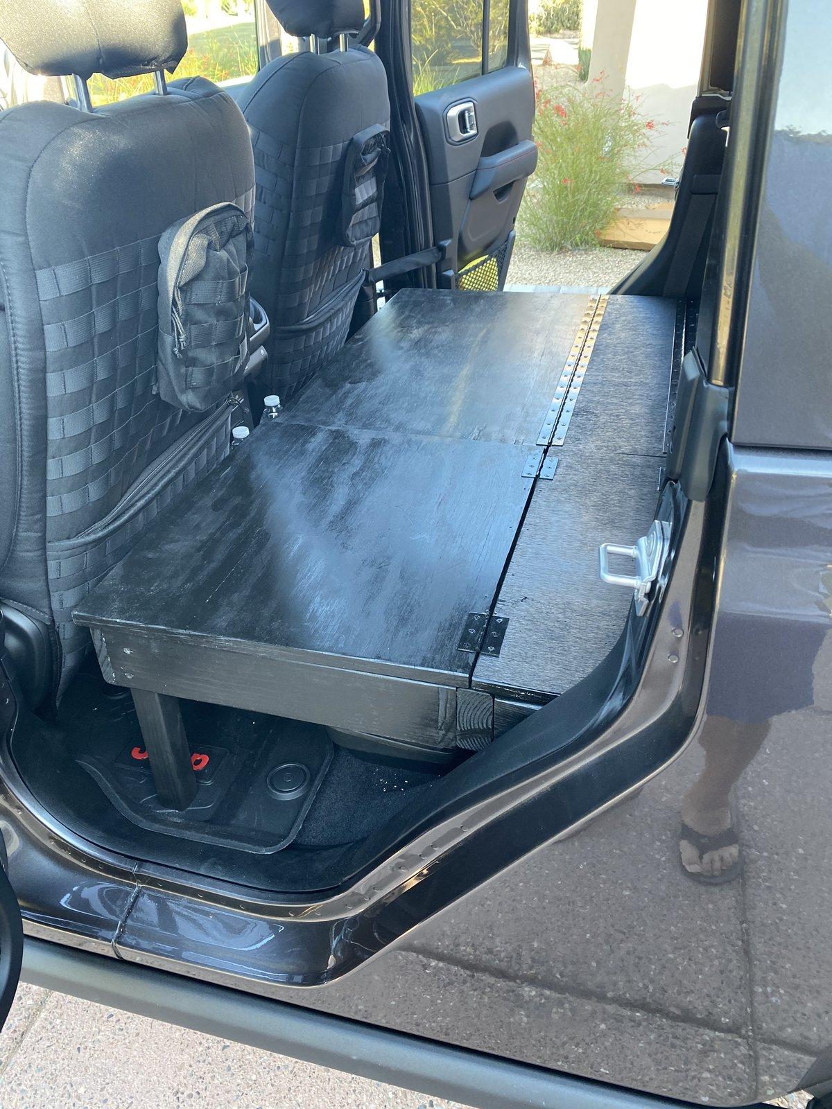

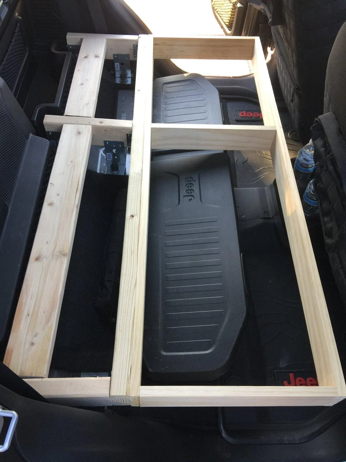

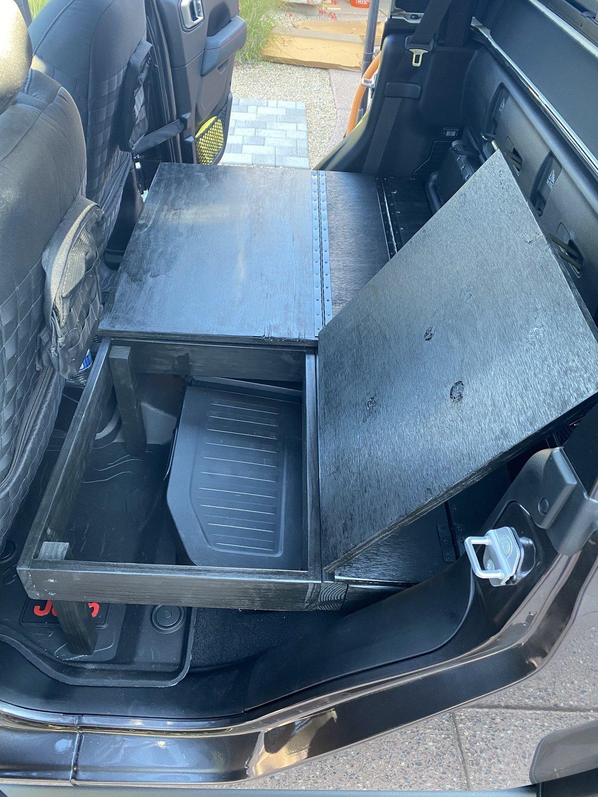

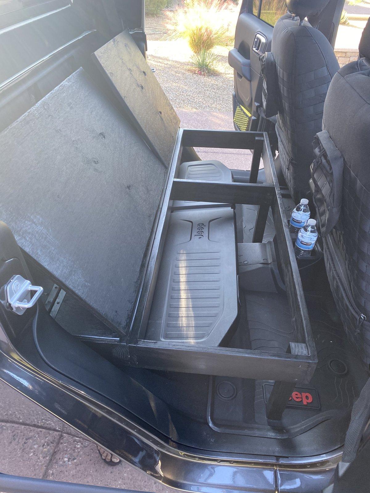

In this thread I'll show you how I built a Rear Seat Platform that provides access to the storage containers on the floor as well as the bolts used to secure the platform to the Gladiator's floor (same bolts used to secure the Rear Seats to the floor).

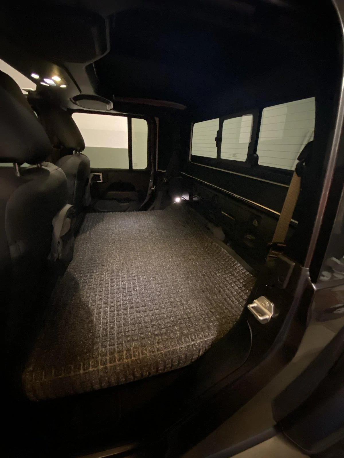

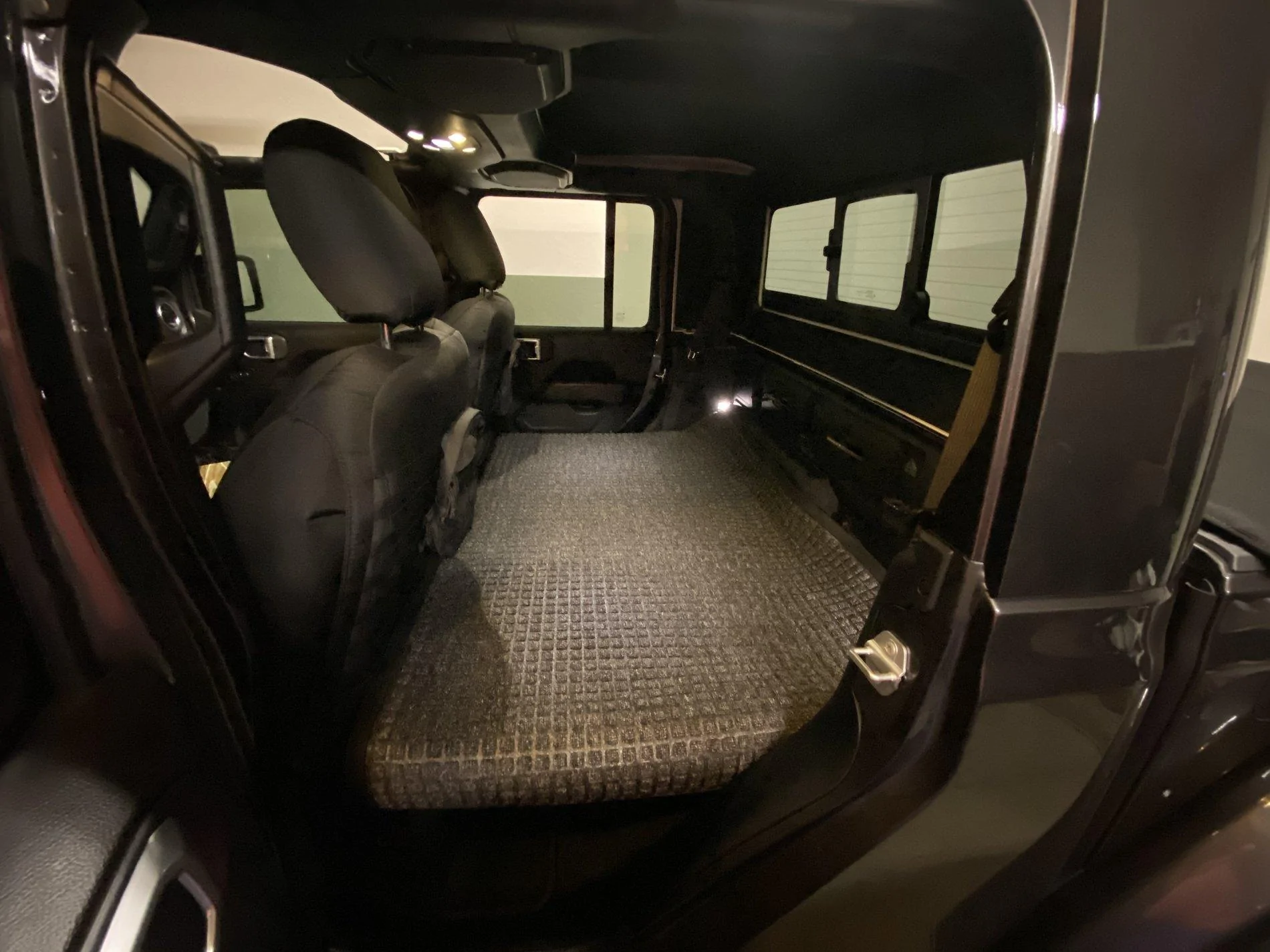

Here's what the Rear Seat Platform looks like now (nearly done except for trimming of the mat on the Platform):
Lots of flat storage space!
