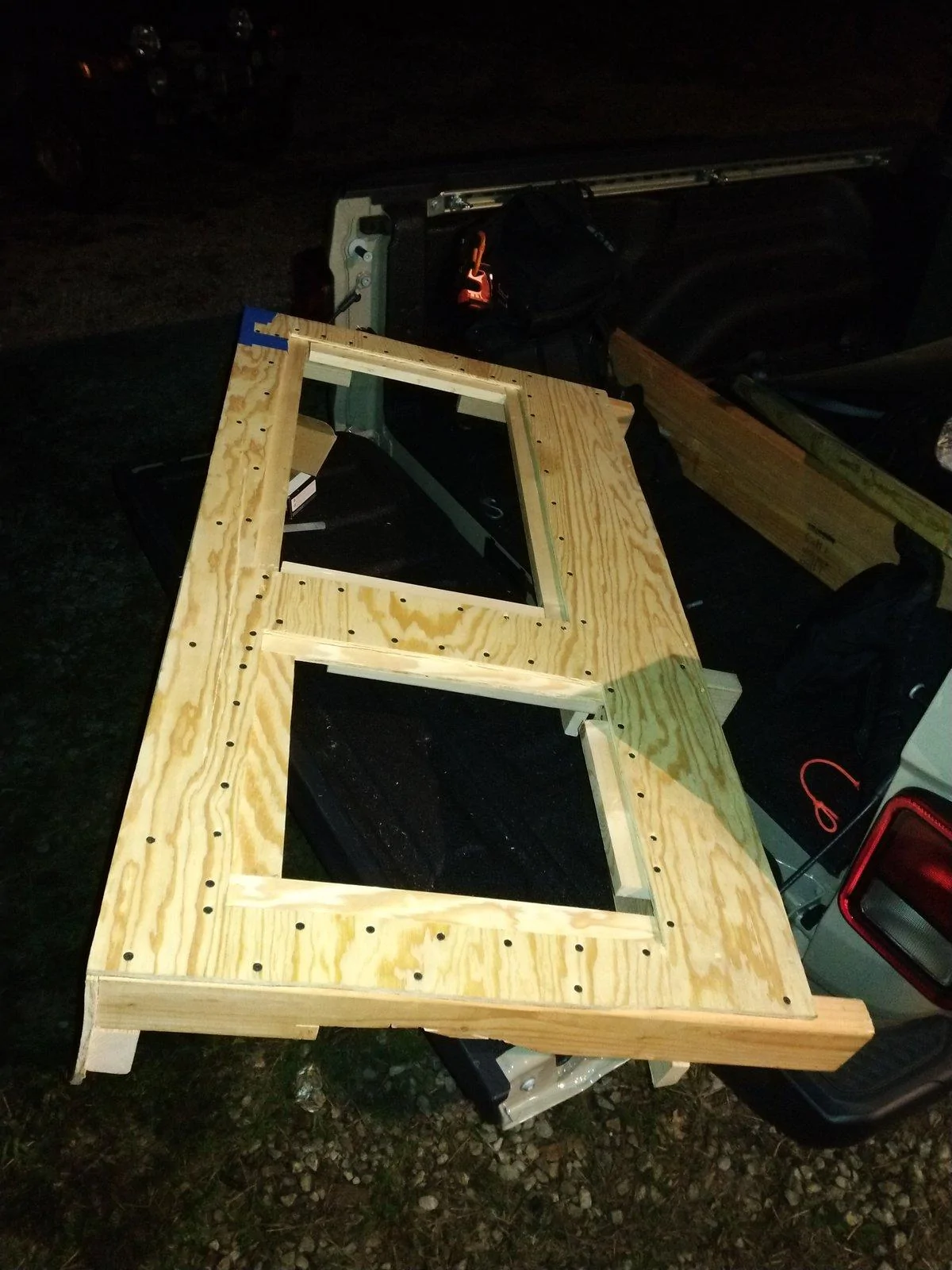

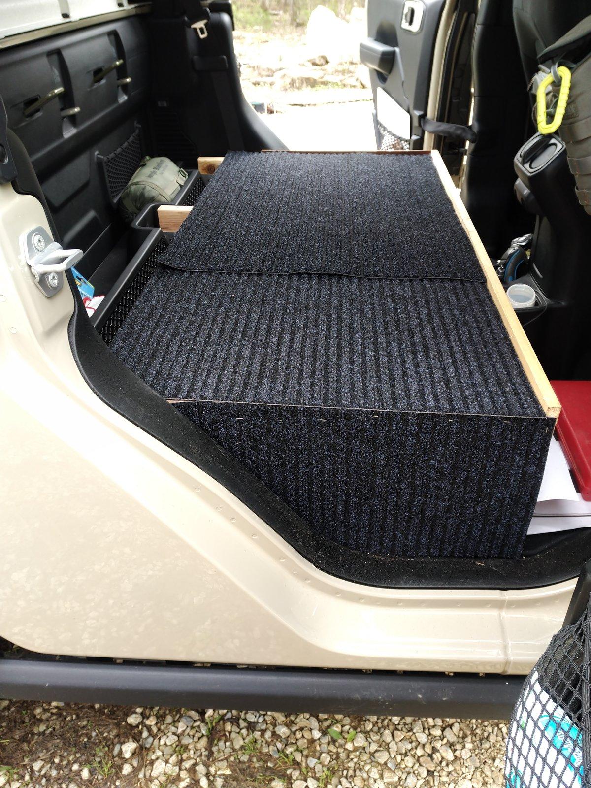

Thanks for your work, write up and photos. I built mine similar to what you done. But slightly different and shorter. I left the tray in back. No hinges used I did drop in panels with finger holes to lift out, used 2 Lowe's door mats for covering. I should have cut the panels using a square and tape measure so that I could throw back in either direction top or bottom to. I left drive side in finished. I might cut back that side and re-install the single seat or have it so I can. First picture was as work in progress. I'll probably go back and make new longer brackets for the rear. If not, possibly redo it out of metal.

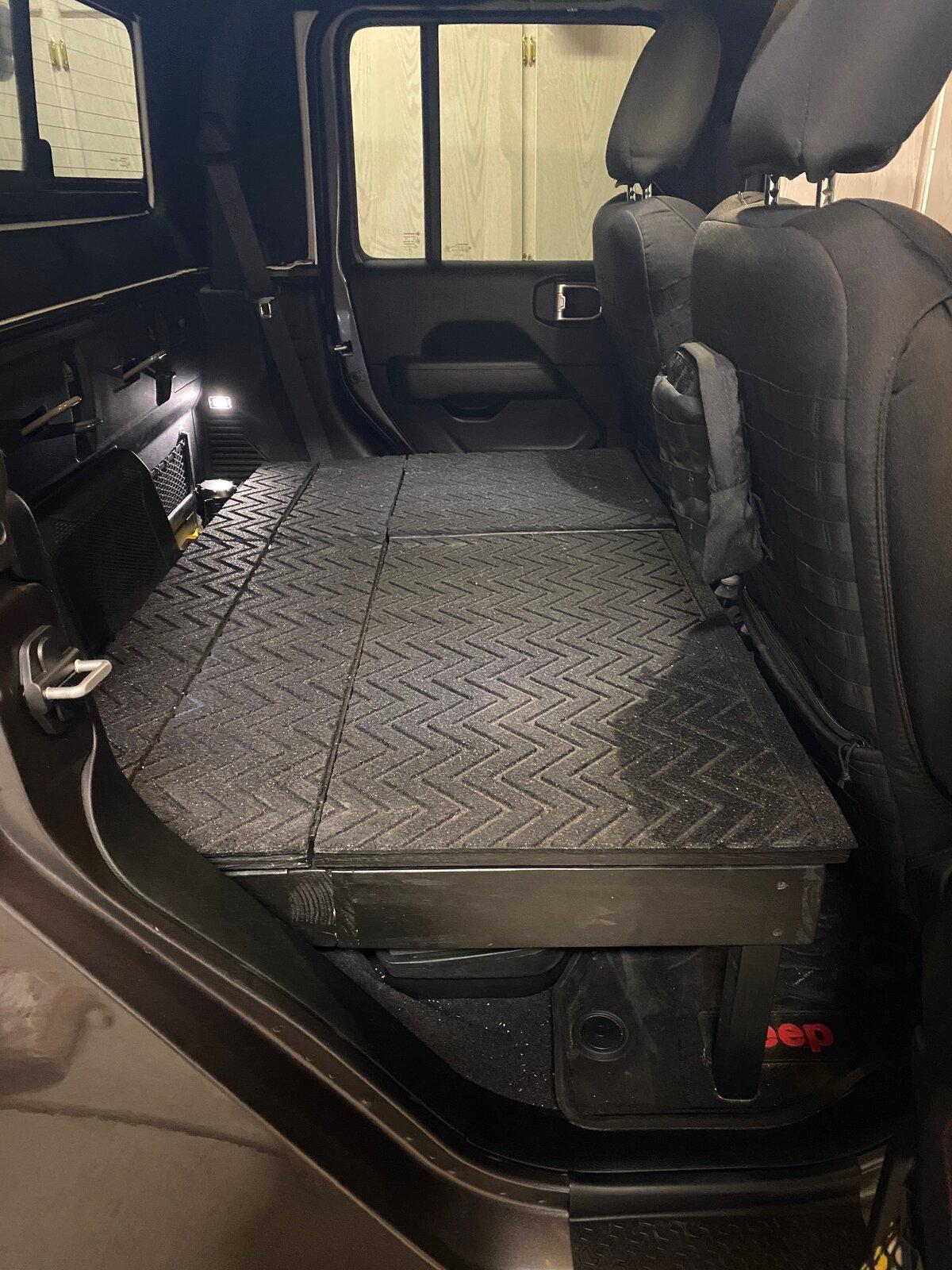

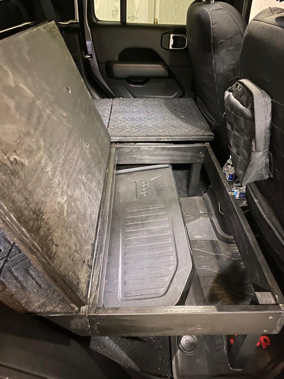

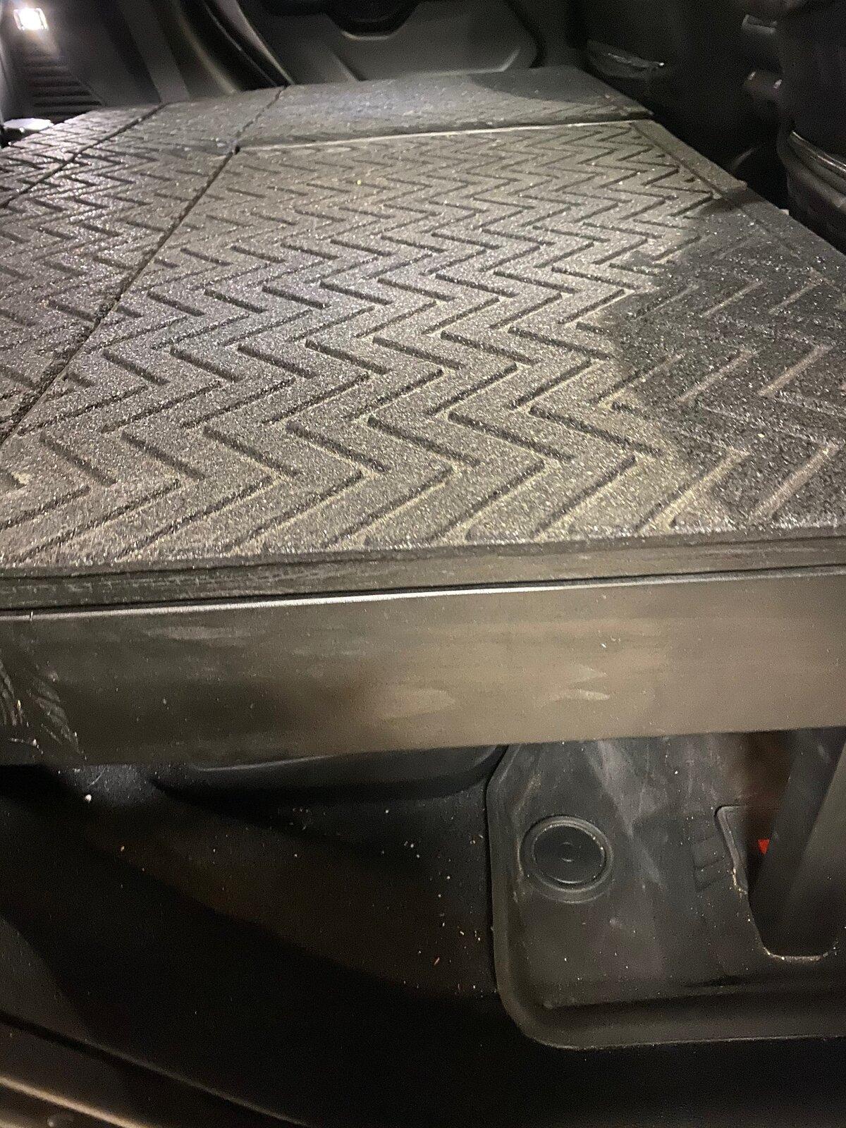

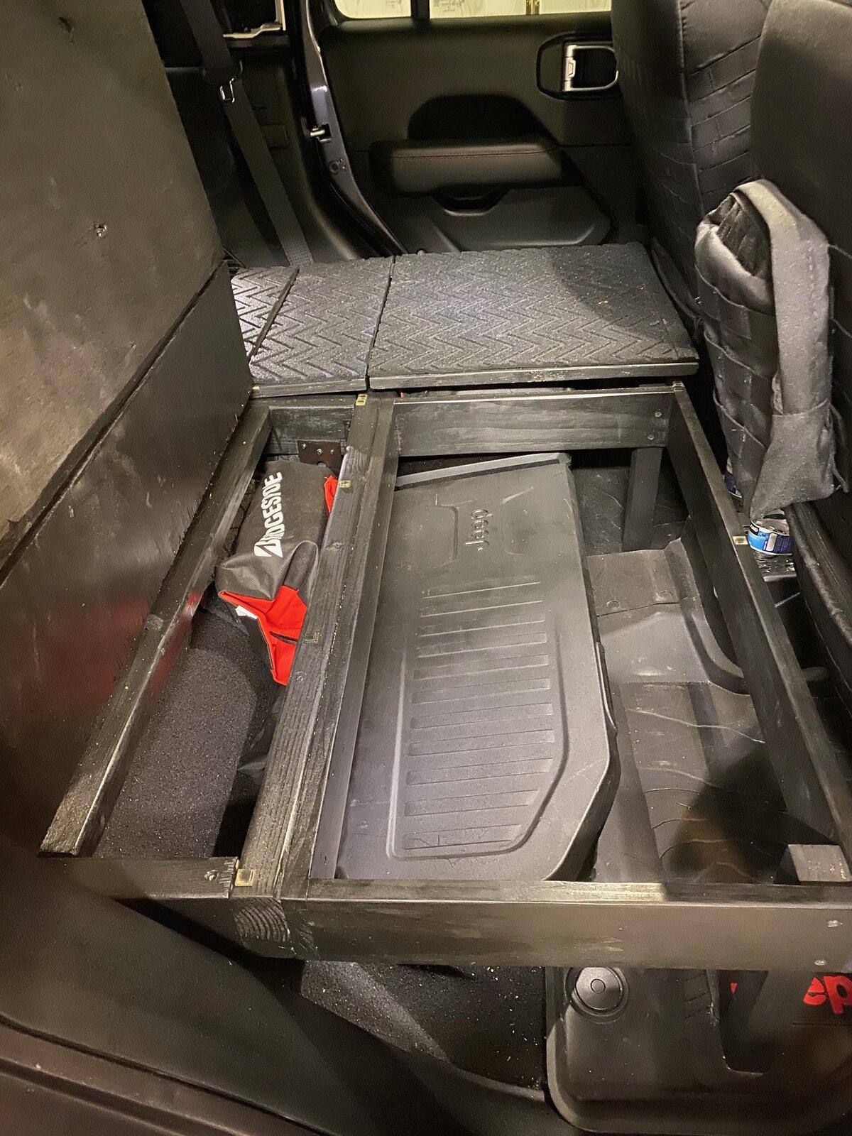

In my previously posted thread I explained how to remove the rear seats:
https://www.jeepgladiatorforum.com/forum/threads/rear-seats-removal.22980/
In this thread I'll show you how I built a Rear Seat Platform that provides access to the storage containers on the floor as well as the bolts used to secure the platform to the Gladiator's floor (same bolts used to secure the Rear Seats to the floor).
Here's what the Rear Seat Platform looks like now (nearly done except for trimming of the mat on the Platform):
Jeep Gladiator Rear Seat Platform (After Rear Seat Removal - Rear Seat Delete) IMG_20200325_131627
Lots of flat storage space!

Not sure I posted the revised platform cover - a floor mat I purchased at Lowe's...
Jeep Gladiator Rear Seat Platform (After Rear Seat Removal - Rear Seat Delete) Jeep Gladiator rear seat platform - 1
Passenger side panel up...
Jeep Gladiator Rear Seat Platform (After Rear Seat Removal - Rear Seat Delete) Jeep Gladiator rear seat platform - 2
Passenger side both panels up - fully open...
Jeep Gladiator Rear Seat Platform (After Rear Seat Removal - Rear Seat Delete) Jeep Gladiator rear seat platform - 3
Close up of mat...
Jeep Gladiator Rear Seat Platform (After Rear Seat Removal - Rear Seat Delete) Jeep Gladiator rear seat platform - 4

Thanks! Not going to enclose the base - I can put a lot of additional stuff in/under there and remove it when the platform is packed on trips. There's all kinds of room in the footwells and under the front seats and I can access that from the back doors
