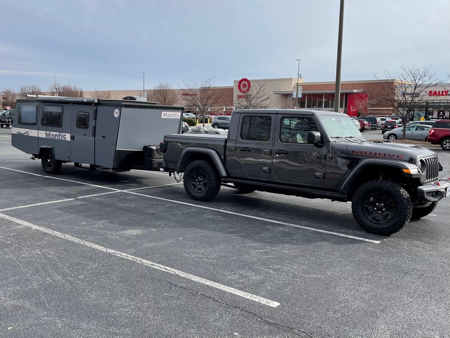

Looking to eliminate squat when I hook up my 3000lb travel trailer.(listed at 400lbs tongue weight). Looking into air bags but also saw Jounce springs? Timbren makes a rear suspension enhancement system. Supposed to be easy to install with little maintenance and super durable. I get how air bags work but is this just a bigger bump stop that will change the unloaded ride? Only haul the trailer once or twice a month so don't need much. Squat isn't bad but you can see it. Anyone have any experience with either option for this scenario?

Although I replied earlier, now that I'm looking at the photo my thought is "huh".
The squat is so small that I'm sure the truck drives fine. So the question then becomes, why do you want to bother?
Is it aesthetics? Is this something you tow 5000 miles per year?
Given the very very slight sag, I'd say do nothing in most cases. Or use a weight distributing hitch and leave the truck alone.

The reason in my case is to prevent getting flashed by blinding after-market blue high beams when I tow. The LEDs are 100% correctly aimed. I checked using the process and then even had the dealer check and they are fine, but with a 500 pound tongue weight, coming back on a 3 hour drive after dark last fall I got flashed by roughly 1/3 of the vehicles coming from the other direction. when not towing I might get that 1 time every 3 or 4 months.
I wasn't even thinking about air bags and prefer to avoid any such things but it's crazy with these trucks the slightest drop in the back and you get people thinking you are purposely running high beams.
And that's with only 500 pound tongue weight.
