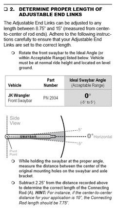

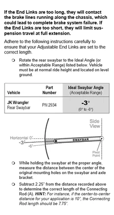

My first thought is “set the links to have your sway bar parallel with the ground on a level surface.” I did a few minutes of research and came up with this...maybe it helps. Pay attention to which photo is for front and which is rear. It is indicated in the literature.
Jeep Gladiator Rear sway bar end links how long 7227E50D-A064-481B-9ECF-21942180A765
Jeep Gladiator Rear sway bar end links how long 25CB5E92-0F66-44AB-971B-C2046E318398
