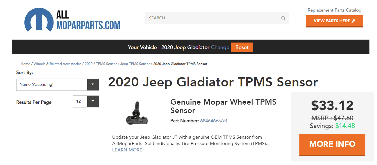

I see that the valve stem is slightly different so now I see that like the stock rims, my spare doesn't have TPMS. That's a pretty dumb design for a vehicle with a full sized spare. So, is this plug and play? As I am reading here, it looks like all I need to do is buy one, install it and the sensors will pick it up, is that correct?
OEM 2020 Jeep Gladiator TPMS Sensors - AllMoparParts.com
Jeep Gladiator Rear TPMS receivers (not getting signal) 1612184612184
