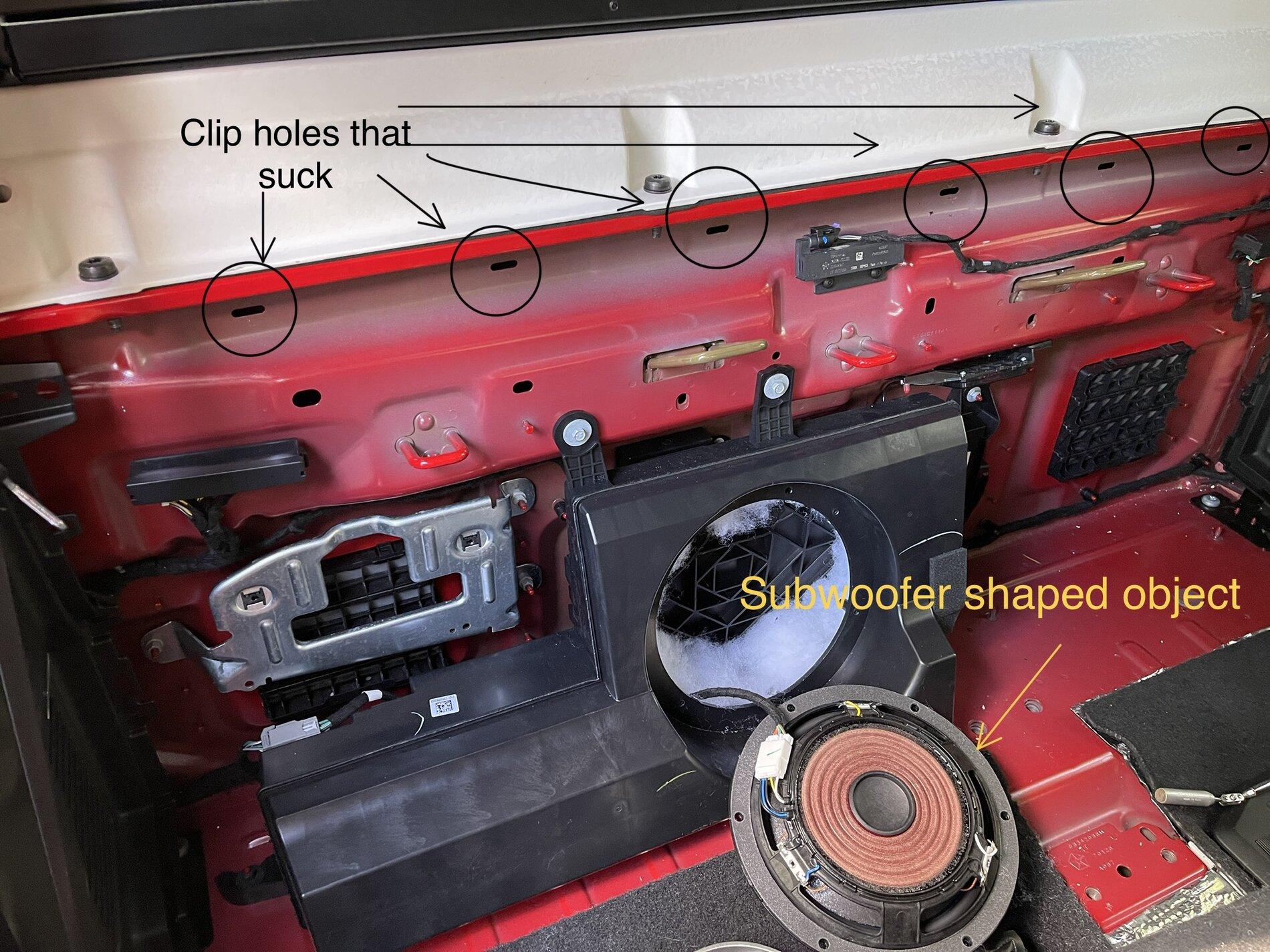

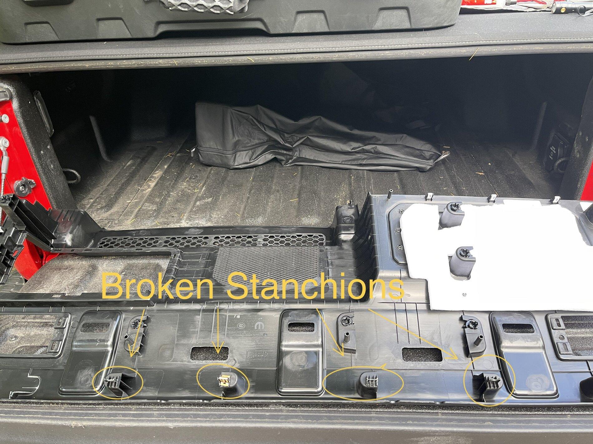

The clips at the top go through the back wall of the cab. In my case the plastic stanchions at the top of the panel all broke. I used trim tools. I pulled straight back and applied finesse. They still broke. I even tried going in with needle-nose pliers to loosen up the clips. So far the Jeep has been pretty good about clips/trim that come apart and go back together well, unlike the old TJs which were brittle crap. These 6 clips are the exception. Once several were broken I pretty much stopped caring and pulled the rest out so I could get to all the broken bits. What a PITA. I officially hate E bolts.
In my case I was left with several metal clips in the back wall of the cab that fell though into the void. That should make for a nice rattle down the road.
Rather than replace the panel ($250 here: https://store.mopar.com/v-2021-jeep...s-pillar-cowl-1-4-panel-trim-and-cargo-covers)
I put some weather stripping along the back so it wouldn’t rattle. We’ll see how this Jerry rig works. I may have to replace it at some point.
Pollyfilled and RTV sealed the POS Alpine? Subwoofer and some more weather stripping on the sub box where the grid from the back panel liked to vibrate against the box.
Testing:
The weather stripping on the back wall of the cab seems to work. Even without the upper clips, the panel seems fairly solid. So break away folks.
As for the sub… seems a bit less boomy. No rattles. Seems to handle more bass on the eq. It’s not a bad mod, but I’m not sure I’d make it a priority. I’ll do the sound bar next.

Can confirm, eff that effing panel. TO HELL. I broke 5 of 6.
What size weather stripping did you use? Did you put it on the top, so it contacts the lip below the rear top, or on the edge, so it contacts the back wall where the clips were? I might try to epoxy mine back together. None of them fell down, they just stayed in there while the panel broke off.

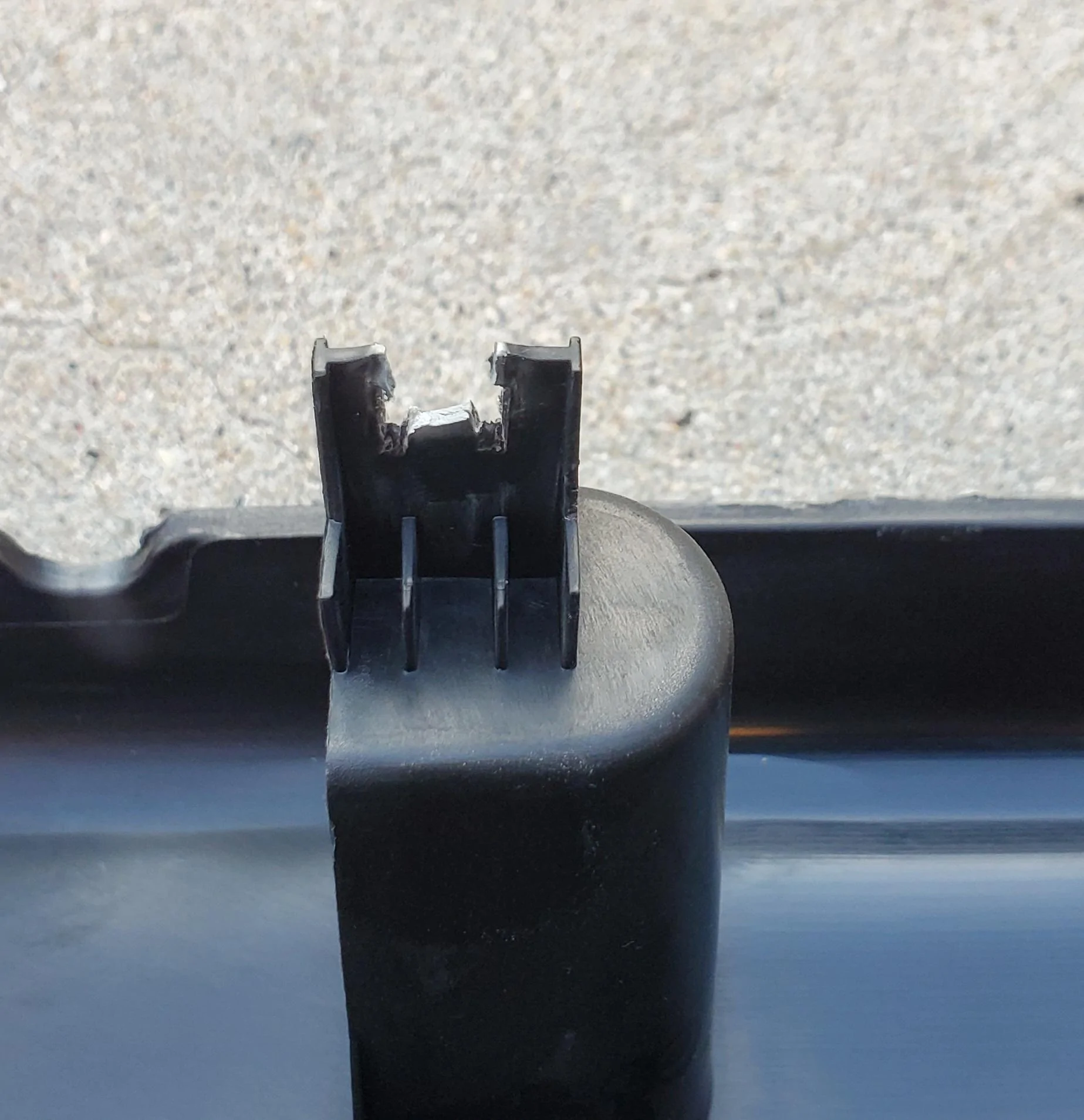

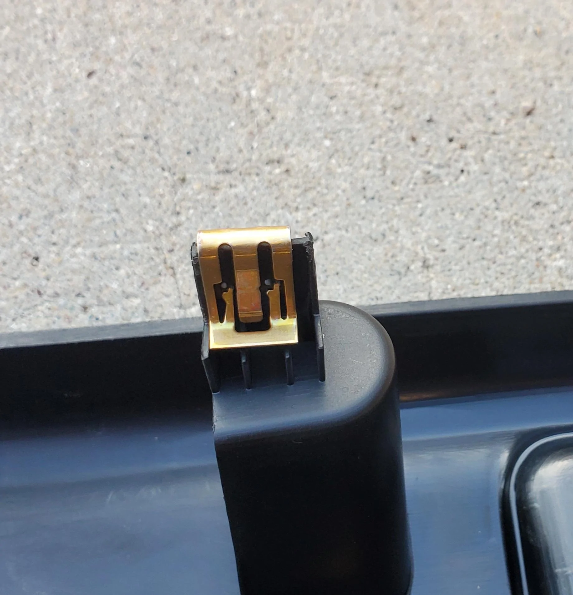

Here's how they generally broke for me:
Jeep Gladiator Rear Trim Removal 20220329_181844
Thanks for the pics. Does the body meet at top of the fins pictured? Looks like it would be tough to slip something in from this side. Does the other side have better access?
