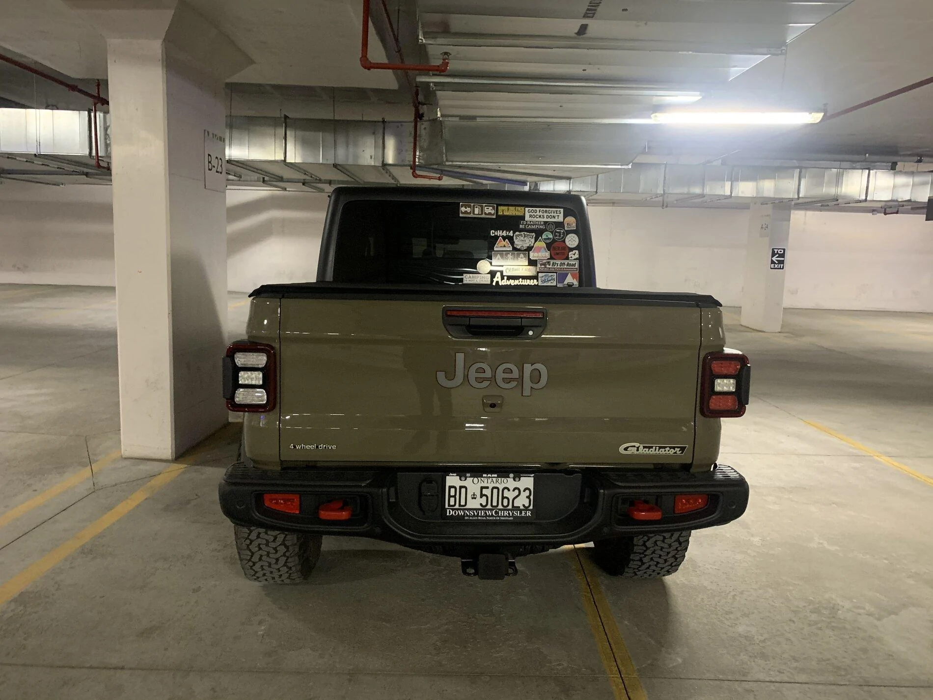

The only way to do this is swap over to the export tail lights and then rewire the truck and reprogram the BCM to convert to export tail lights. The export taillights have the Amber turn signals.
I have swapped over to them but I don’t have the ambers wired up. There are a couple of us that are doing this project right now.
Link is below
https://www.jeepgladiatorforum.com/forum/threads/export-tail-lights-on-na-spec-gladiator.31651/

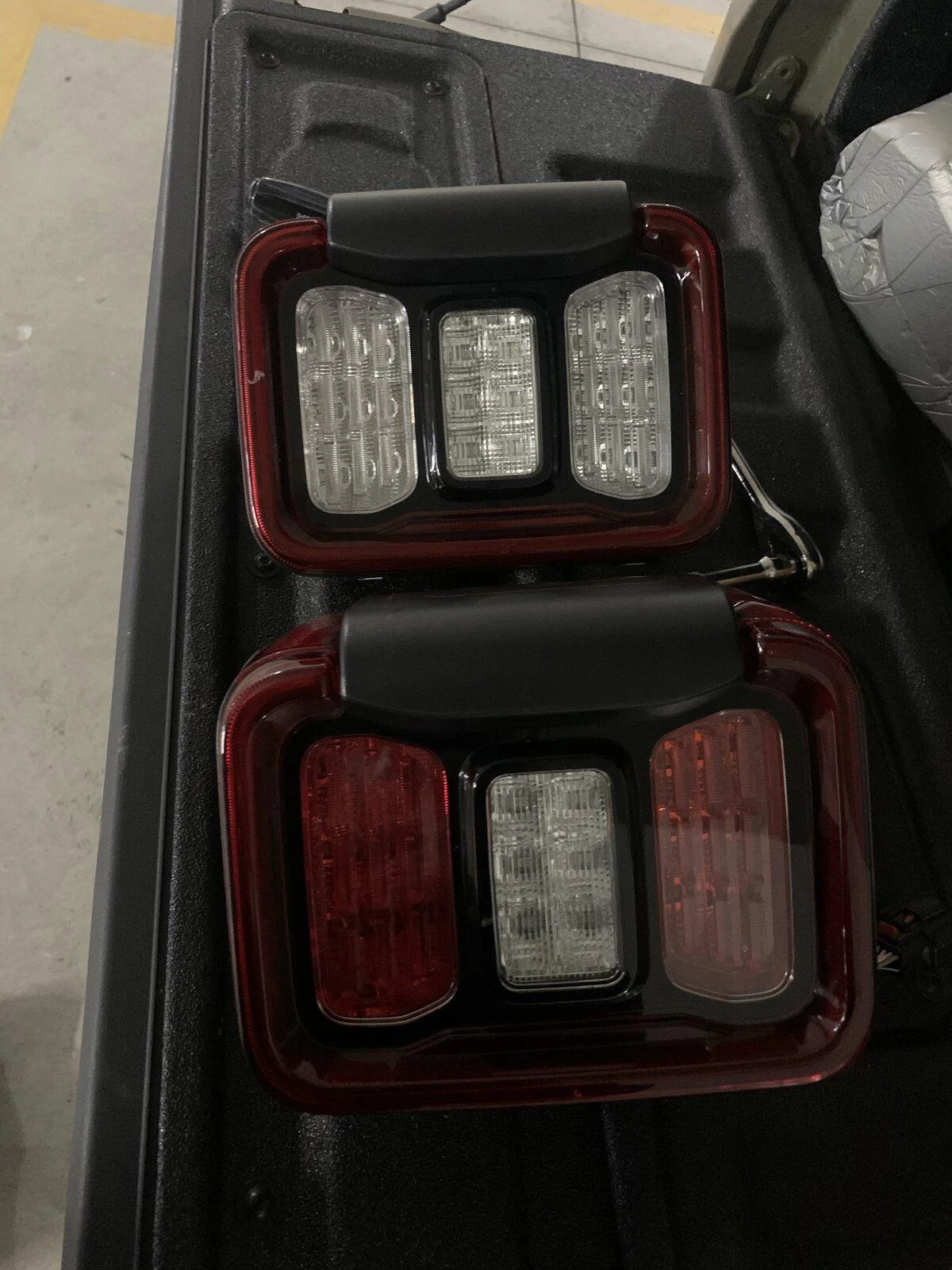

Got the answer. The taillights that come with the safety package are full LED and are sealed so there is no option to chance their insides. Bummer.
