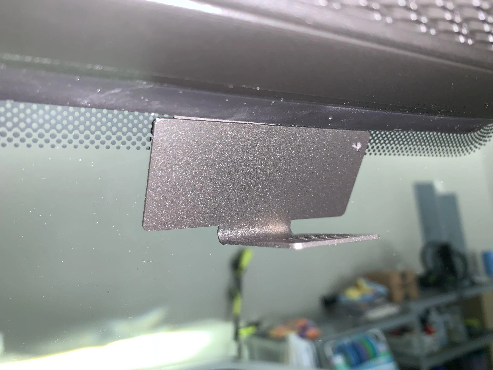

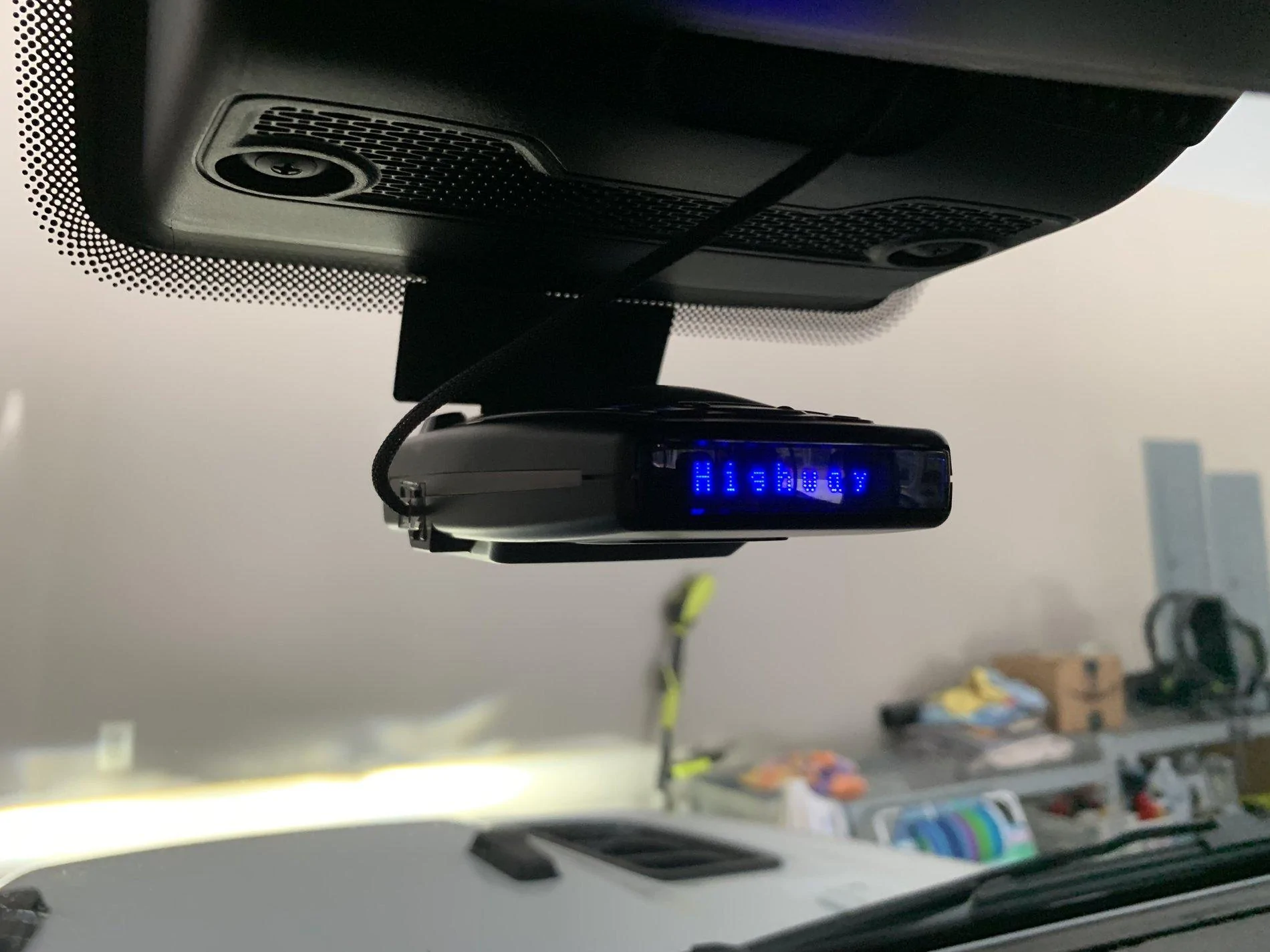

I finally got around to this and finished over the weekend. Spliced the electrical into the pink/green wire for positive and black for negative. A blendmount unfortunately will not fit the Gladiators incompatible plastic mirror neck, so I bought a 3M VHB Escort Windshield Mount Bracket off of Amazon (see link below). It came with grey 3M tape. I swapped grey tape with black 3M VHB tape so it matched everything else black color wise on the windshield. The mount seems to be holding fine and strong on the windshield. Would have rather used a mirror mount, but couldn’t find anything compatible that would fit the Gladiators thick plastic mirror neck or offer enough room to adjust the mirror once installed. Time will tell, but so far the windshield 3M mount is working fine.
Anyway, project complete and moving on to the next mod. Hope this help anyone trying to mount a radar detector on the Gladiator.
Semi-Permanent Escort Car Windshield Mount Bracket for The Beltronics & Escort Rad... https://www.amazon.com/dp/B07JGGVZGB/ref=cm_sw_r_sms_c_api_i_HnsiDbFBSRVT9

I already had a mirror tap from a previous car and didn’t want to buy another one. I used the below similar mirrortap. This was a 15” and probably could even have taken a 20”. I couldn’t get the tap prongs to connect though the mirror connector plug for some reason. Never had that problem before on other vehicles, but the prongs were either too tight, wrong ones or not deep enough for the connection. So I went old school and just spliced them in by hardwiring and used standard electrical tape to wrap. Then added a tie wrap around the mirror neck & wire in case the mount does fail at some point. Don’t want it pulling out with a dangling detector.
MirrorTap, MT-4015, 15" Radar Detector Power Cord with 2AMP Inline Fuse, BMW Tap S... https://www.amazon.com/dp/B00OQQWHLO/ref=cm_sw_r_sms_c_api_i_XvtiDb71JPVW8
This mount below comes with black VHB tape and blends in better visually IMO. I swapped it out from my original purchased mount and would recommend it at this time. It’s been holding fine in the heat so far.
New Escort Permanent Windshield Mount for The Beltronics/Escort Radar Detector https://www.amazon.com/dp/B01ATTRLJE/ref=cm_sw_r_sms_c_api_i_-pDmDb9WJ88D1
