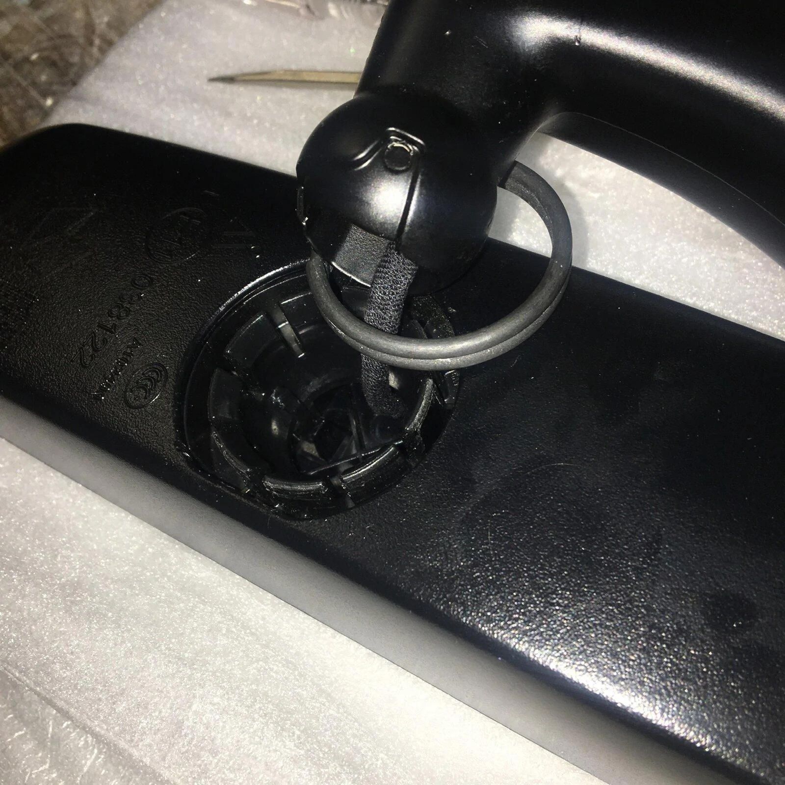

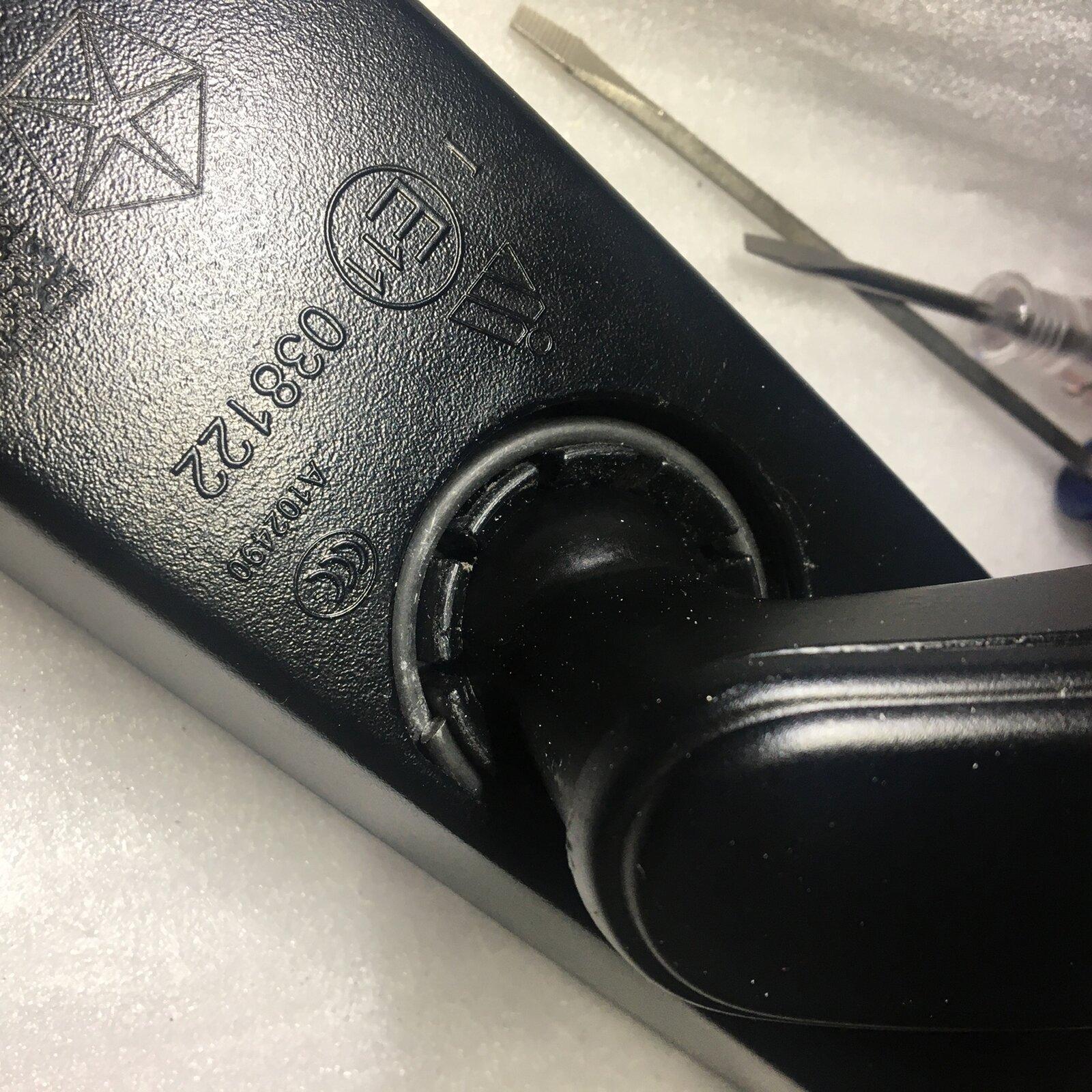

There is a spring clip in the mirror that you can pop out with a small screwdriver. Twist off the shift so you can work on it from a bench.

I don’t blame you. I was reluctant to pop it on while the post was still installed as well. It just felt more secure with the mirror face down on a protective cloth. Getting the post off is also more difficult than you would expect. It just takes a slight twist, but again, not knowing it is a metal post makes you leary to put too much pressure on it.
