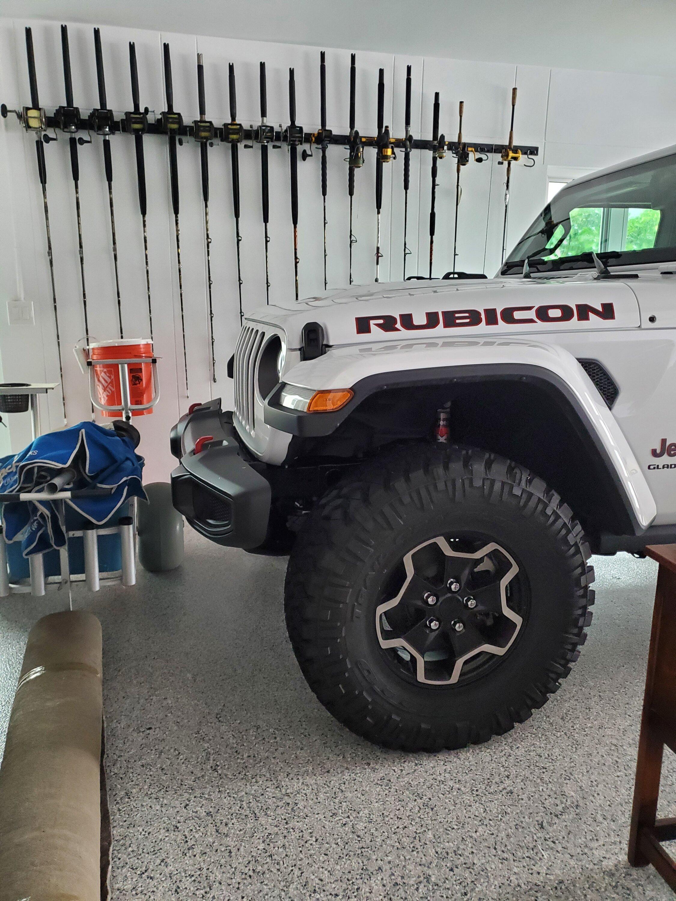

My Rubi with a build date of August 22 has the silver 🦊. It’s a little odd if they stopped using them since the jeep site makes prominent reference to the brand of shocks on the Rubi and Mojave.
