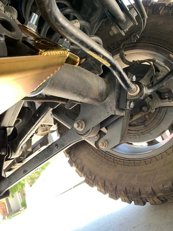

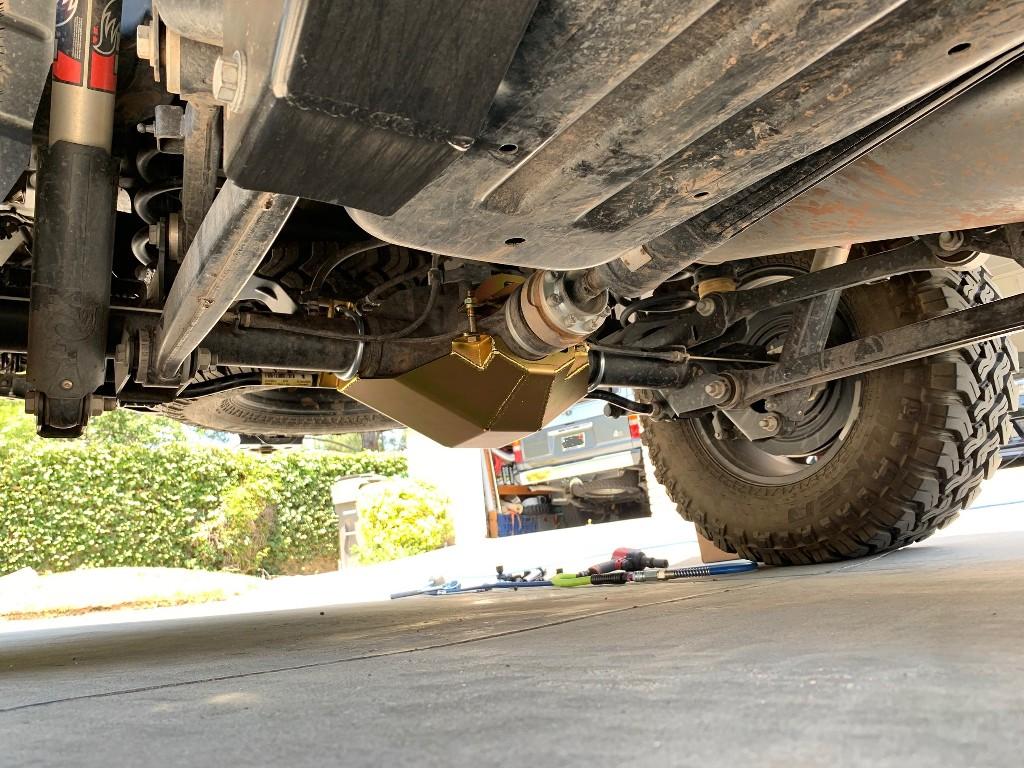

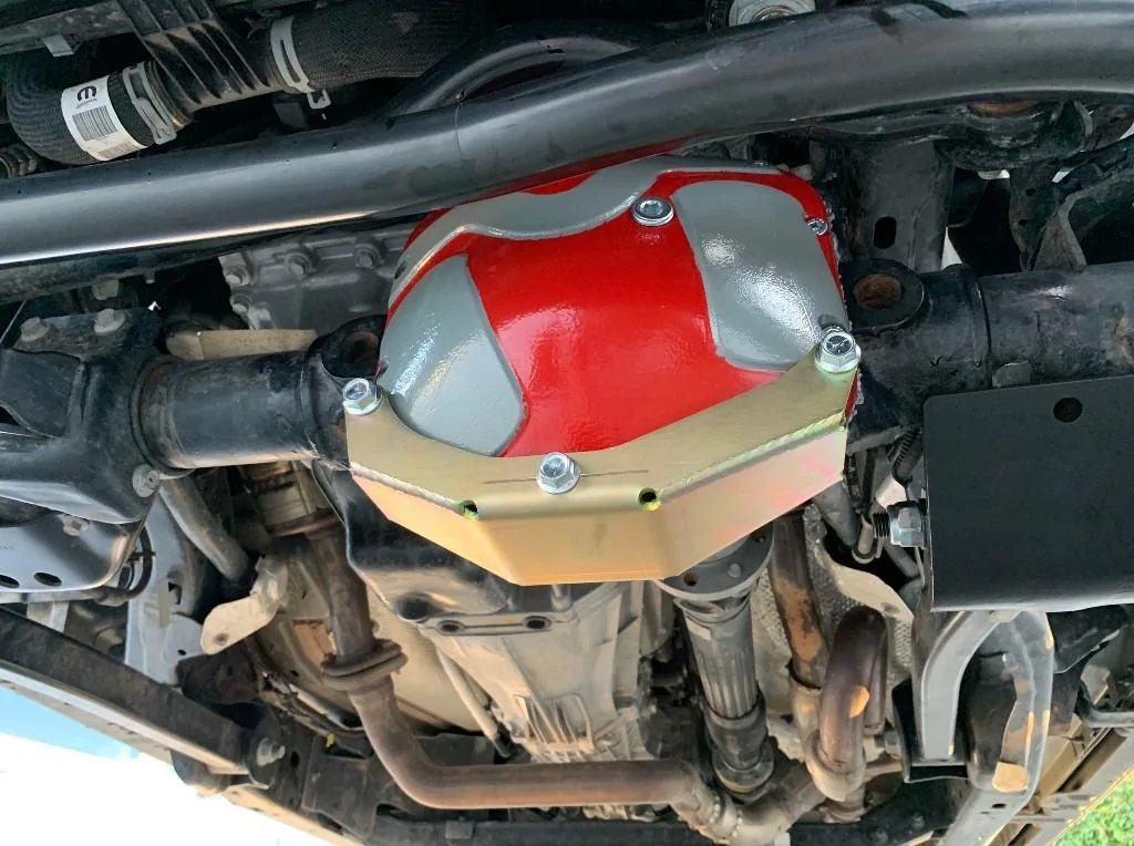

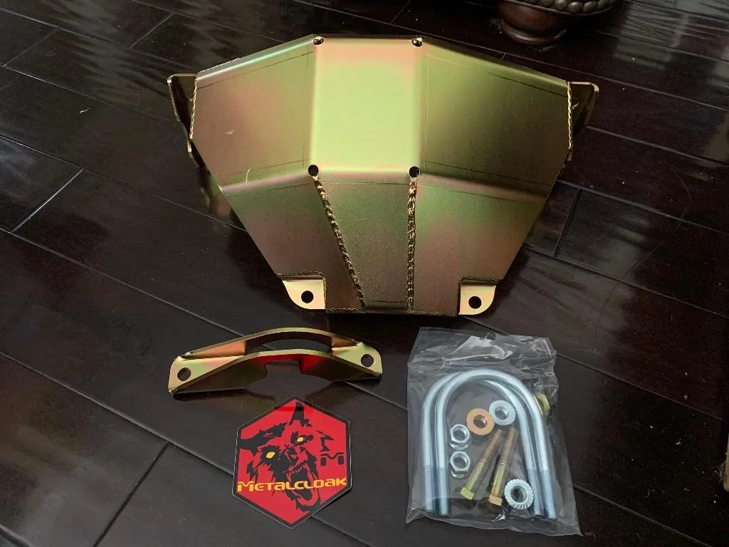

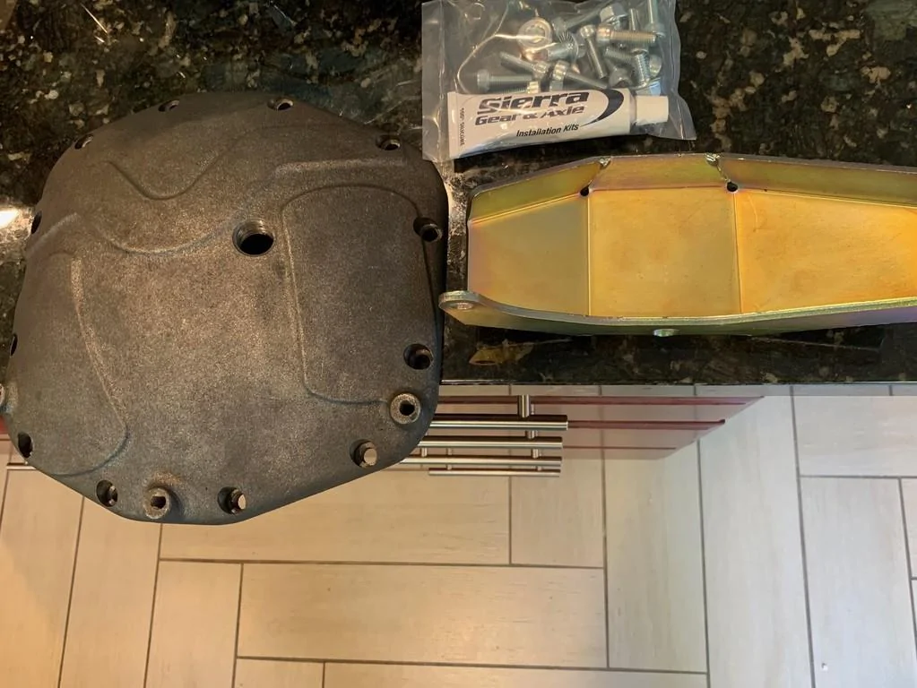

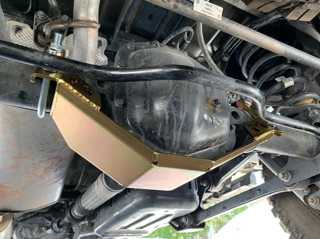

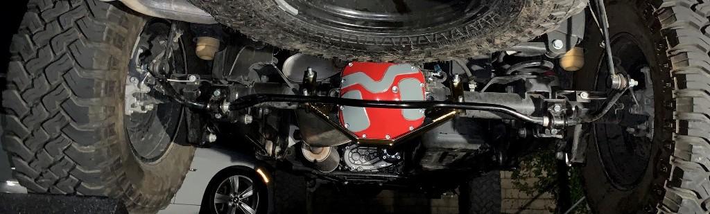

I like Metalcloak for the diff covers and skids. The rear skid is good with any cover. The front skid, you must use a metalcloak cover. here are some pics:

Did you have any issues with the track bar?
I had been looking at getting the front and rear set from Metalcloak, but their website says that the front one does not work with the OEM front track bar. That combined with having to replace the cover, drain and fill, etc has me leaning towards the Rancho front diff skid instead.

I used just the silicone sealant to mount the MC diff cover. The rubber gasket is too thick with the stock track bar. I never had any problem, but, when I installed my lift kit, I did see a small mark from the track bar on the MC Diff that I had never seen before. It was not enough to take the powder coating off the diff., but, it did make a smudge. I had it on my JTR with the stock suspension for almost a year, so, I was surprised to see that.. Lots of wheeling, but, I guess it did touch at one time...
Ride on, appreciate you getting back to me. I do have a lift on my JT already, since you installed the lift does it clear it now? Might be a non-issue for me.

MC put RTV in the box with the front diff cover, I was pleasantly surprised instead of irritated I'd already bought a new tube of Permatex.

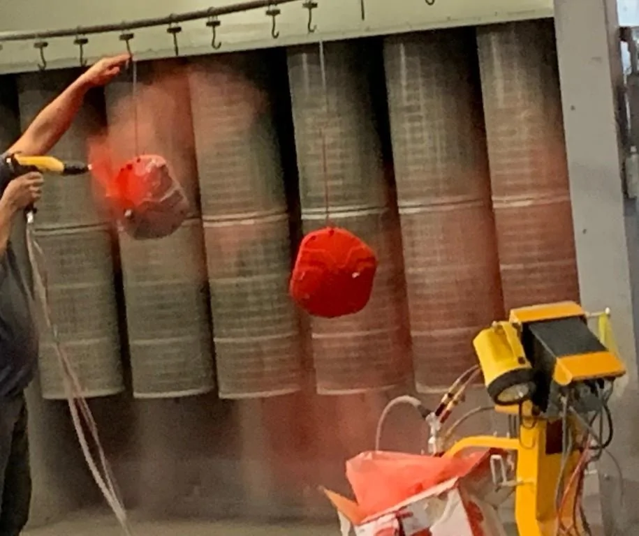

Prismatic Brentwood Orange, the closest match to the Mojave orange I could find. If they came from the factory black rather than red, I would not worry with it.
Yea due to the Mojave accents being orange you almost have to paint them. I have sting grey so the red will be fine.
