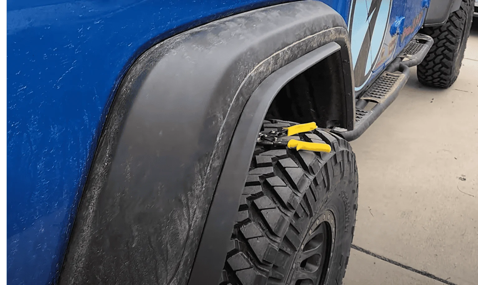

I did a search, but didn't see anything specific to the max tow fender flares with the extra lip that is on those flares. Does anybody know if the Recon extreme fender extensions / spats fit these flares?
I know you have to order 2 front lefts and 2 front rights and make a series of relief cuts in the extensions for them for form correctly for the rears, but wasn't sure these fit with the added max tow fender lips
They probably don't and would only allow maybe 1' or 1 1/4' extra coverage over the max tow lips since they are 3/4" or so to begin with, but thought I'd ask anyways.
Pic is courtesy of Jendall Overland who did it the mod on his Rubicon

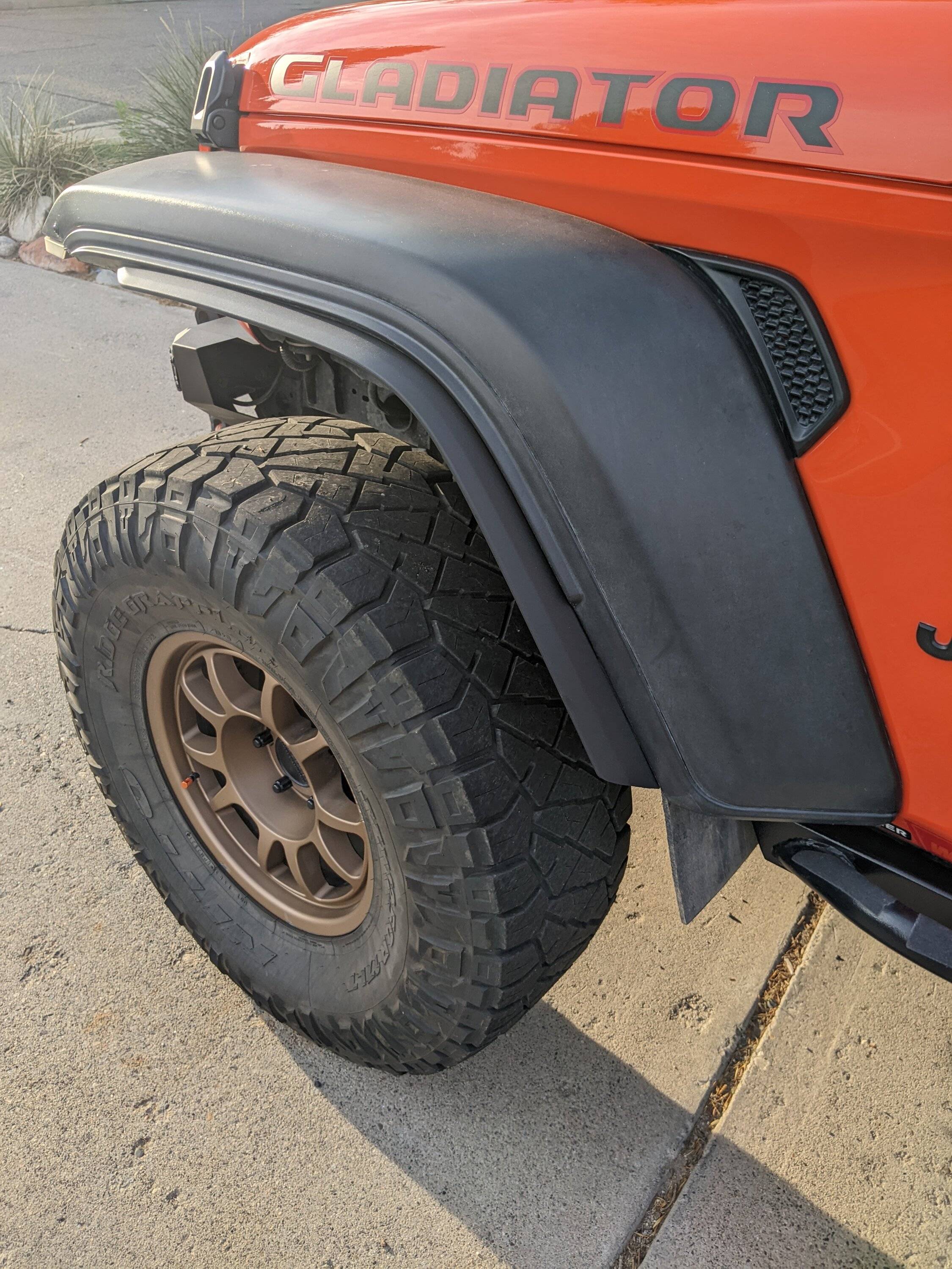

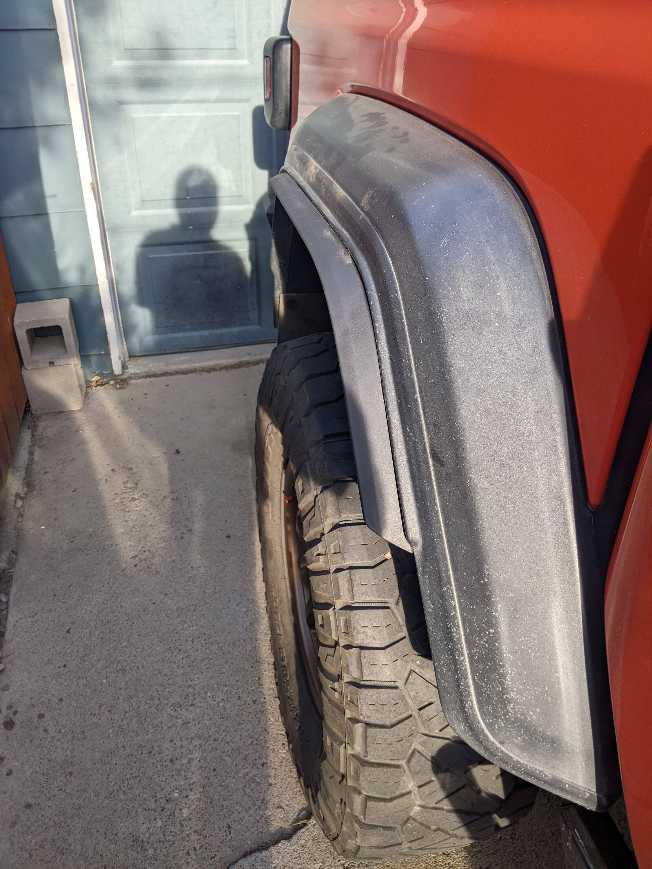

I used them on the max tow fenders...

Dang. That looks fantastic. Well done!!!!
Did you cut the relief cuts in the rear to make them fit without bowing? Any pics of where you cut them if you did?
Did you use Christmas tree's or the rivets to install them into the factory flares?

Which mud flaps are you using as well? Did you put them on the rear too?
THanks

I actually used sheet metal screws.... into the factory holes. I only had to cut the rear just about a 3/4 inch triangle in one spot. Just on one leading edge of the fender. They do look like they are factory fit. As far as mud flaps go... I made my own our of a high density rubber flooring scrap. They have held up well... but I don't have pictures of them exactly... I will take some later and post it.

Thanks for the info. Gonna order them up I think. Do you remember which size sheetmetal screw you used. No biggie if you don't
Thanks for your help. Really like the way they turned out on your truck.
