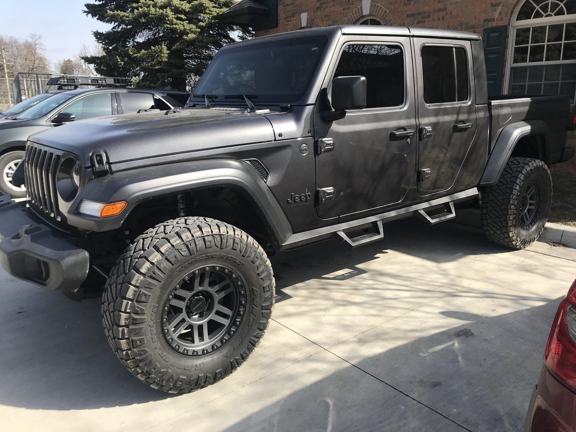

Hey I’ve got a 6speed Sport s on 35 nitro ridge grapplers and my 6th gear is pretty mud useless. I want to upgrade my gears from 3.73 to either 4.56 or 4.88. I don’t plan on ever going over. 37 I’m tire. Curious what gearing you think is best and what the pricing for installation should be. Thanks y’all!
