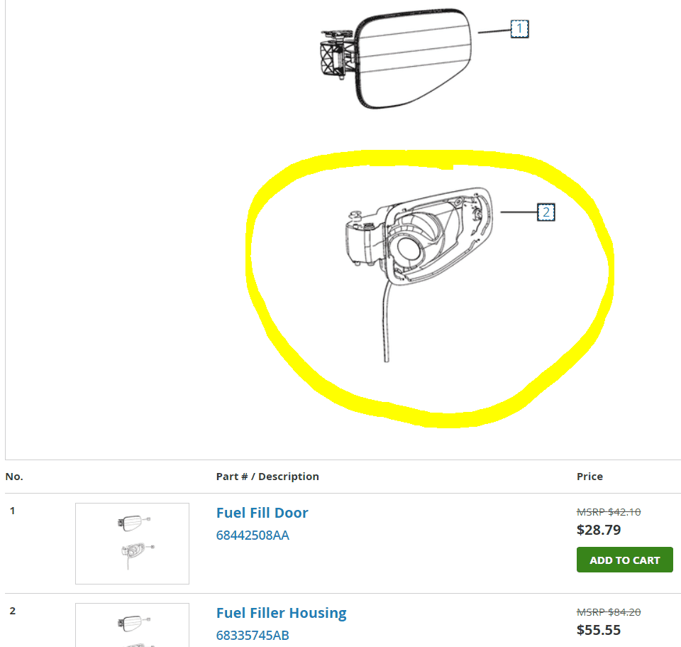

I'm trying to figure out how to remove the "Fuel Filler Housing" on my Gladiator - it's Item #2 in the sketch below.
Has anyone removed this piece or does anyone have instructions from the FSM that they can share?
Background: I'm preparing to have the typical body distortion around the fuel door taken care of by my PDR guy. I think removing this piece will provide open access to this area.

In case anyone needs the info, a buddy of mine at my local dealership helped me out.
You need to:
1) Remove filler cap & disconnect tether
2) Remove the rear inner splash shield
3) From inside wheelhouse, release 4 retaining clips - rear first, then the front
4) Carefully remove housing
5) Unplug wiring harness connector
