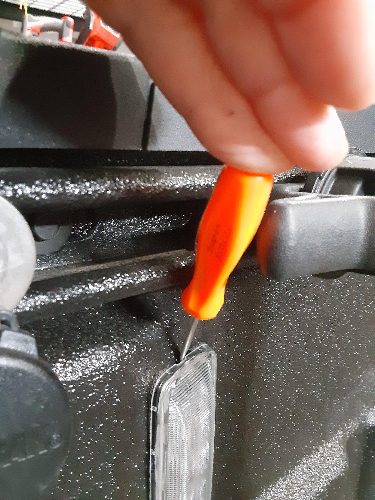

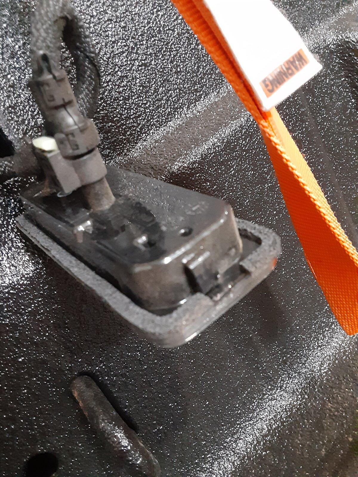

May be a too late for the OP.
There is a cut out on the light, use a small flat blade screwdriver to push the tab to release, then turn the screwdriver a little and gently to remove.
Jeep Gladiator Removing the bed lights? 20210423_112329
Jeep Gladiator Removing the bed lights? 20210423_112243
