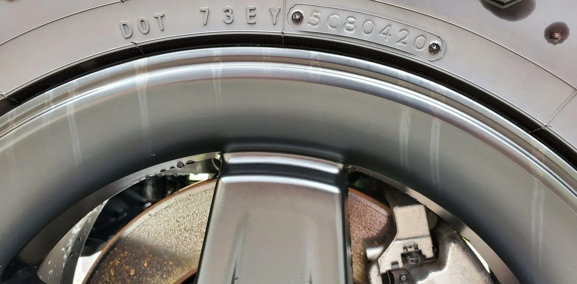

Does anyone have a trick for removing "stains" from a matte black wheel? I have AEV Pintlers and used a single, light coating of 303 tire balm (says safe for ALL wheel finishes...) and have bad lines/drip marks in the finish after a rainstorm. The tire balm has been on there for a few weeks, so I'm a bit shocked. It's definitely stained as I tried to wash them off with soap and water to no avail. Anyone have any products they've used with success for issues like this? In the below picture, the wheel is dry...

Try Dawn. Specifically that brand. I run a industrial coatings plant, and when all else fails, Dawn is your best bet without knowing the specific coating on the wheel.
Lather it up real nice and let it sit for fifteen minutes, then rinse it off and wash again.
Another thing you can attempt is to actually take even more tire balm and rub it in to the wheel, using circular motion like a wax job. Sometimes the uncured chemical can soften up the cured runs. Then you can wipe the whole thing down with soapy water and pull it off.

Like mentioned dawn soap. I'd also try something like Adam's Wheel Cleaner. Just make sure your wheels are cool and out of direct sunlight.

Try drbeasleys. They have products for matte finishes.
