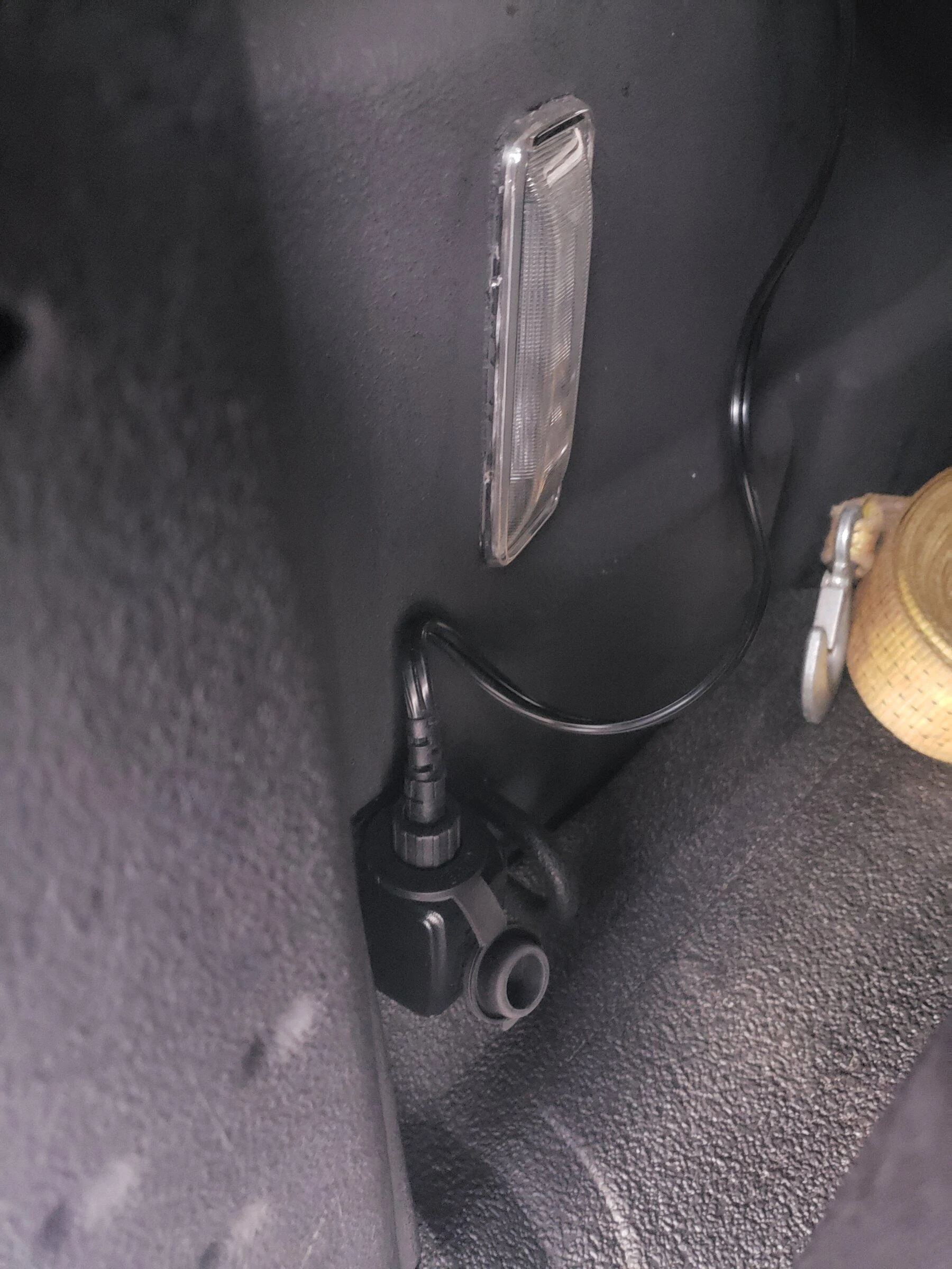

I ran a separate circuit for my 12v power outlet. I have it only powered when the ignition is on.
I am considering going with another battery to have power in the bed all of the time. I would isolate it from the vehicle's batteries for obvious reasons. I would then use the circuit that I installed to only charge the cargo battery. I haven't done this yet, mainly because I have not needed 12v but a few times. A simple power pack is all you need for that.
Jeep Gladiator Replaced 12v with brake controller.  Run 12v to the bed? 20211215_172921

I'm also considering something like this, installed where the optional 110 outlet would go on the bed. There's a plastic "plug" there now.
Kohree 12V Marine USB Outlet Socket Panel-Cigarette Lighter Socket Splitter & QC 3.0 Dual USB Ports with LED, Waterproof 12 Volt Charger Panel for Car Marine Vehicle Motorcycle ATV https://www.amazon.com/dp/B08D691JL7/ref=cm_sw_r_apan_i_XYZ42W0H887K0WKYRE8F?_encoding=UTF8&psc=1
I would swap one if the 2 with a rocker switch so I can control power here regardless of the ignition. There are also 3 and 4 gang options if more are desired
