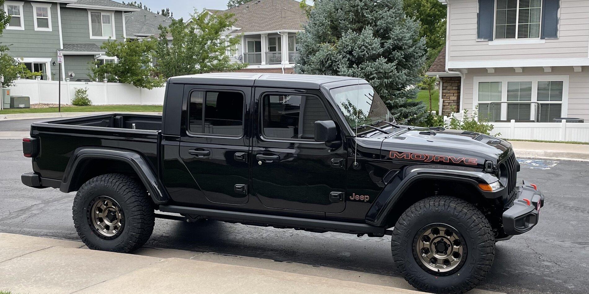

Just wondering if adjusting tire size with JScan made a difference when putting 35’s on a Mojave? Runs fine, drops into 8th on the highway…. The computer says 33.03 already and 35 inch tires often are 33.5-34 from what I’ve read and even measured…. The 35’s I have are really 33.5 under the weight of the truck. I have all the JScan parts but what a pain in the a to get into the bypass cables

. I have to hire a smurf I guess. Did JScan make a performance difference for the Mojave on 35’s?

So, did it make a performance diff? Speedo is a rounding issue, ha. I’m calling out Mojave because of stock 33s; computer says 33 when I’m reality they were probably 32… and the new tires are only .5 bigger. Thank you for the response!
