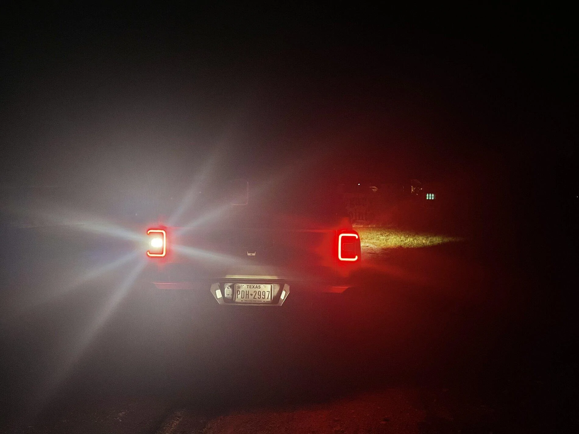

I noticed while driving the other night a bit of a white glow behind the Galdiator. I pulled over and noticed the driver side reverse light was still on, the passenger side was not (LED lighting group). I cycled through PRND and the single light remained on, however in reverse, the passenger light did not come on. It remained on for the 30 minute drive home.
I turn the Jeep off, restarted it and the driver reverse light turned off. Put it in Reverse and both lights turned on, back to Drive and both turned on.

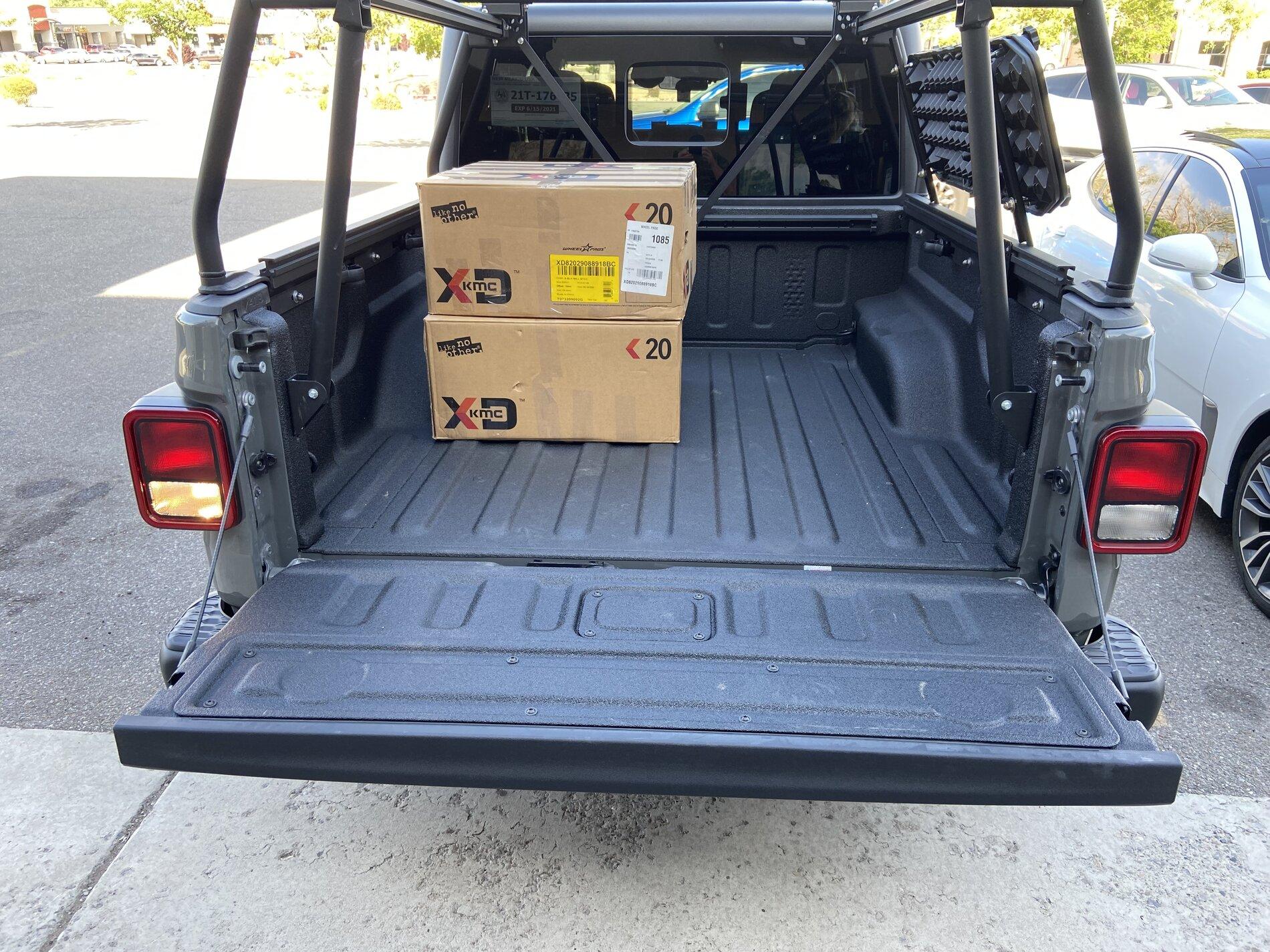

I noticed something similar with my Jeep while parked and off.

Happy to report, I’m just a dope. No gremlins here.
I forgot the latest Tazer firmware allows you to turn the bed lights and reverse lights on when you click unlock x5. Not sure why the passenger reverse light isn’t on, but at least I know why the driver light was on, and how to turn it off.
