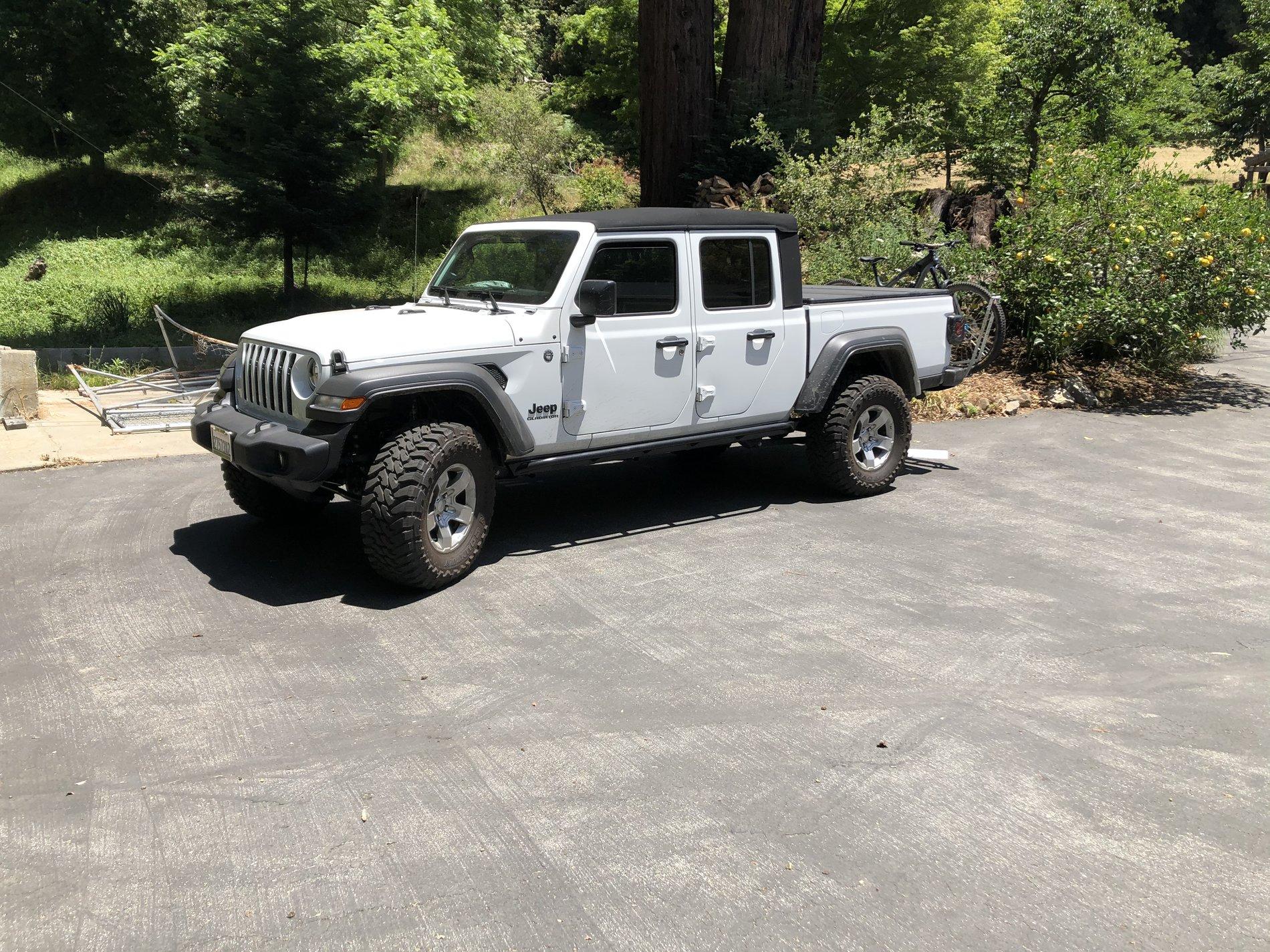

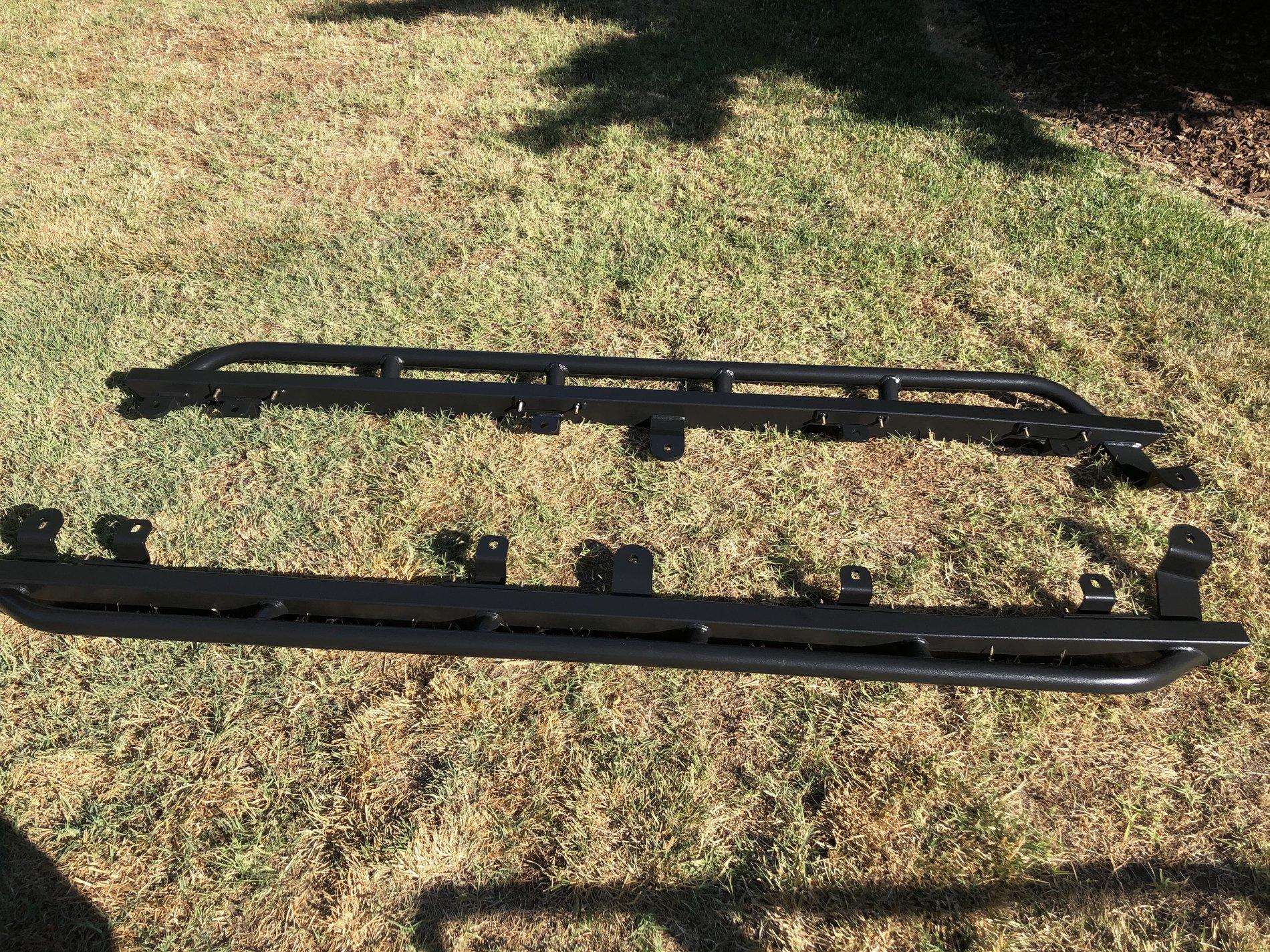

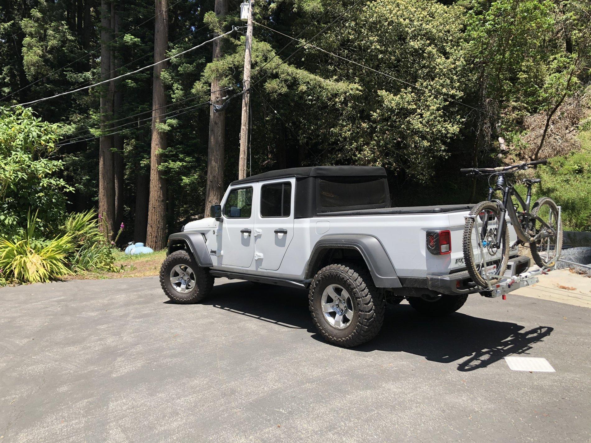

Installed rock hard 4x4 rails. Theses are angled up version. They fit great. I did have to drill out two holes.
The finish is textured a little but still glossy .

What size tires are you running? Looks great with rails!

I love the Rock Hard angled up sliders. Just added 1" wide Shur Tape anti-skid to the tops of the outer rails. Doesn't get in the way when entering or exiting, but gives a secure grip for standing on the rail.

Very nice, I plan on doing to straight out ones to use them as steps as well

@1herm4 : I have the Ace Engineering rock sliders on my JTR and really like them.
One difference between those and the Rock Hard rock sliders is that the Ace Engineering sliders fit over (under?) rubi rails while the Rock Hard sliders replace rubi rails.
(btw... I also just got the Rock Hard rock sliders for a stray 07 JK X that recently wandered into my driveway and stayed. So I agree that they look great on @Demo_slug 's JT)
My JTR had rubi rails, while the JT X doesn't. So the two products fit a slightly different requirement.
